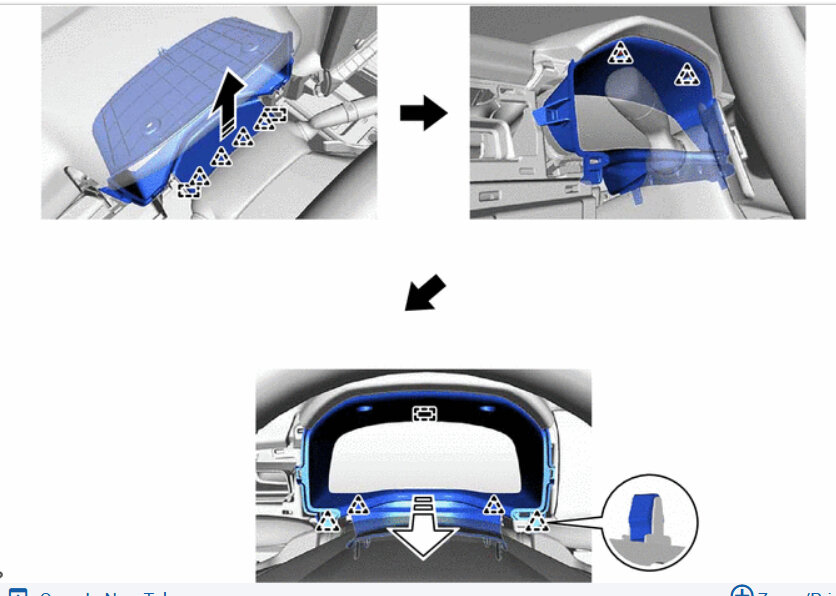

Cluster pin out diagram and cluster removal diagram?

Got some flickering and different indicators coming on and off when i hit a bumps.. want to test a few things.. got car from auction.

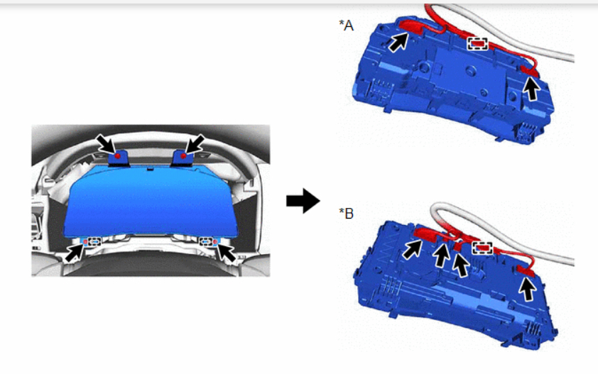

I would disconnect the battery and remove the cluster connector to check for corrosion, if found this car might have water damage. Here is how to remove the cluster to do the inspection. Check out the images (below). Let us know how it goes.
