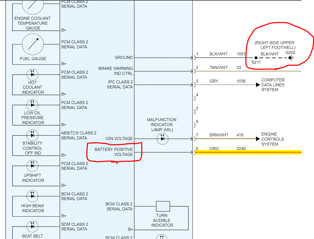

Works for 2 minutes then shuts down to 0 gauges, except the speed thermometer.
Mar 7, 2020 at 7:31 PM
  • 110,194 POSTS
Power is supplied via a fuse, so that is either good or bad. The other thing could be related to a weak ground. Now, interestingly, the same ground that works for the speedo is for the entire cluster as is the power supply.
I would suggest confirming there are no issues where the connector plugs into the rear of the cluster. If that is good, I have to assume (which I know isn't a great idea) the cluster itself is bad other wise you would lose the speedo as well.
I attached a pic below showing the ground and power supply to the cluster. If you determine the cluster is bad, here are the directions for replacement.

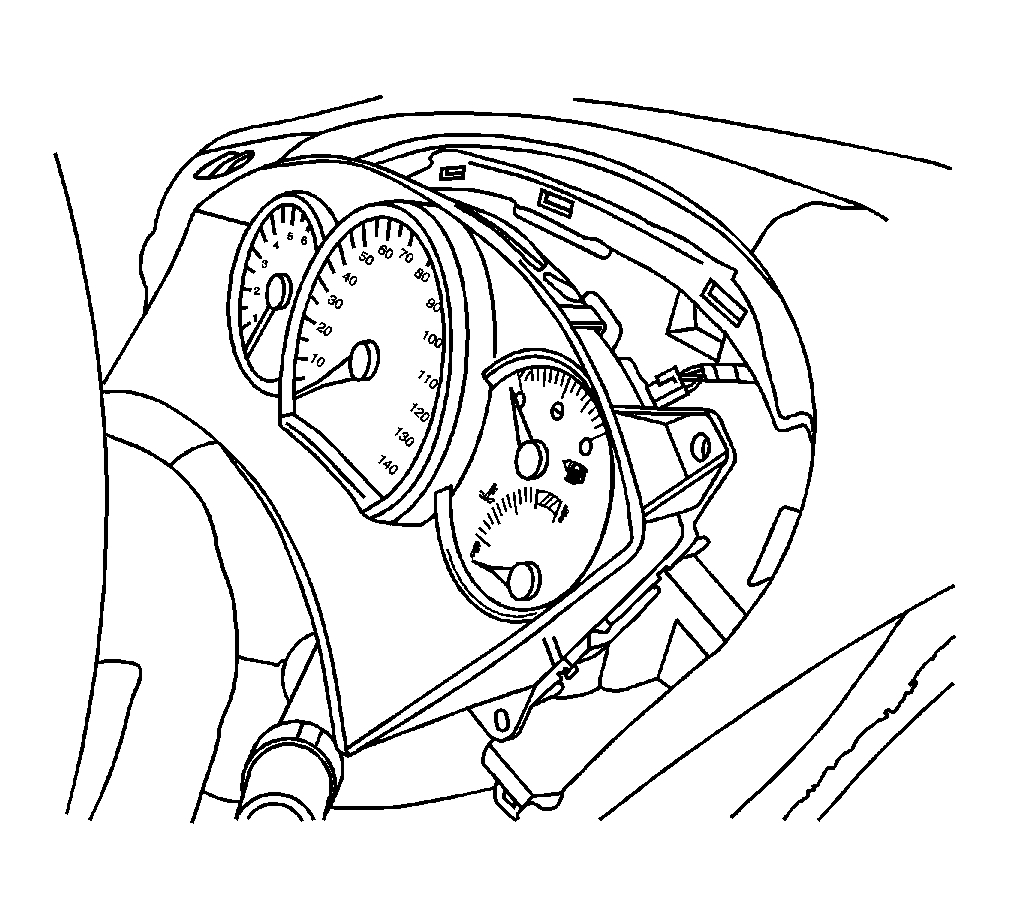

REMOVAL PROCEDURE
pic 2
1. Remove the instrument panel (I/P) cluster trim plate.
IMPORTANT: The ignition switch must be in the OFF position when removing the instrument cluster.
2. Remove the instrument cluster screws.
3. Pull the instrument cluster towards you and disconnect the electrical connector.
4. Remove the instrument cluster.
