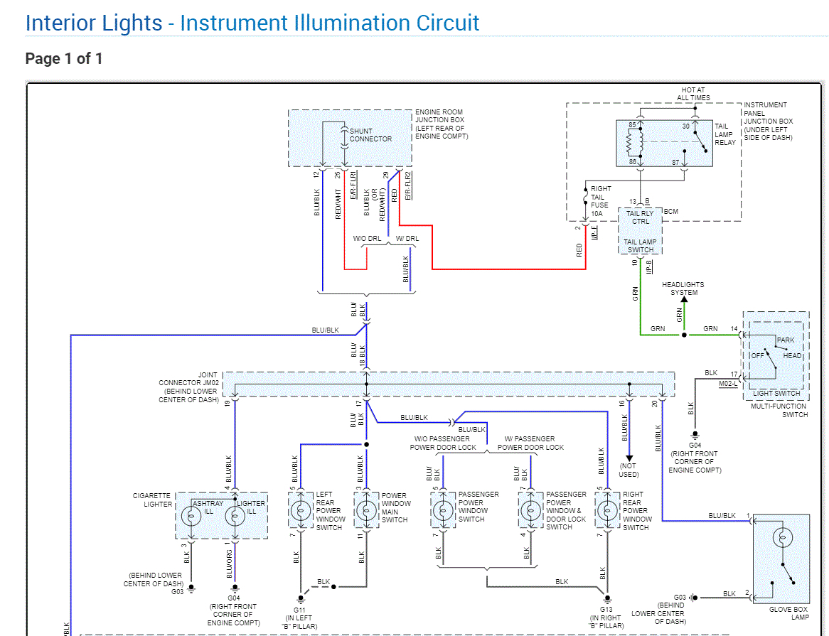

I need a wiring diagram for the dash lights, i want to check the cluster for voltage.
Apr 18, 2022 at 12:43 AM
  • 110,240 POSTS

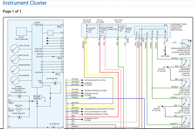

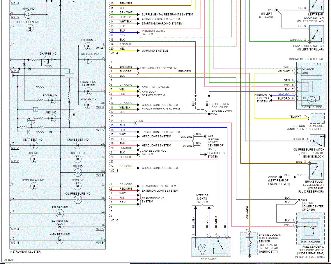

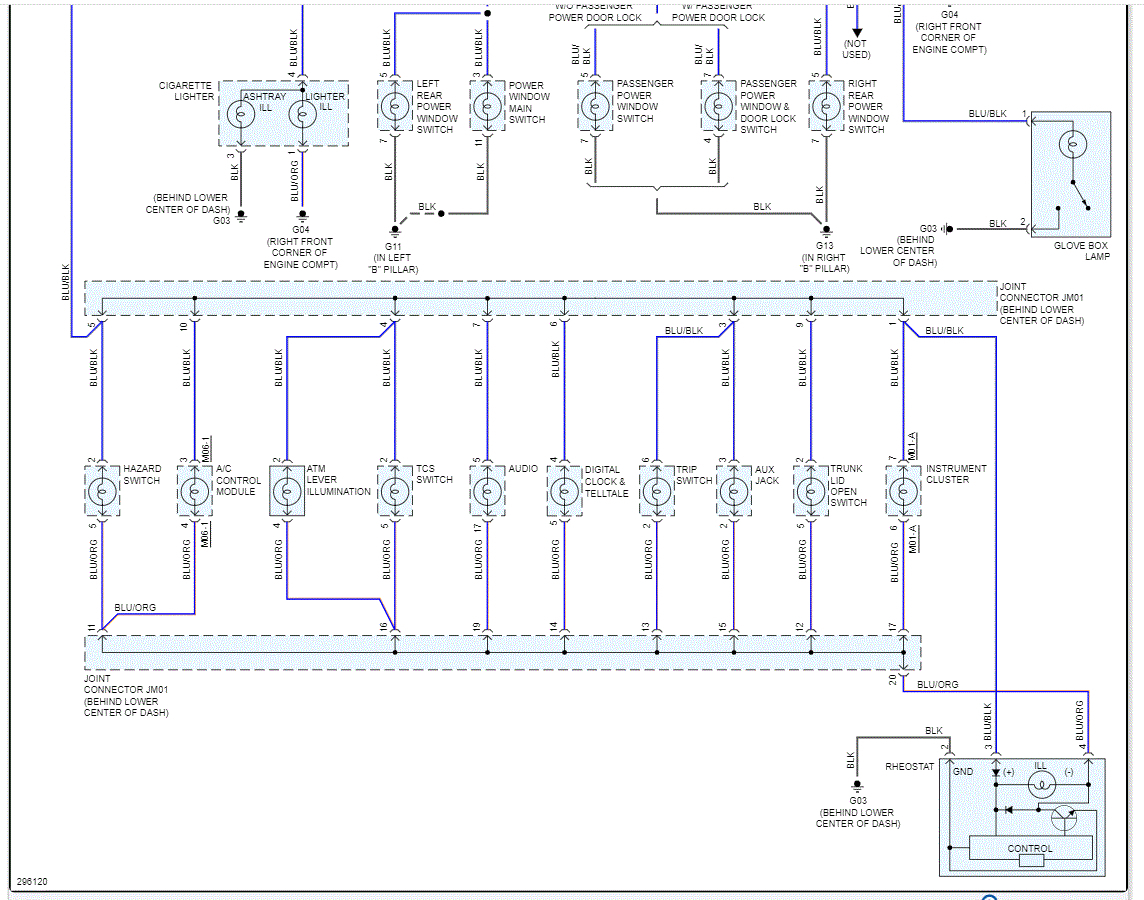

I wasn't sure exactly what you were looking for because cluster warning lights are listed differently than cluster lighting. So, I attached the schematics for both.
The first two pics are of the interior lighting which includes cluster lighting. Pics 3 and 4 are the circuits for the cluster itself, warning lights, gauges and so on.
Originally, these were one page each. I had to cut them in half to make them readable for you, but I did overlap them so you can follow from one to the next.
Let me know if this helps.
