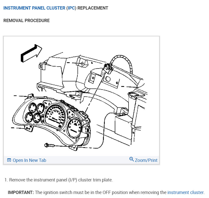

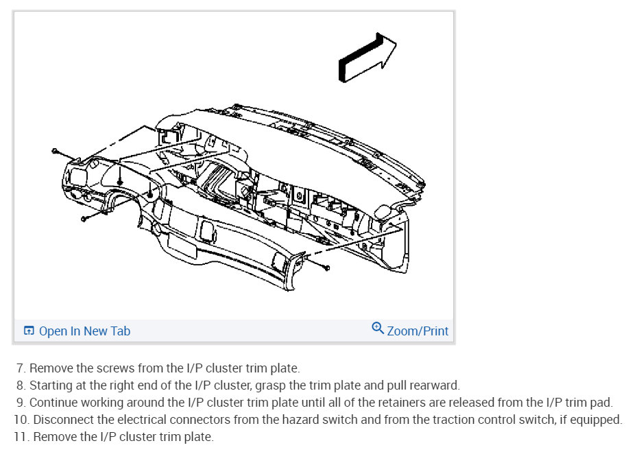

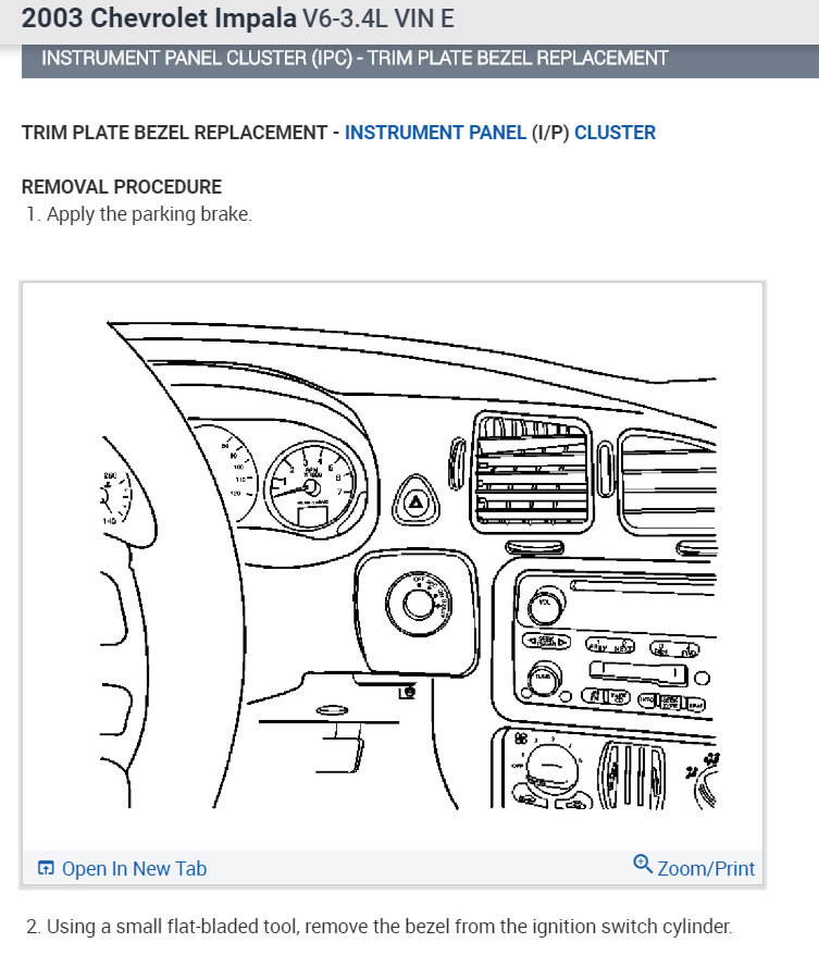

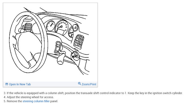

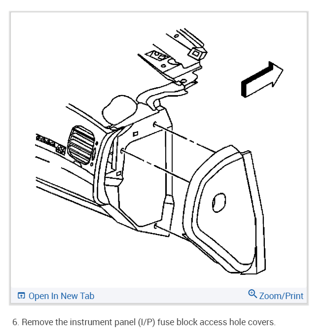

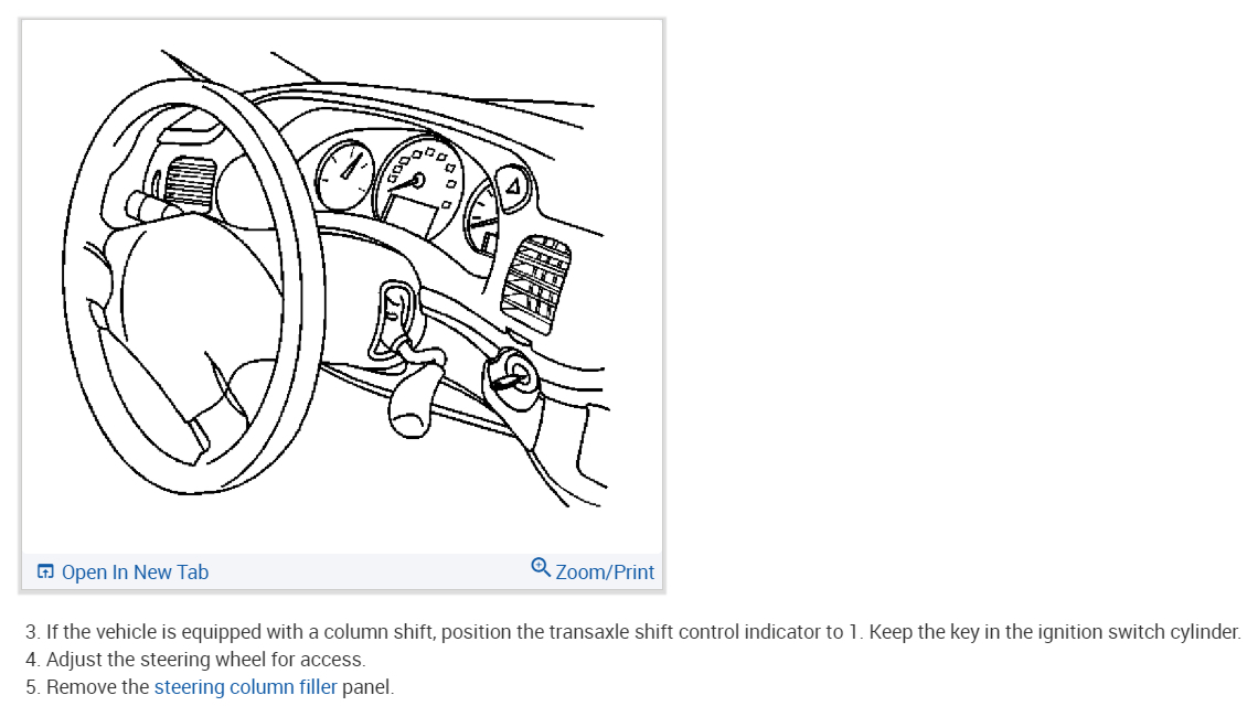

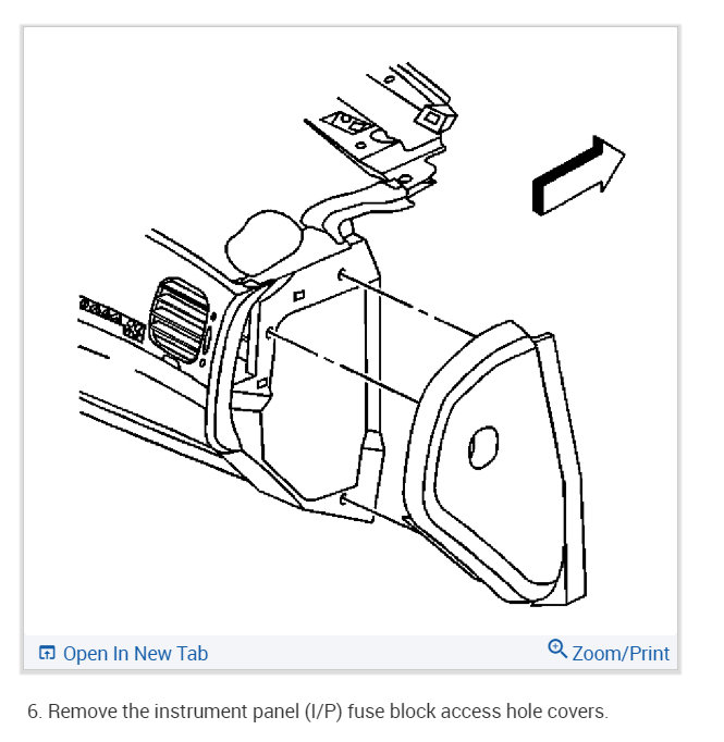

I just had my cluster upgraded cause I had lights out. Now some of the lights are going out again. Can something be causing this to happen? It's just one side of the cluster.
Aug 3, 2019 at 6:05 AM
  • 55,423 POSTS
Yes, some after market light bulbs are made cheaply and go out quickly, I would get AC Delco replacements. Here is how to do the job correctly. Check out the diagrams (below). Please let us know what happens.
