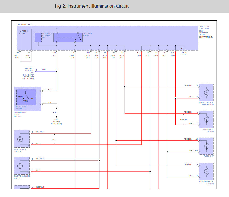

So, it sounds like the brightness adjustment for the cluster is all the way down. Can you check it please? The adjustment is part of the headlight switch. Please let me know.

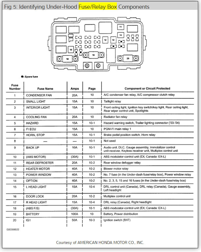

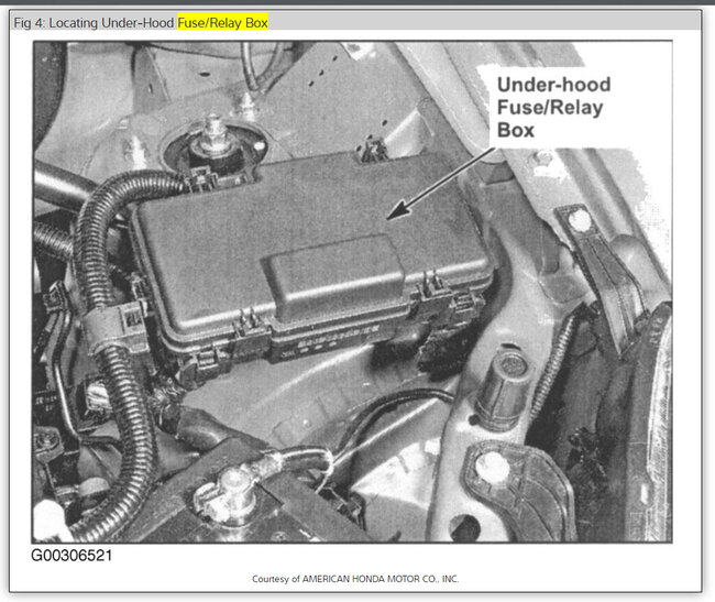

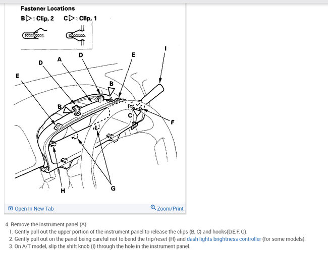

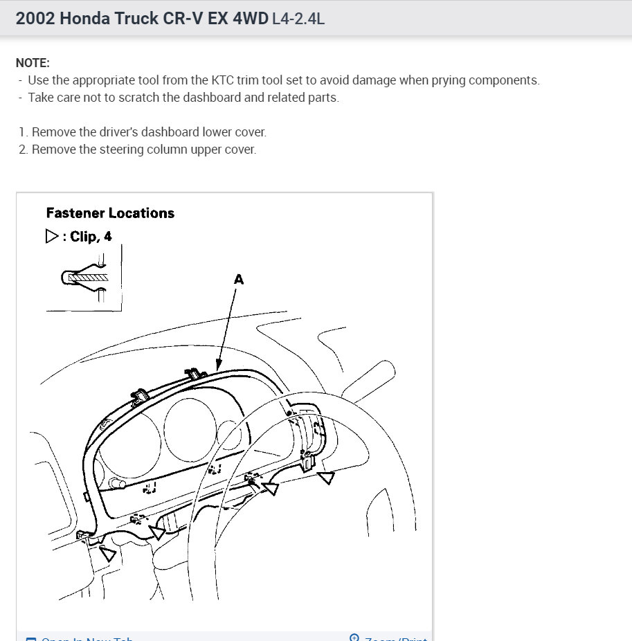

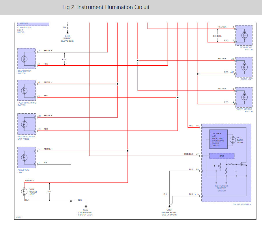

There is a CPU inside the instrument cluster that sounds like it is out, you can get a rebuilt cluster by searching google or eBay but I would check the fuse # 2 in the under hood fuse panel, here is a wiring diagram for the lighting system for the cluster in the images below and how to change out the cluster. Please let us know what you find.
