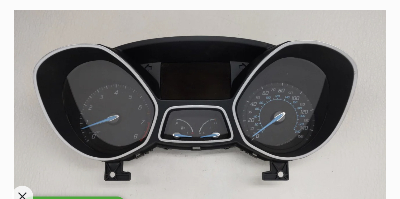

Cluster issue, no info can be read including miles?
2012 FORD FOCUS
1 MILES • 4 CYL • 2WD • AUTOMATIC
BHAMDOC1973
  • 2,007 POSTS

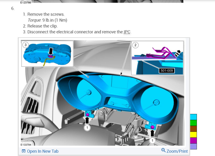

The picture is just an example of what it looks like, the middle black part on top does not light at all and, where do i start? Is it a common issue?
Jan 17, 2023 at 2:48 AM
  • 55,433 POSTS

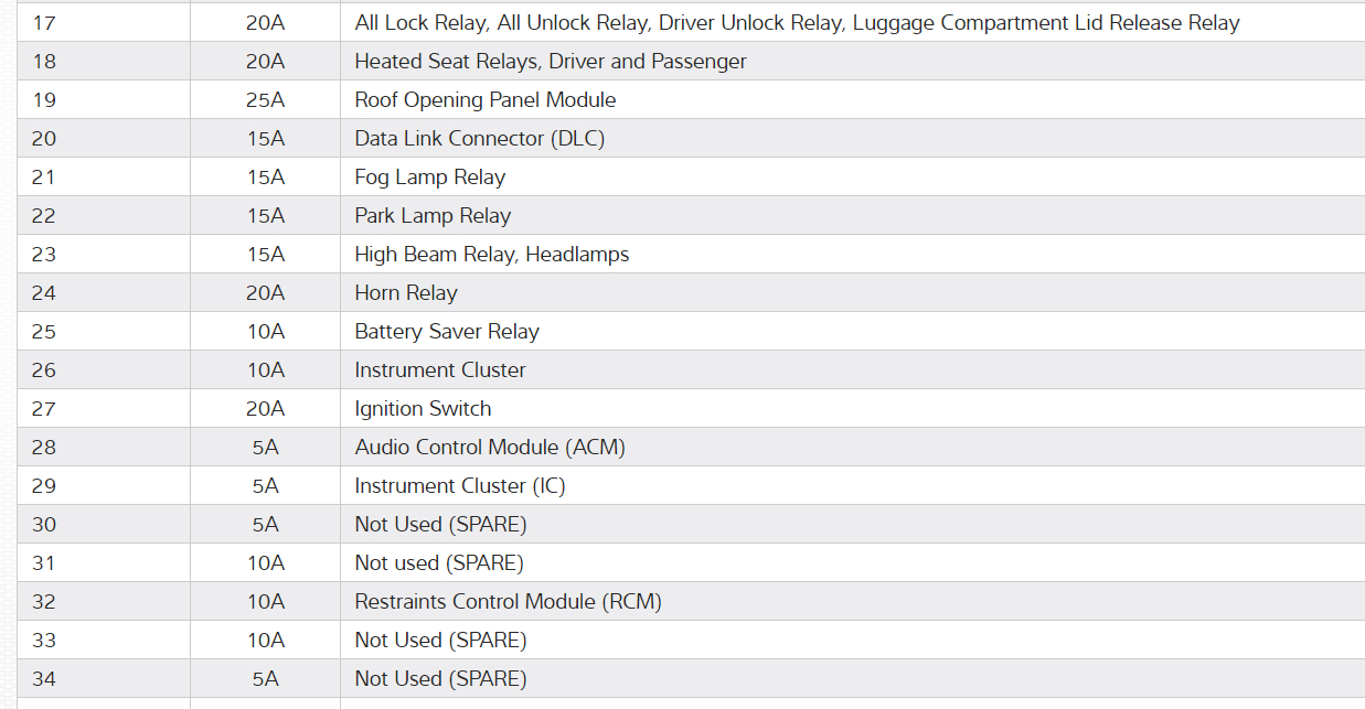

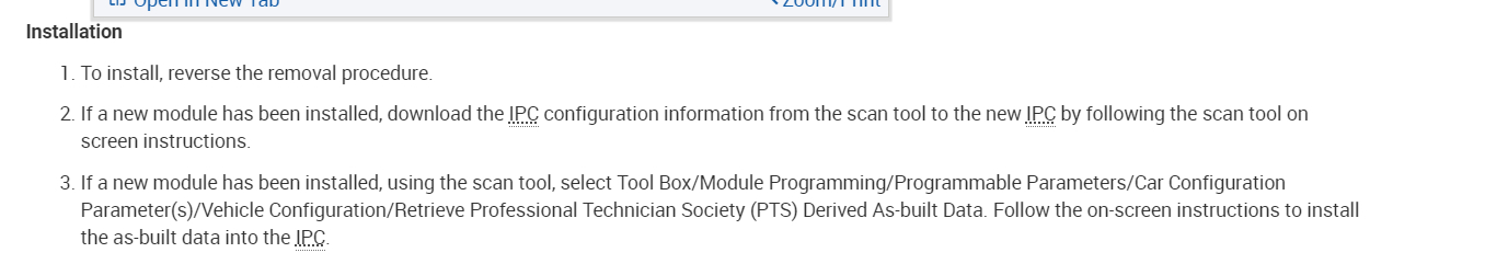

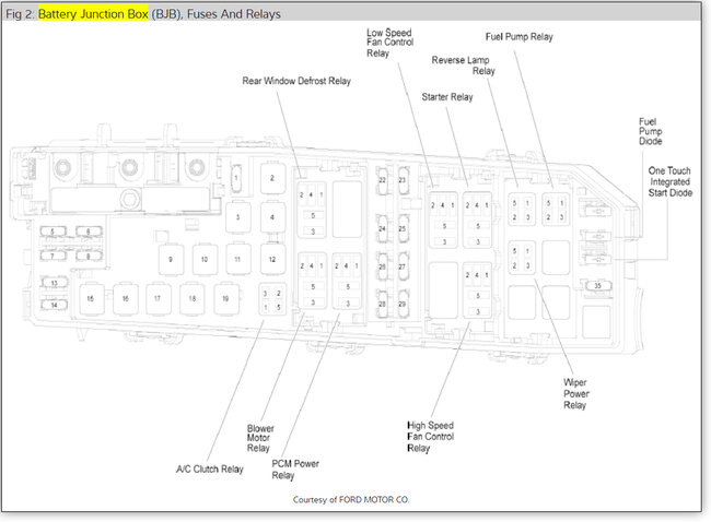

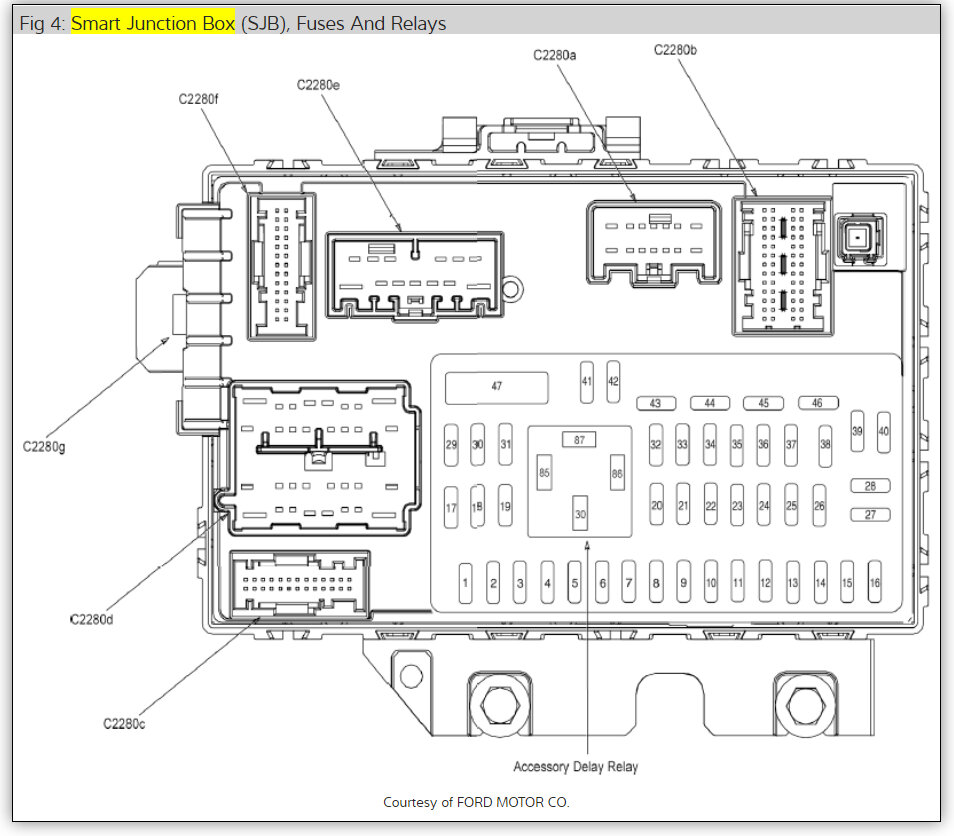

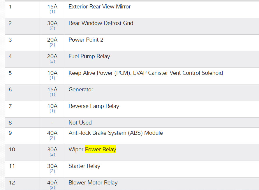

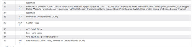

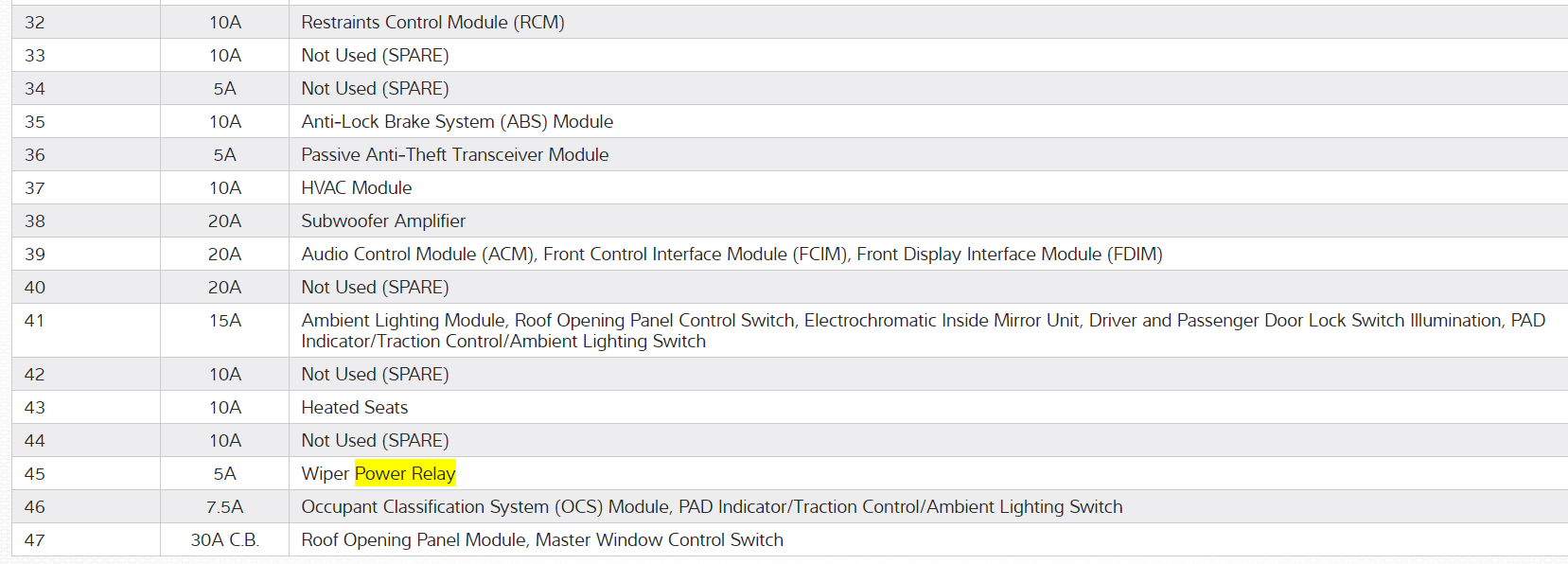

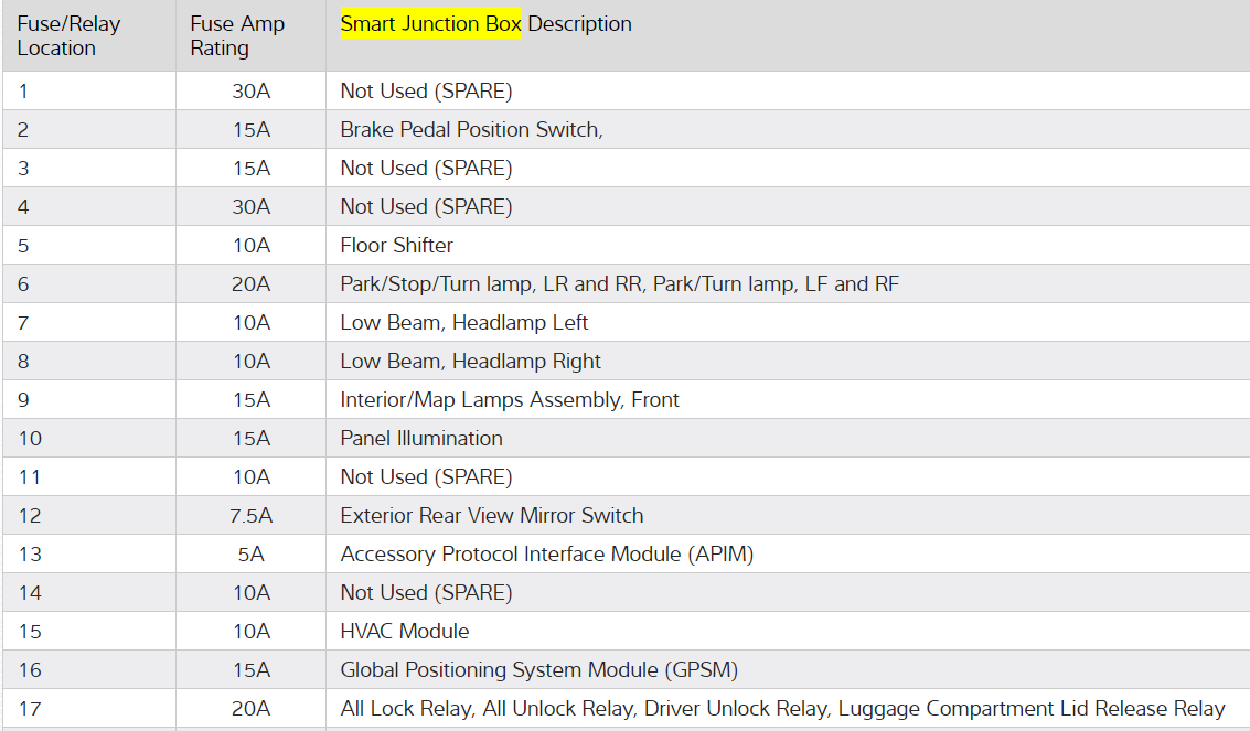

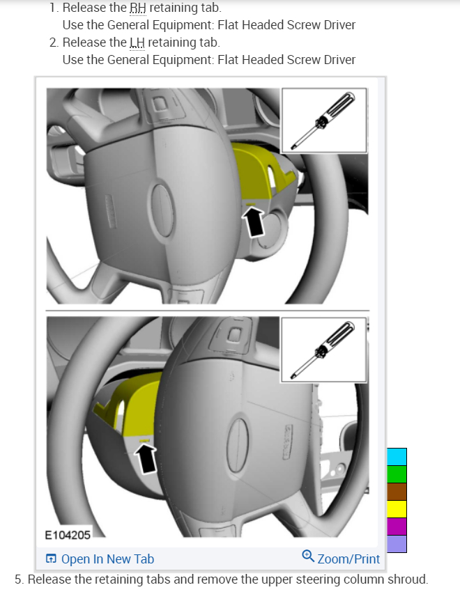

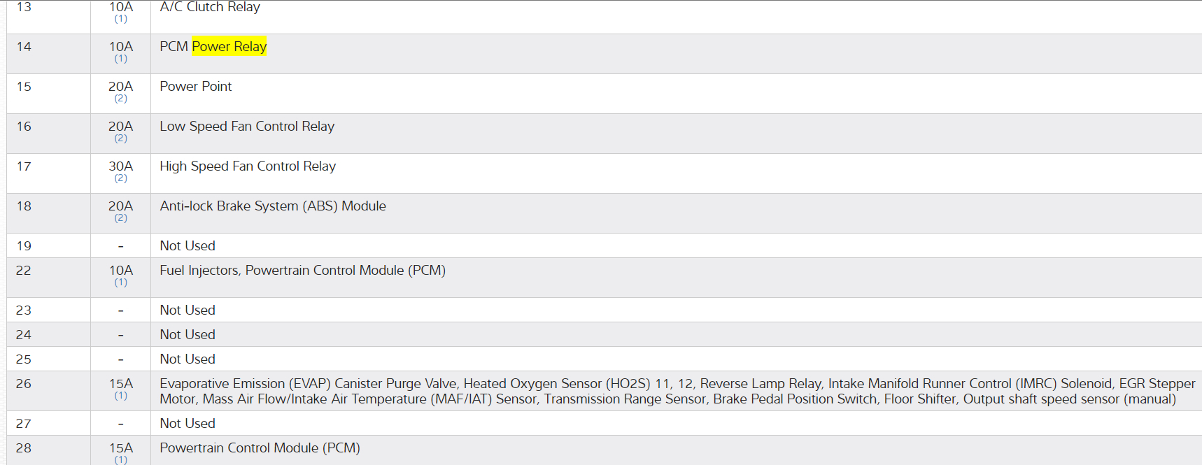

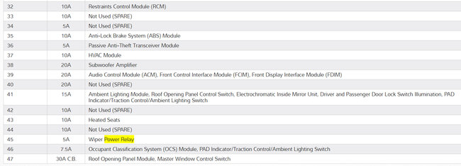

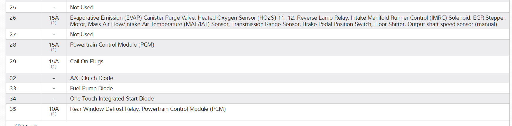

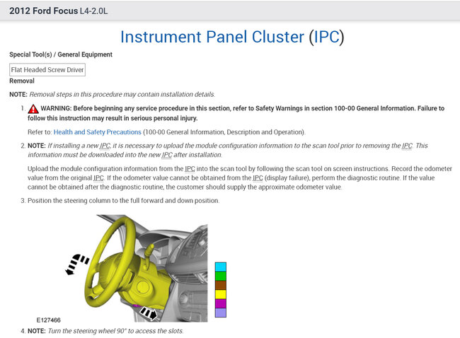

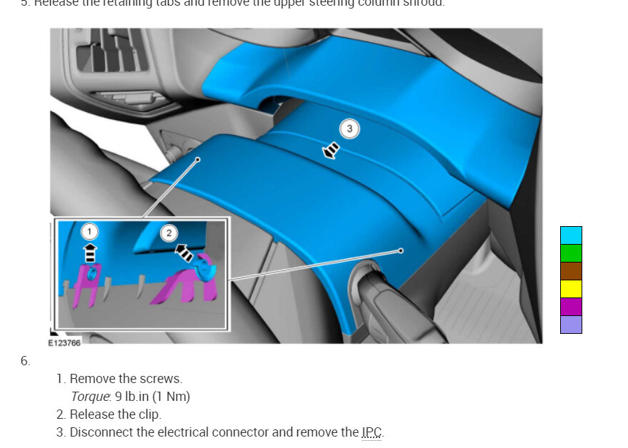

Yes, this is common when the instrument cluster goes out and needs to be replaced. here is how to remove and replace the unit but I would get a rebuilt unit by searching google or eBay so it will come preprogrammed. I would check all fuses just in case before doing the cluster.
Check out the images (below). Please let us know if you need anything else to get the problem fixed.
