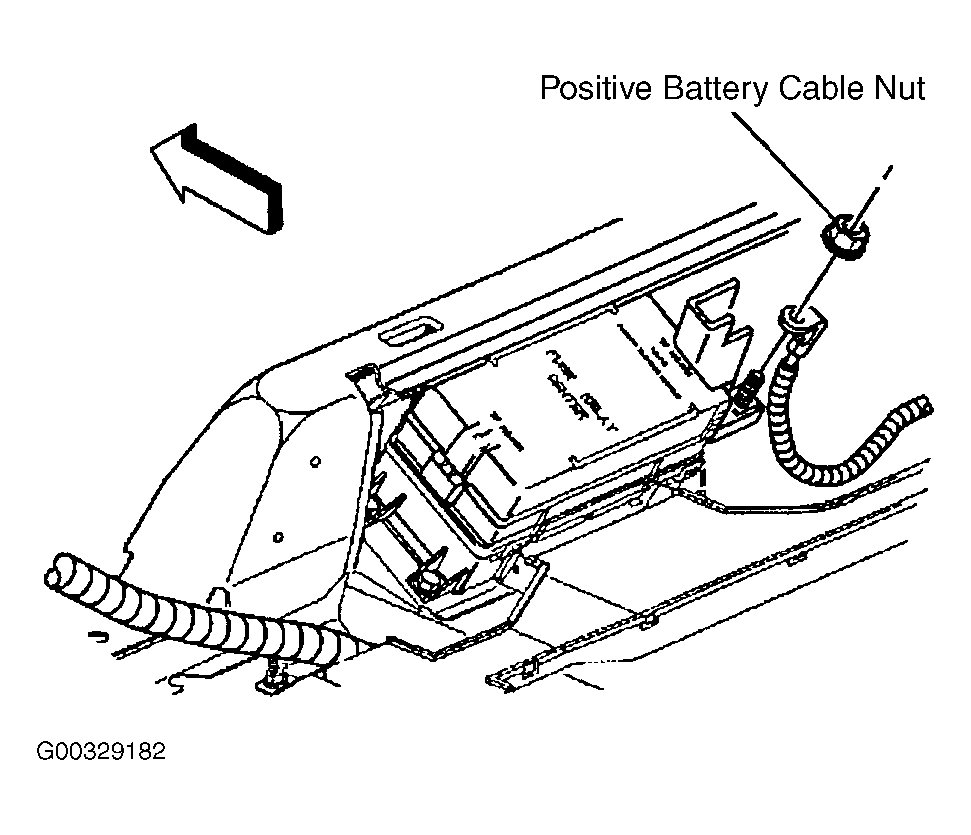

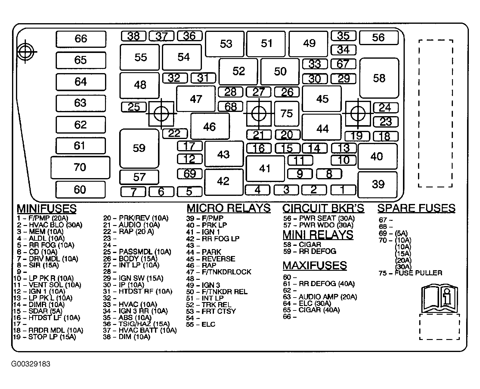

I would check the fuses in the rear fuse block. It is located under the back seat. See this guide

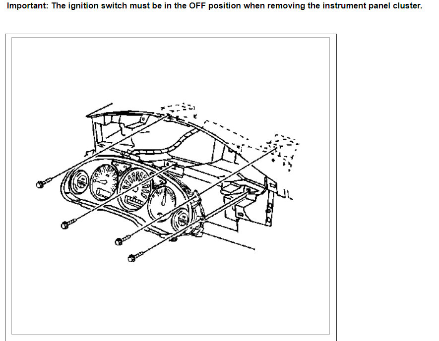

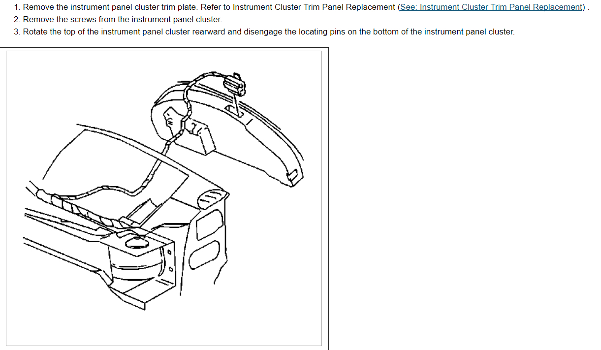

If okay the cluster is bad this video shows the job being done on a similar car but the process is the same.
https://youtu.be/_HEC44xENxw
In particular, I would look at fuse #30. See the attached images for more information below.

  • 55,628 POSTS
It sounds like you have cold solder joint in the cluster and it needs to be rebuilt. Here is a video that will show you what you are in for when doing the job.
Here is what it will be like for your car.

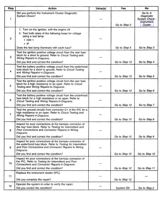

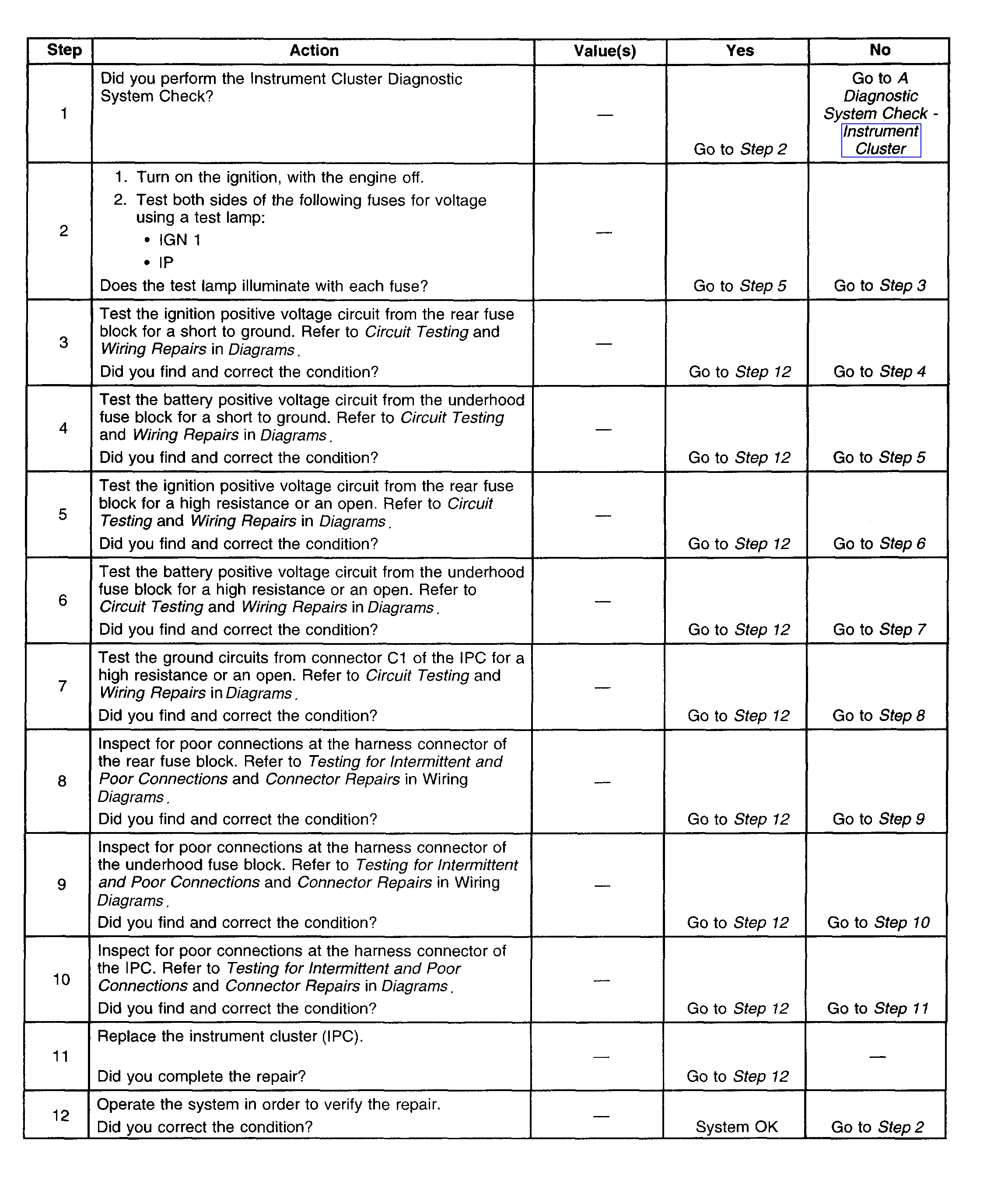

  • 110,248 POSTS
Hi and thanks for using 2carpros.com.
Since they all stopped working at the same time, there is a good chance it is a fuse. I have attached a diagnostic flow chart to help locate the problem.
Take a look through it and see if it helps. Also, let me know what you find or if you need help.
