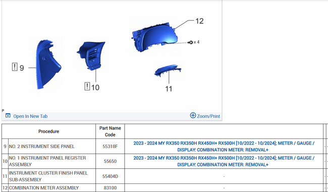

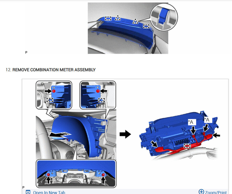

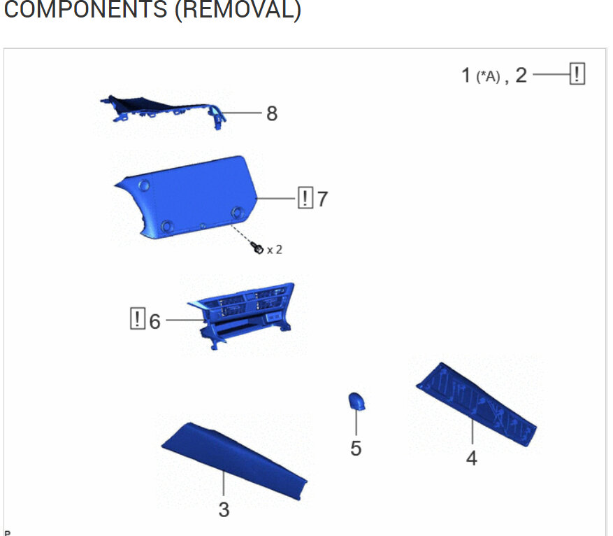

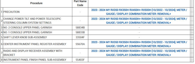

Need removal diagram for digital cluster removal for 2024 Lexus RX 350
Mar 3, 2026 at 1:24 AM
  • 55,709 POSTS
O ya, they did not make that easy on this car, I would disconnect the battery first before you begin. It looks like you need to remove many panels including the radio and receiver bracket with the upper console panel garnish. Check out the images (below). Please upload an image or a short video in your response, so I can see what's going on. Ken
