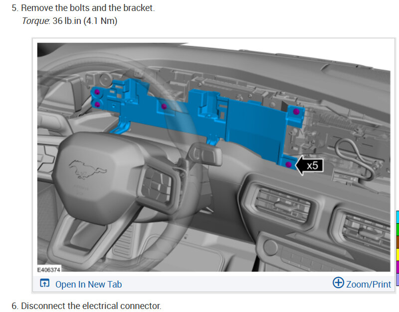

Looking for layout to remove cluster display in 24 ford mach e. Display is cracked $ need to be replaced. No covered under warranty..
Nov 17, 2025 at 2:35 AM
  • 55,433 POSTS

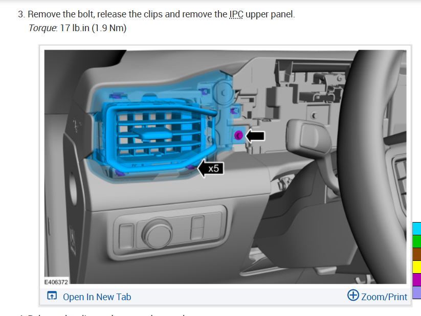

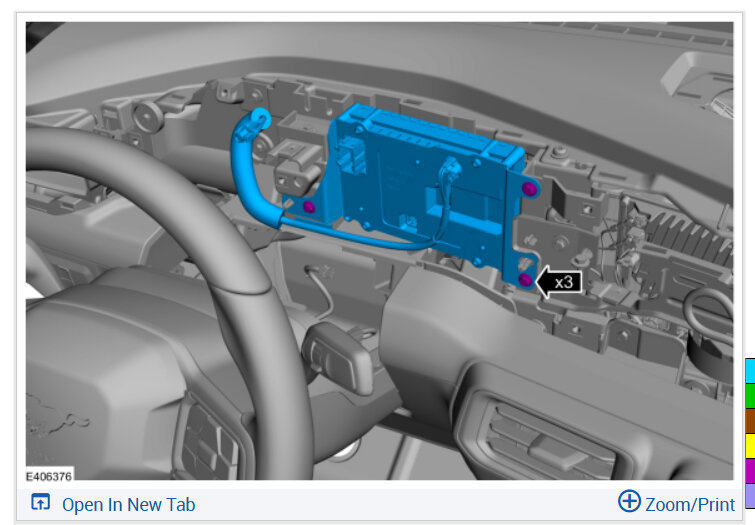

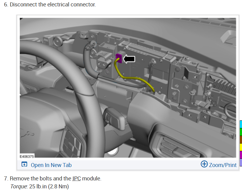

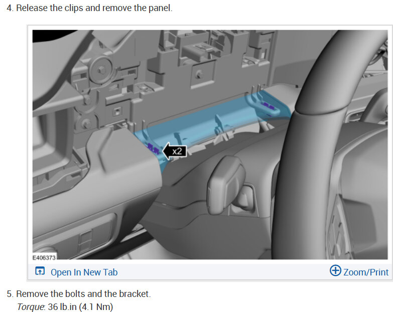

Here are the instructions on how to remove the instrument cluster, you will need to disconnect the 12 volts battery before you begin. Please check out the images below and I will email them to you as well.
To install, reverse the removal procedure.
NOTE: This step is only required if installing a new module.
Using a diagnostic scan tool, complete the PMI process for the IPC module following the on-screen instructions.
Using a diagnostic scan tool, complete the FDRS Module Configuration process for the new IPC module following the on-screen instructions. Check out the images (below). Let us know if you need anything else.
