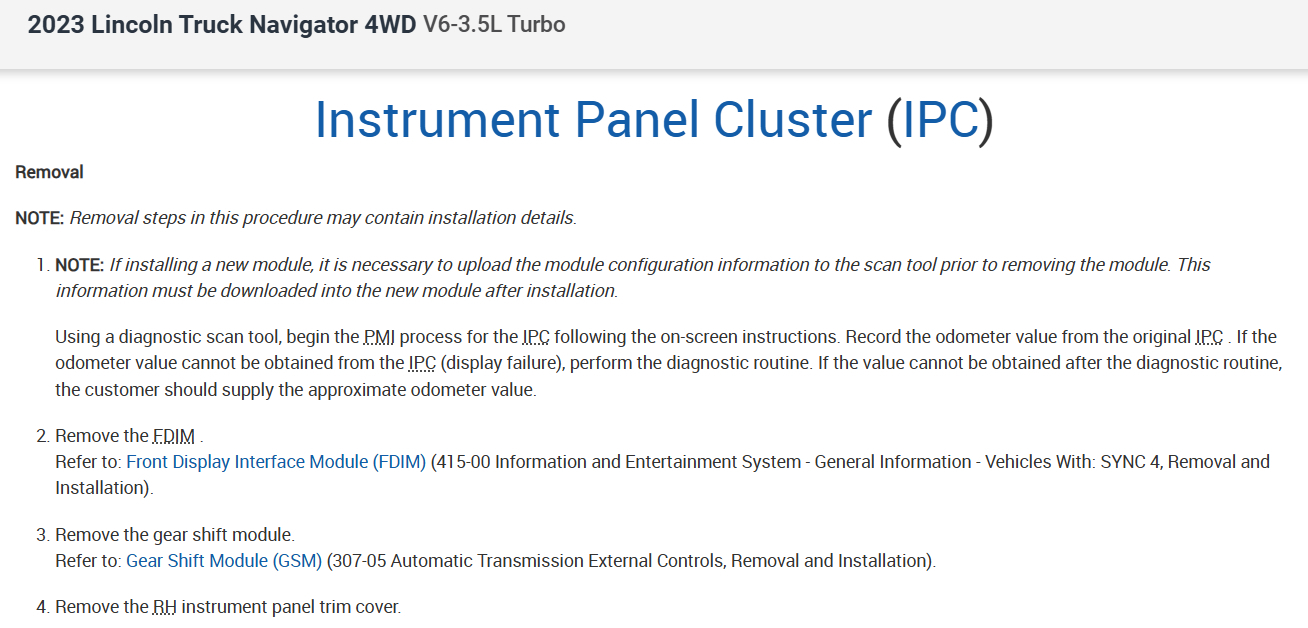

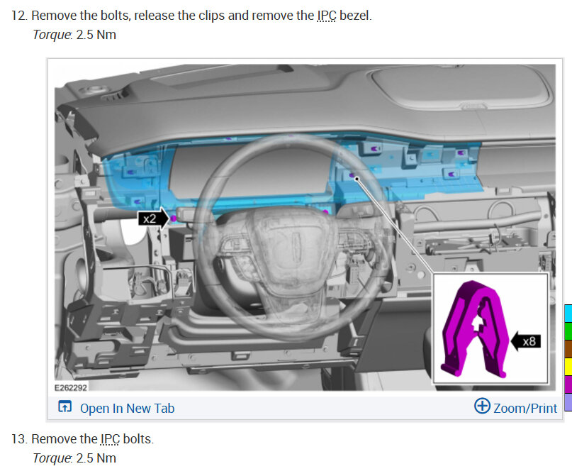

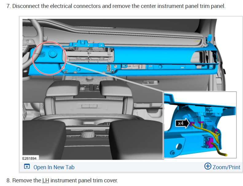

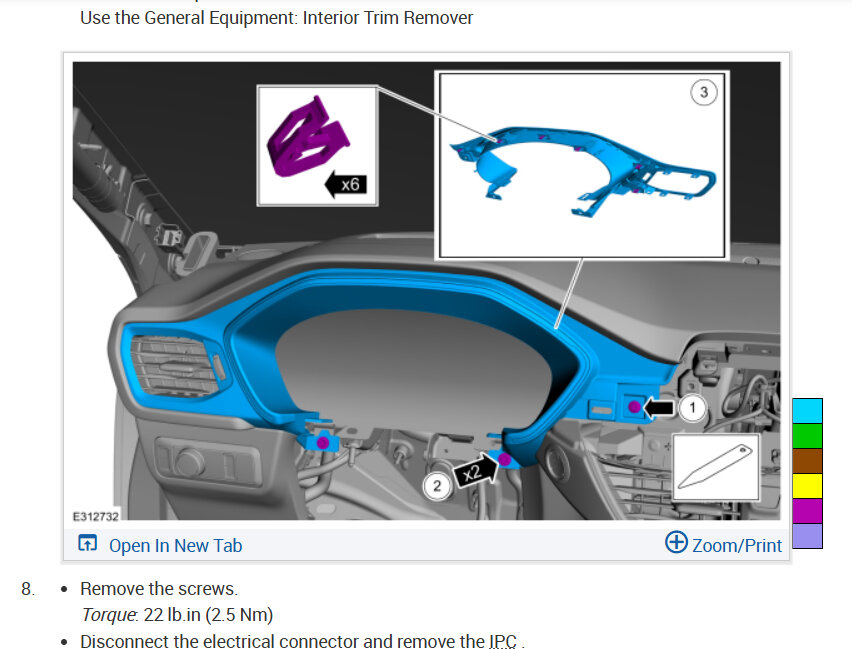

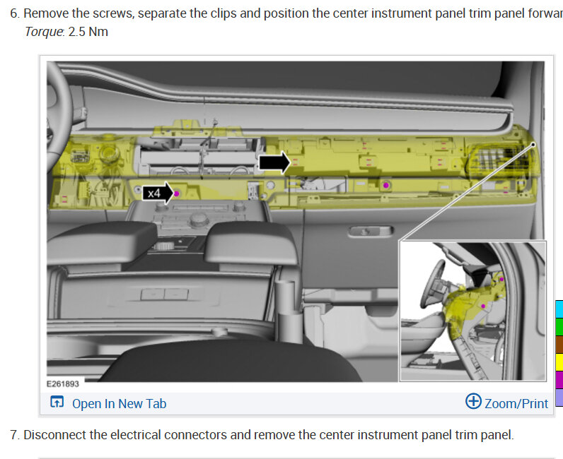

Looking to remove cluster display and a diagram for removal.

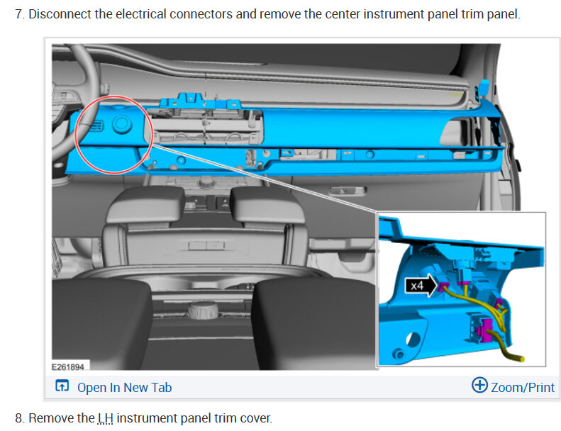

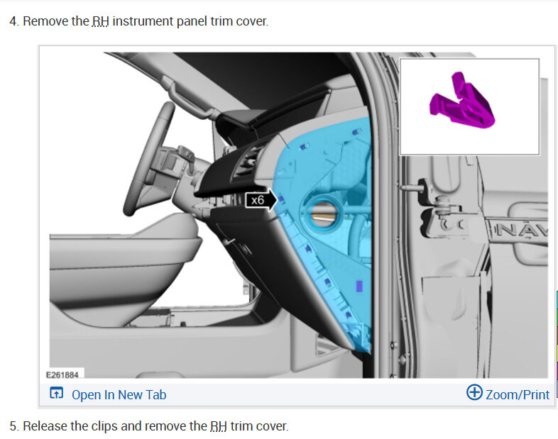

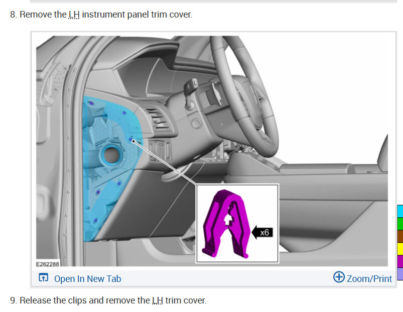

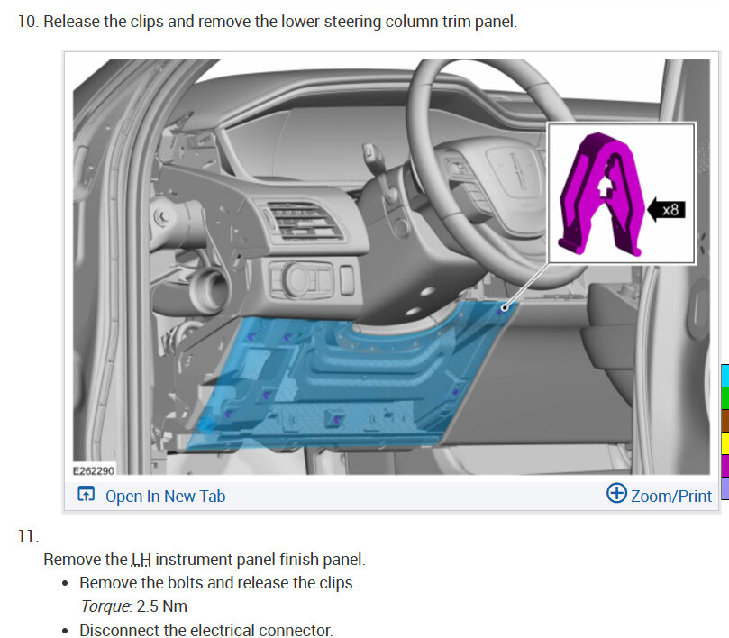

Here are the instructions on how to remove the instrument cluster, it looks like you will need to remove the trim panels from under the steering column and along the middle of the dash. Check out the images (below). Let us know if you need anything else.

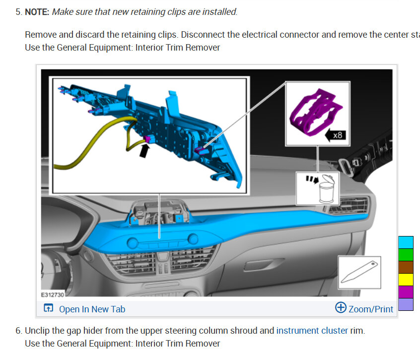

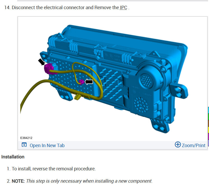

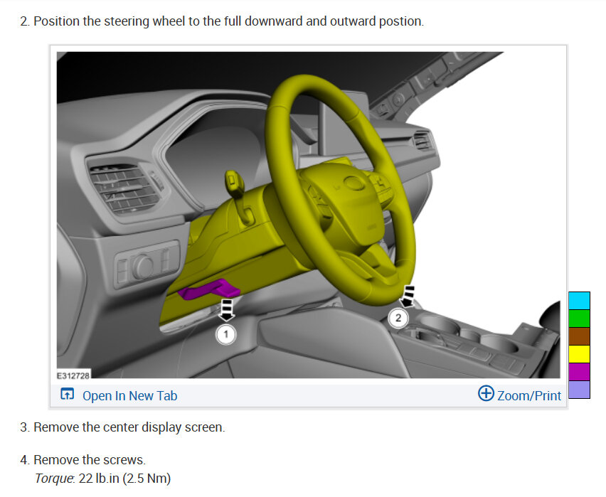

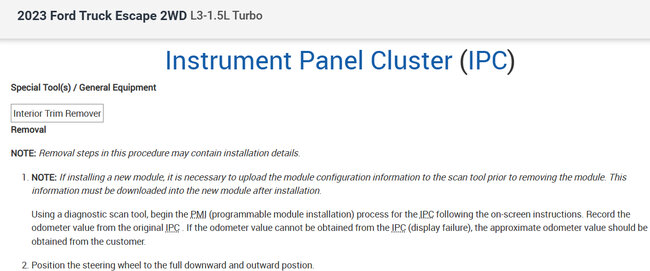

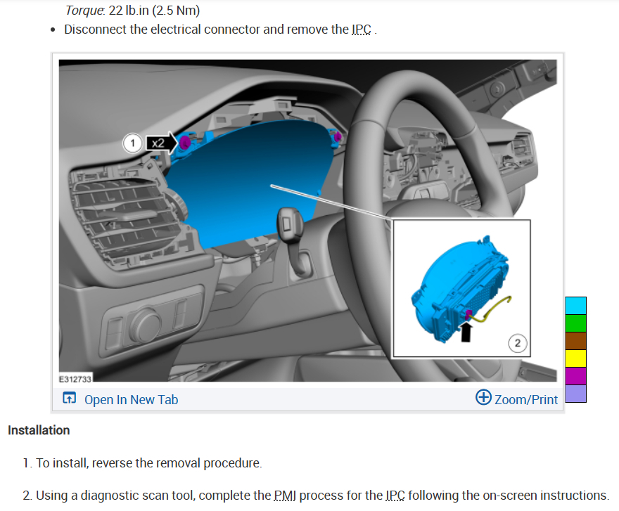

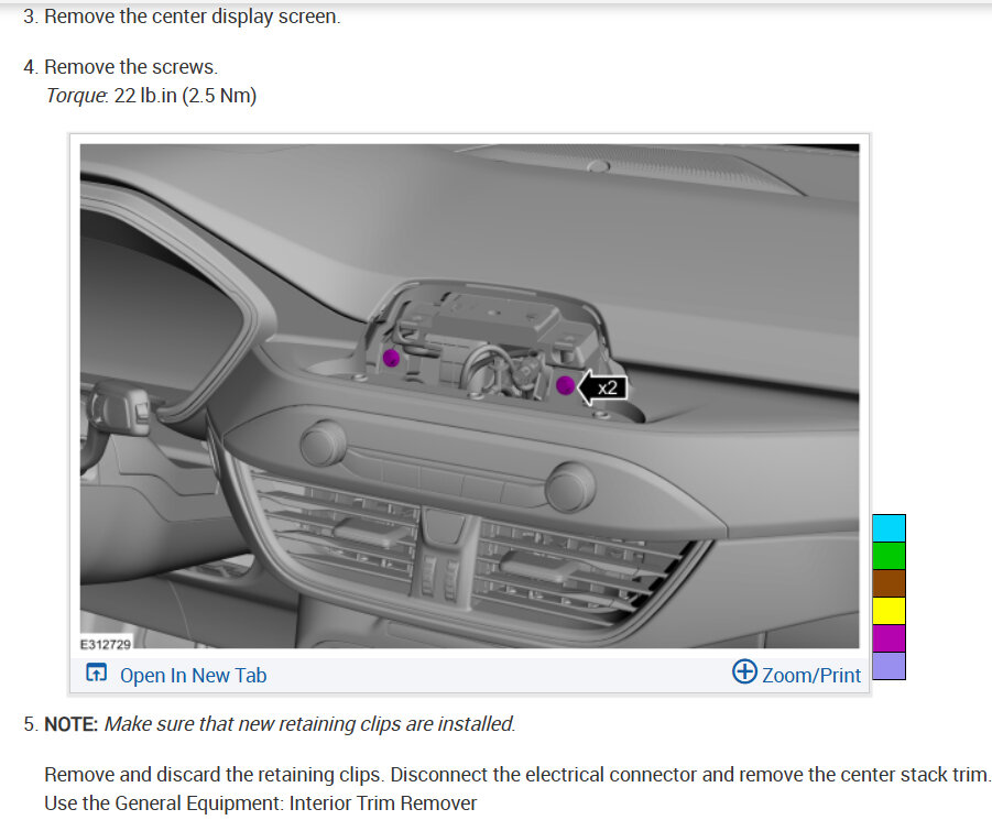

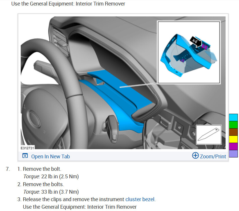

I want to upgrade cluster display and would like to know how to remove the speedometer cluster display.

Sure, here is how to remove the instrument cluster panel. Check out the images (below). Let us know if you need anything else.

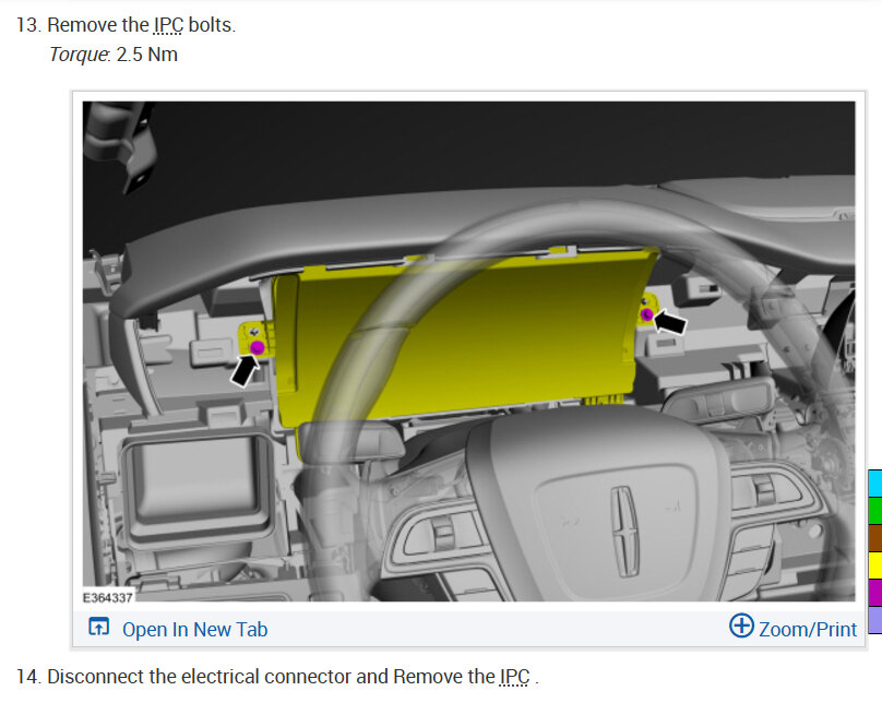

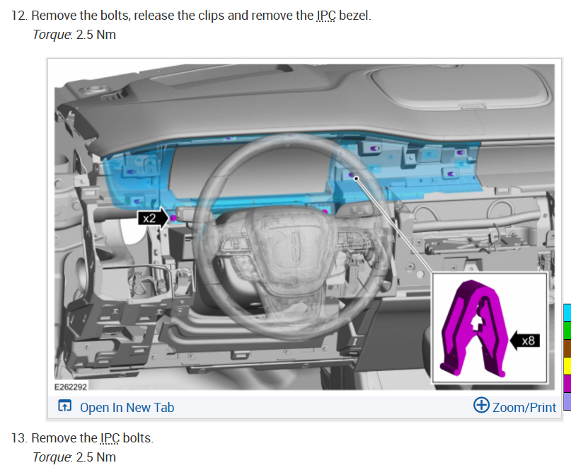

Looking the removal of the cluster display on a 2023 LINCOIN CORSAR i know i entered the Avatar but they are similar in display size & cockpit. But if you have the diagram for the CORSAR i glad appreciate it thank you..

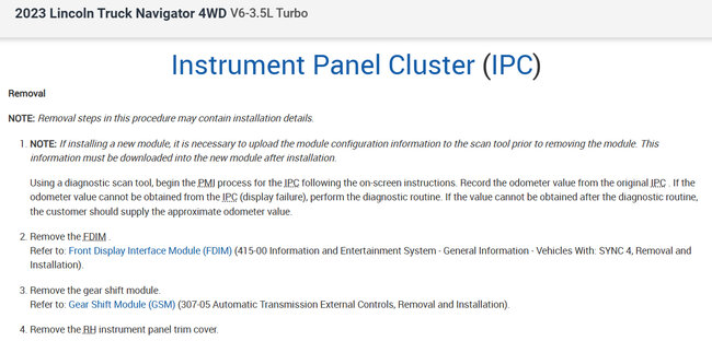

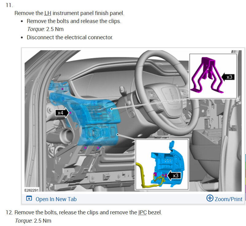

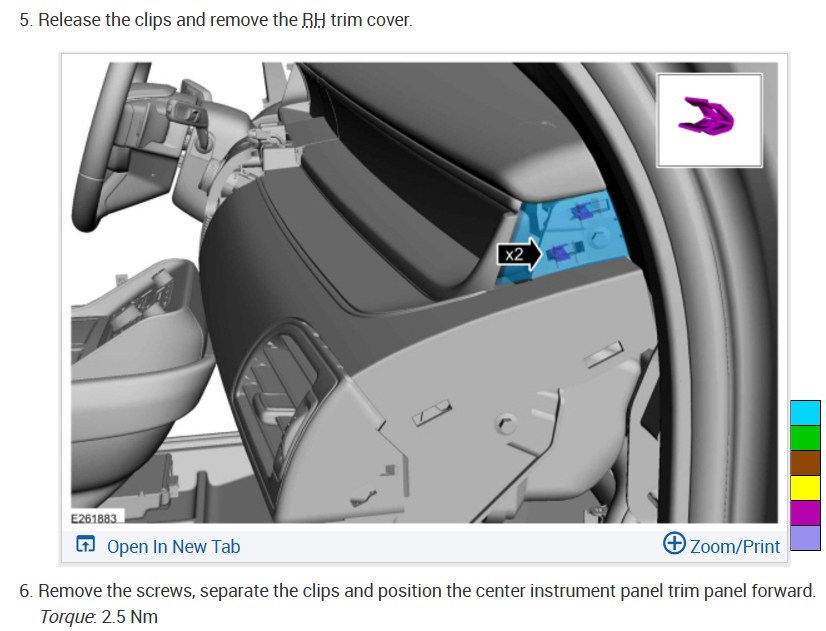

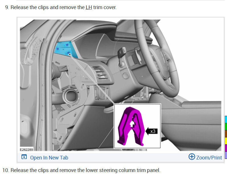

Need diagram to remove digital cluster display in 2023 ford navigator
Thanks
