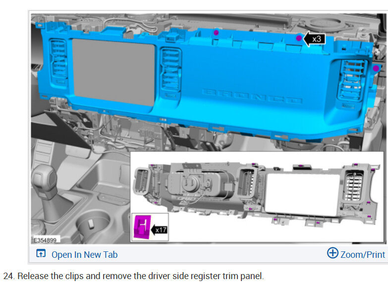

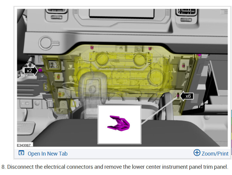

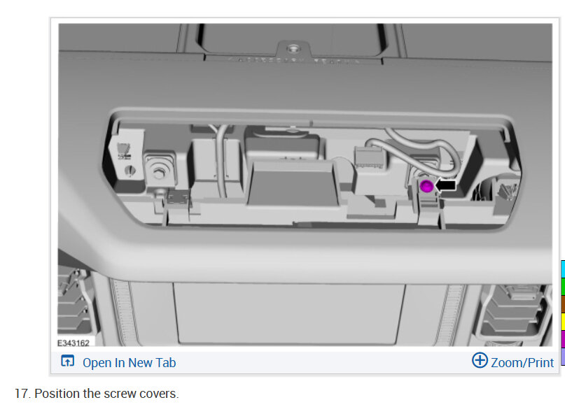

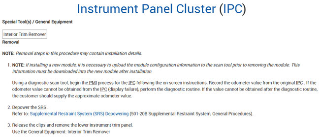

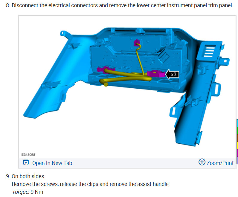

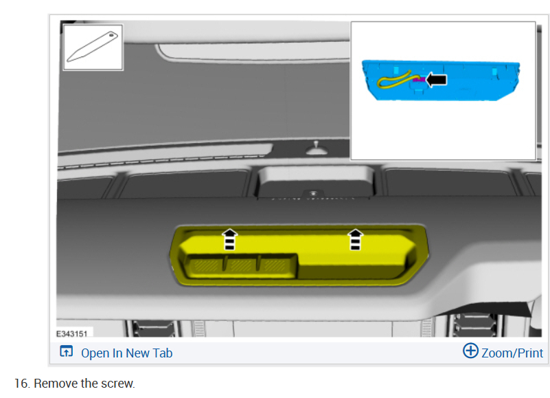

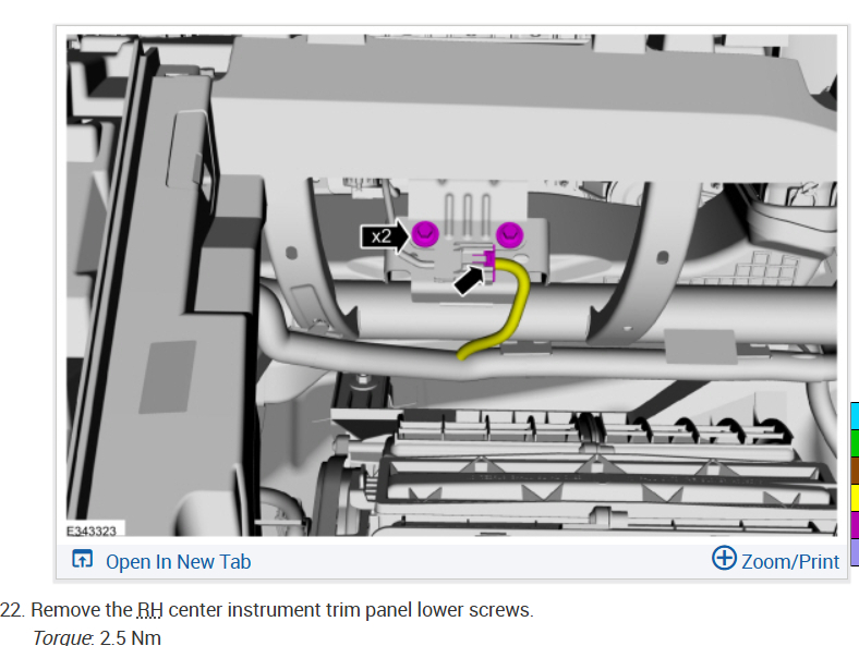

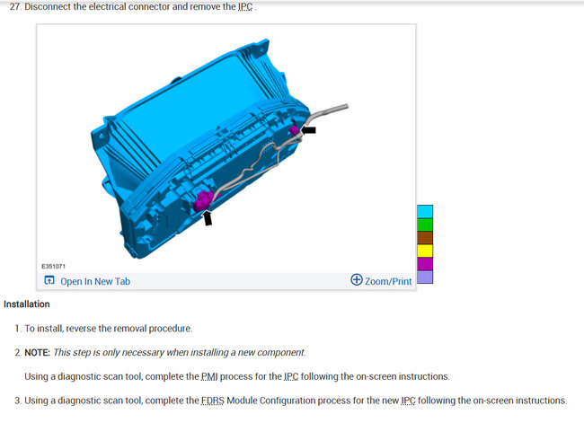

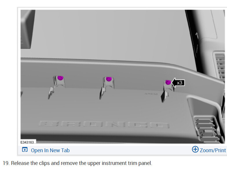

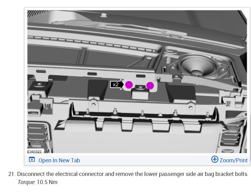

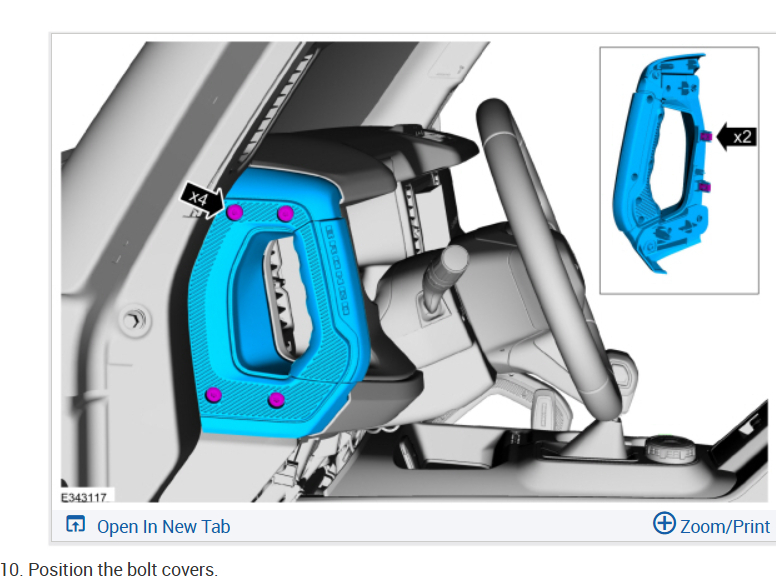

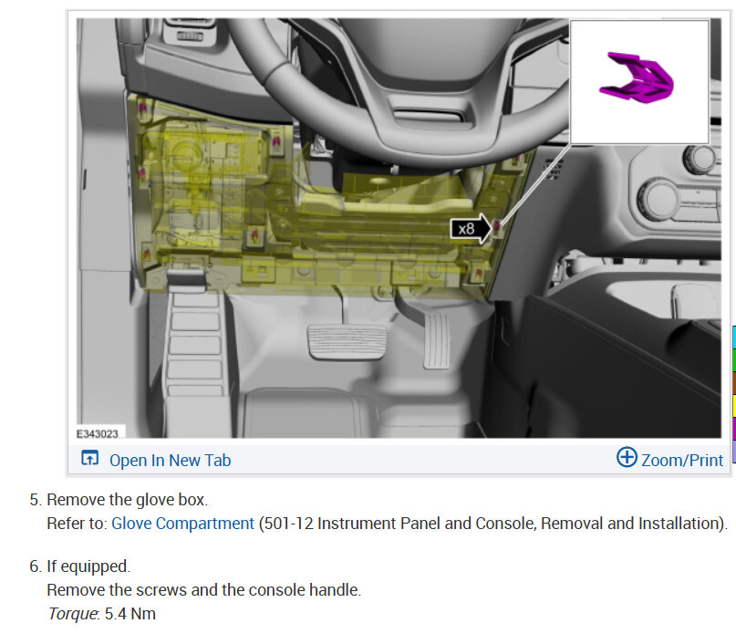

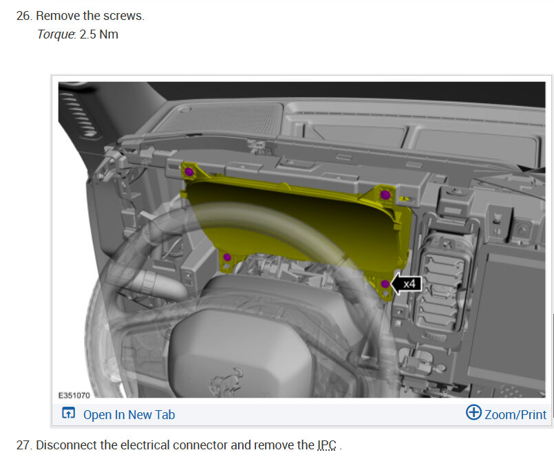

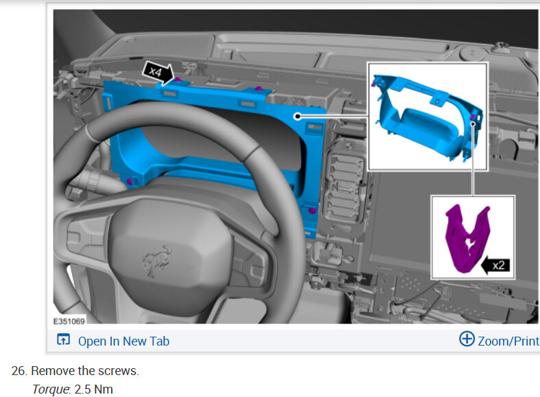

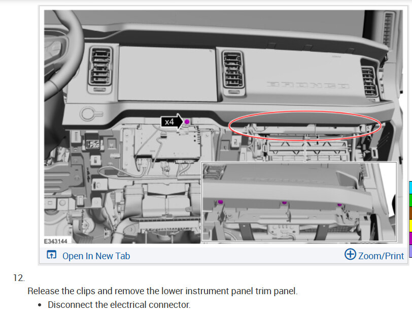

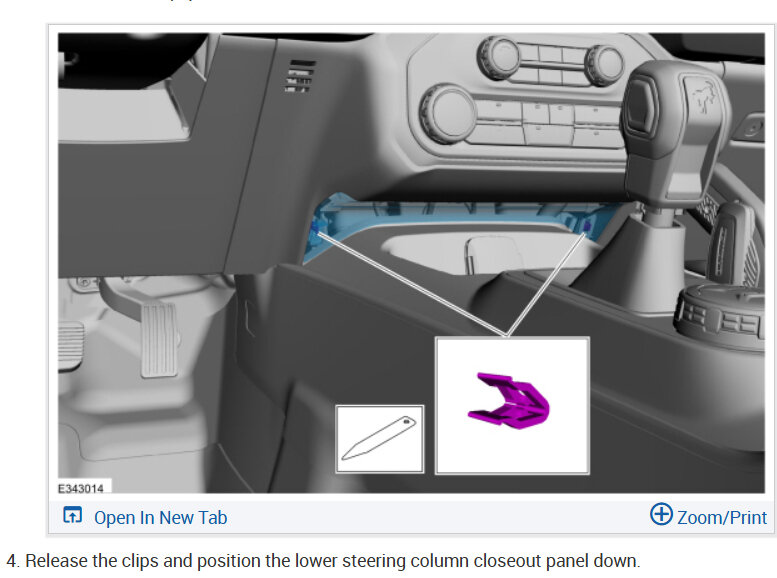

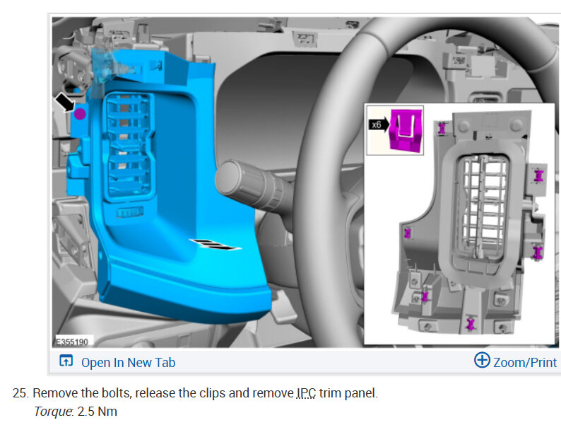

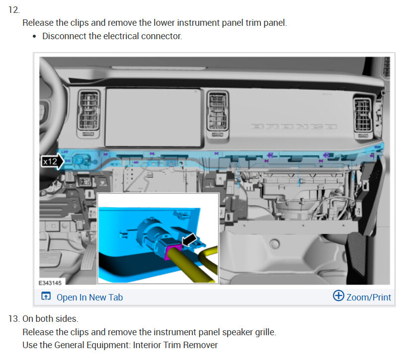

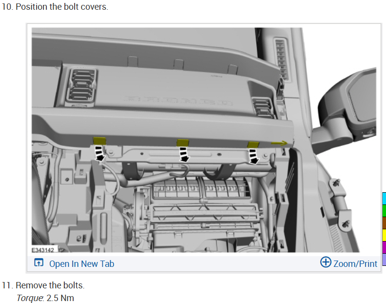

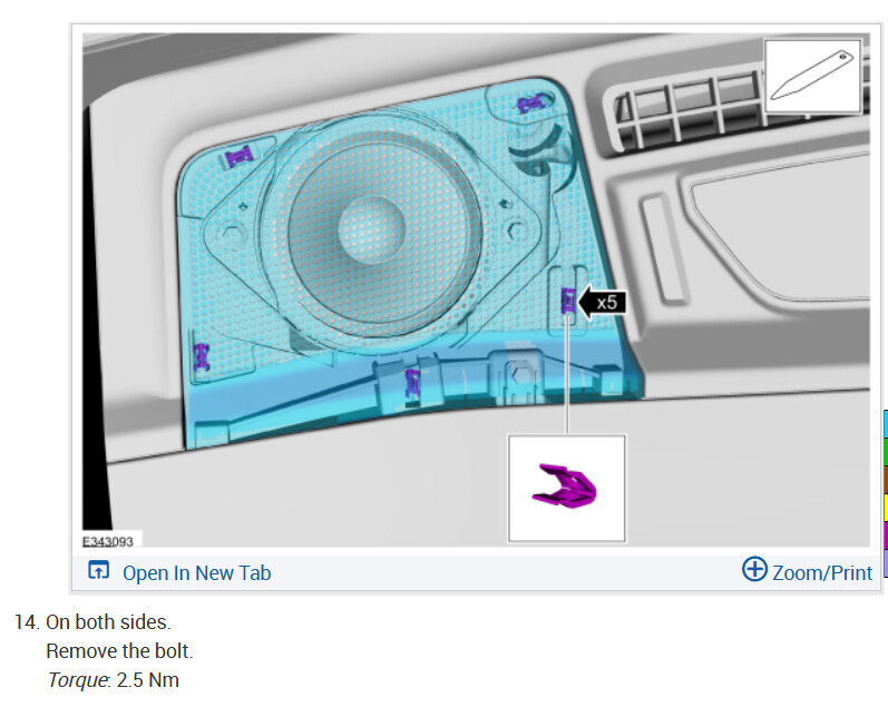

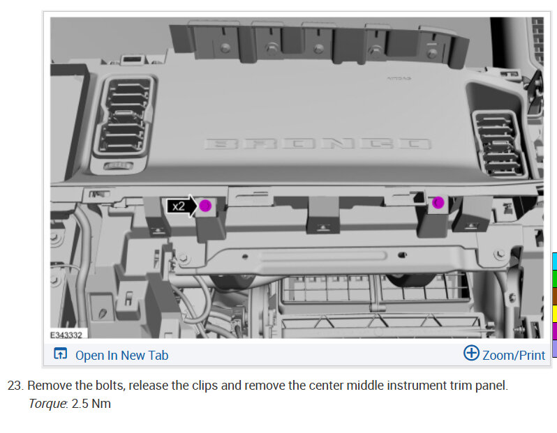

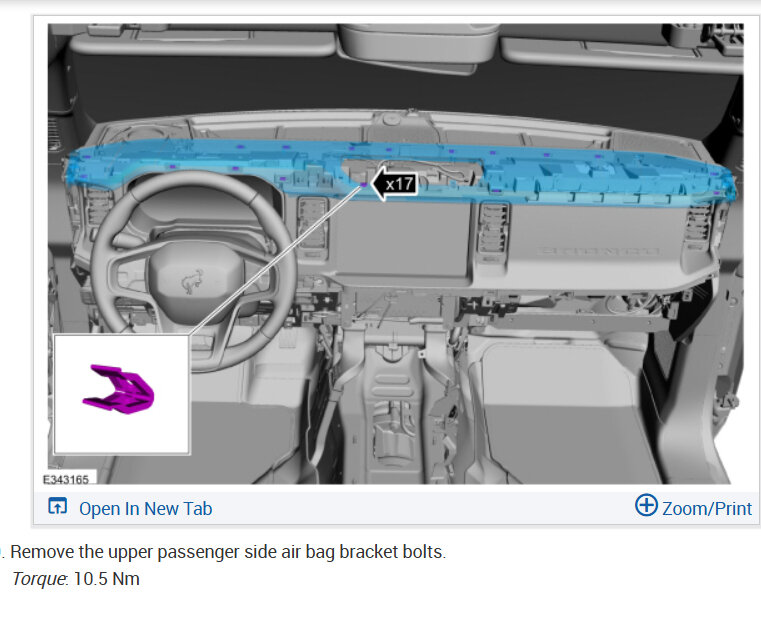

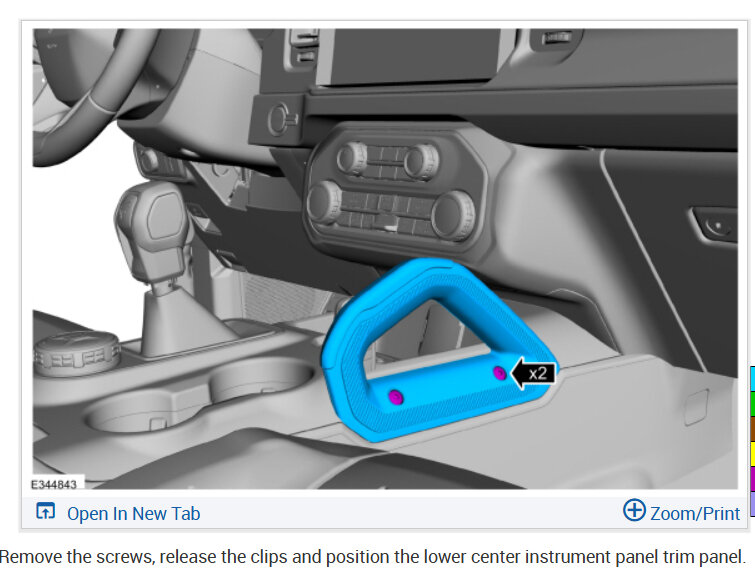

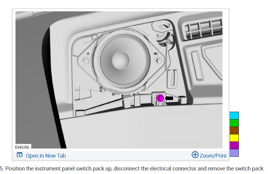

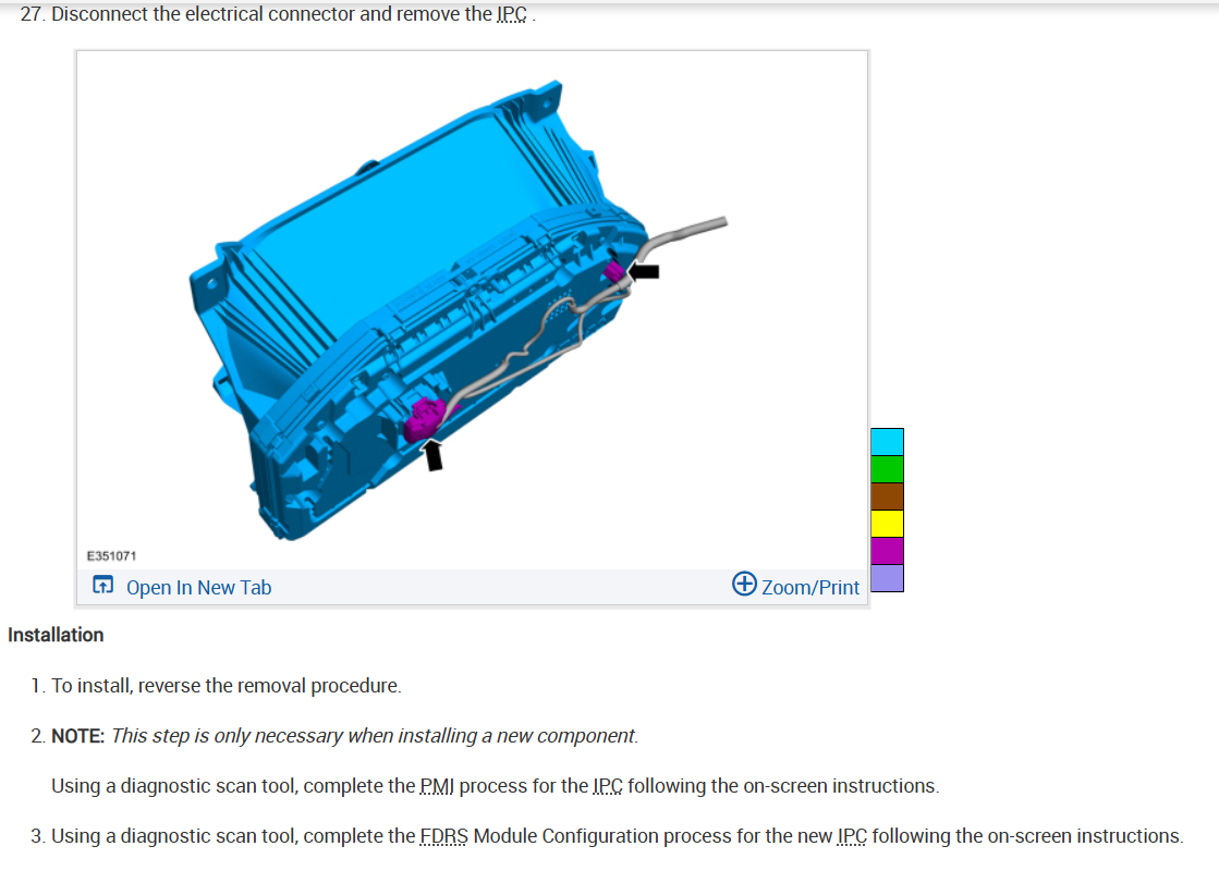

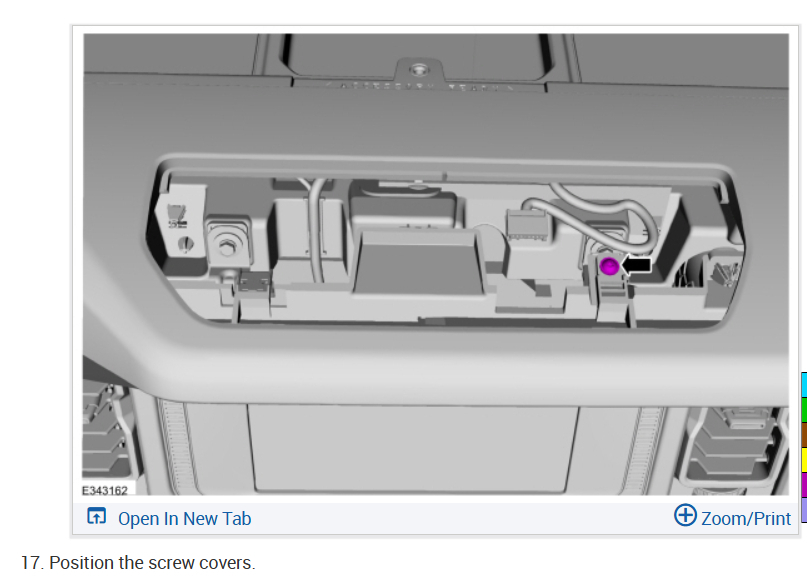

How do you remove full digital cluster display in the new 2025 Ford Bronco.
Thanks
Jul 14, 2025 at 10:14 AM
  • 55,710 POSTS
Good night! There is 27 steps to pull the instrument cluster form this car. Start by disconnecting the battery to help disarm the SRS. Let it sit for 15 minutes. Then follow the instructions below, let me know if you need anything else. Check out the images (below). Let us know how it goes
