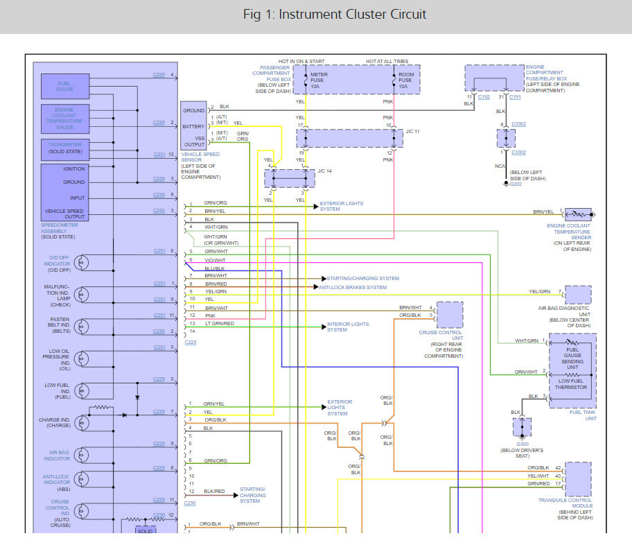

Hello, I want to change my fuel and temperature gauge and I need a wiring diagram. Can anyone help?
Aug 21, 2022 at 9:50 PM
Experienced Mechanic
55,694 POSTS

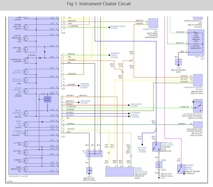

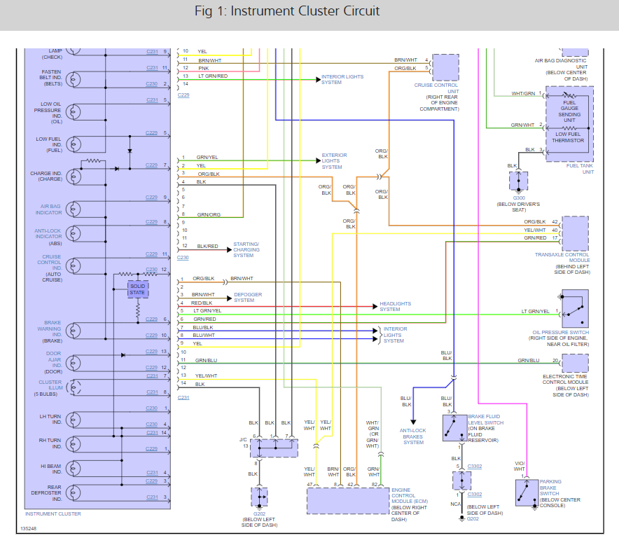

Here are the wiring diagrams for the instrument cluster as you have requested. Let me know if you need anything else to fix the problem.

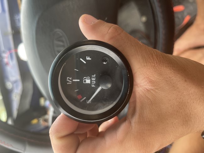

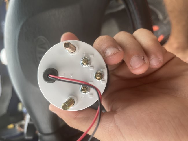

I have this one I connect c229 4 white/green to the S, c229 3 BLK to the - and c229 5 green/white to the + !! I think that’s it but it doesn’t work !!
Images (Click to enlarge)
Aug 23, 2022 at 1:27 AM
55,694 POSTS
Yep, it may not work with the fuel gauge because the sender inside the fuel tank doesn't match.

How can I find one that match my sender ?
Aug 23, 2022 at 5:07 PM
55,694 POSTS
Yes, contact the gauge manufacturer and they will have a solution, either an inline resistor or a new sender.
