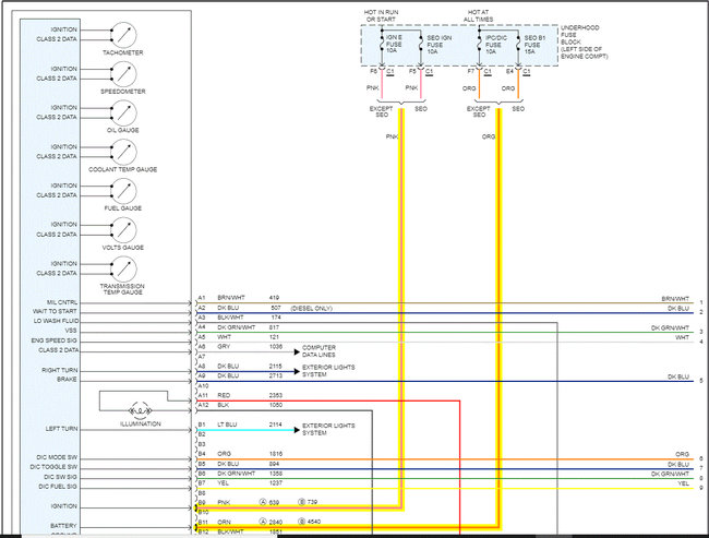

Hot wire in the cluster on the dash location needed.

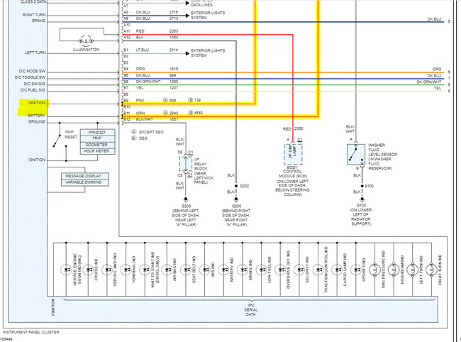

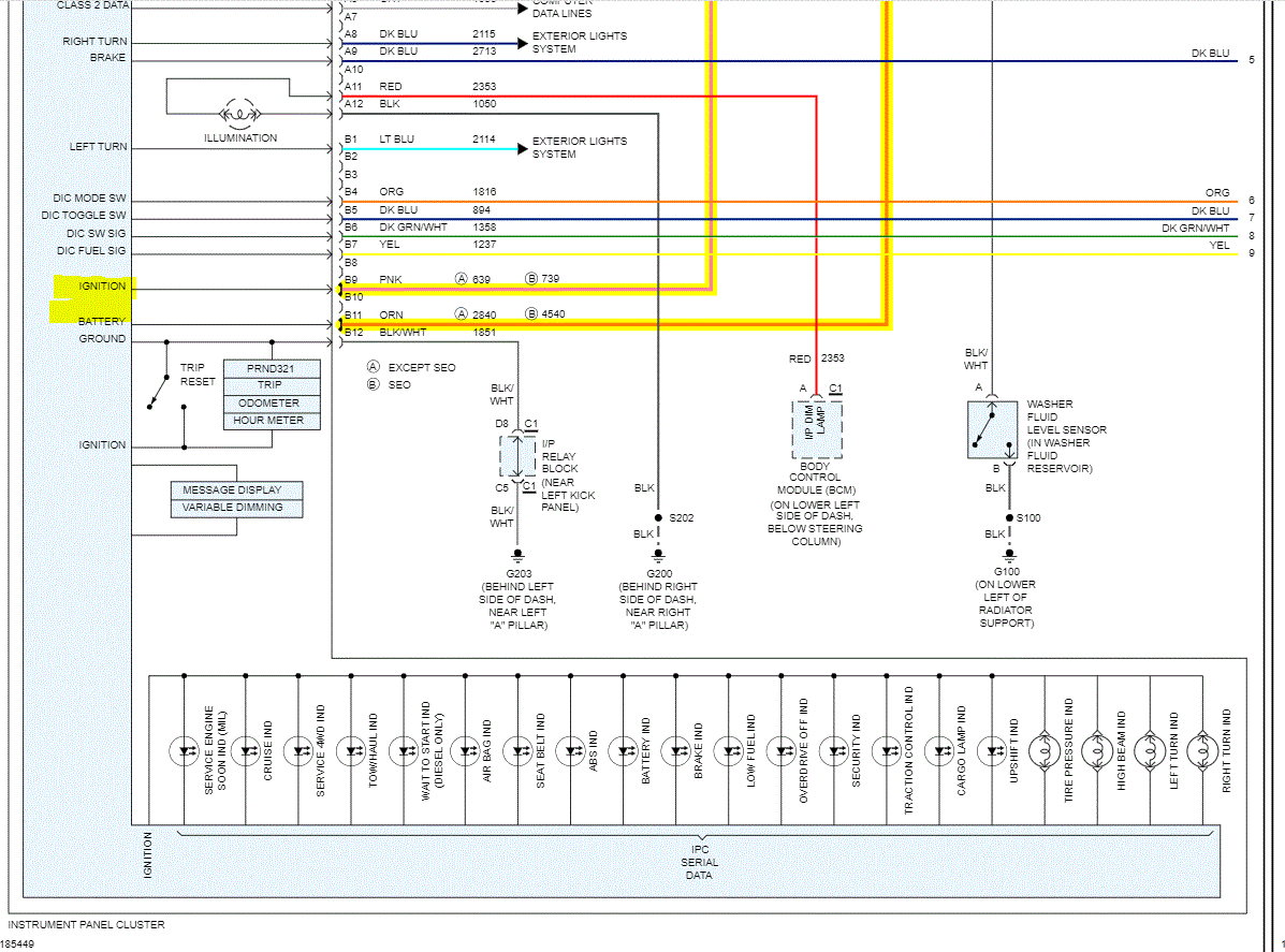

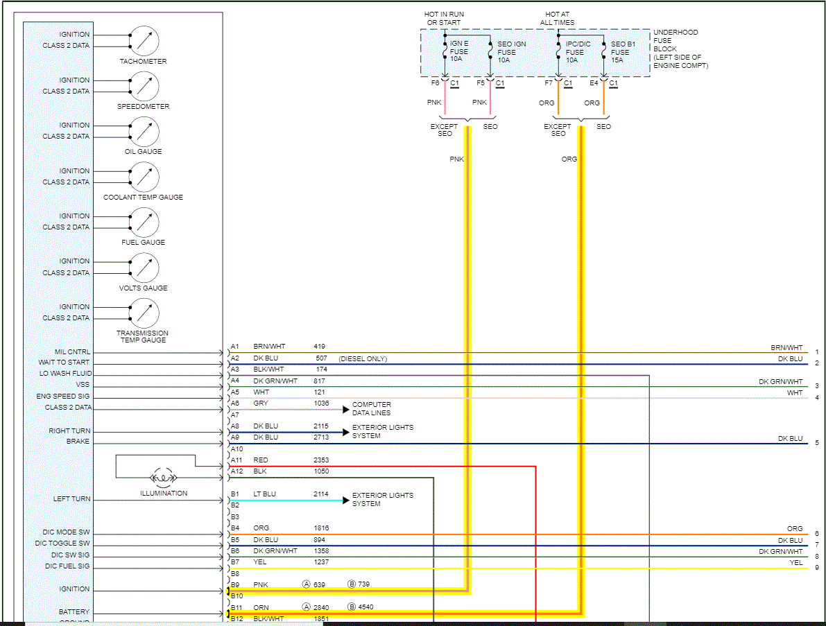

Power is from the fuse box under the hood. I attached two pics below showing the power supplies. Let me know what is happening and maybe I'll be able to help.
