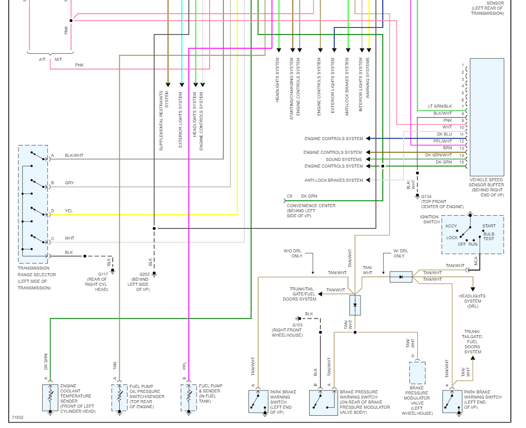

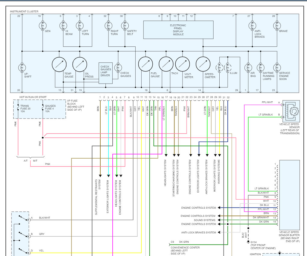

That is strange, here is a guide to help you test the wiring connections and the wiring diagrams for the cluster so you can see how it works and which wires to test.
I have seen the vehicle speed buffer cause problems like this as well. Check out the images (below). Please let us know what happens.

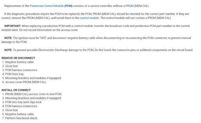

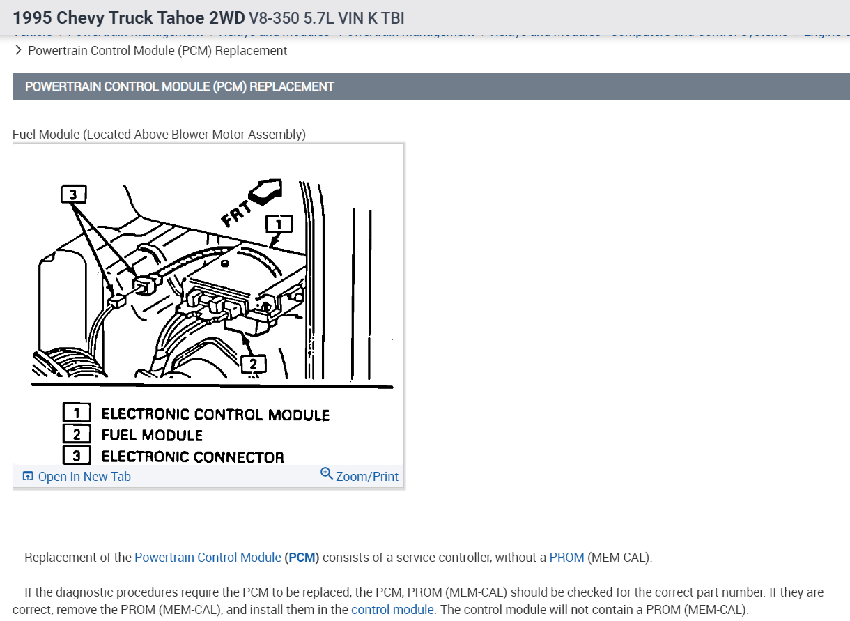

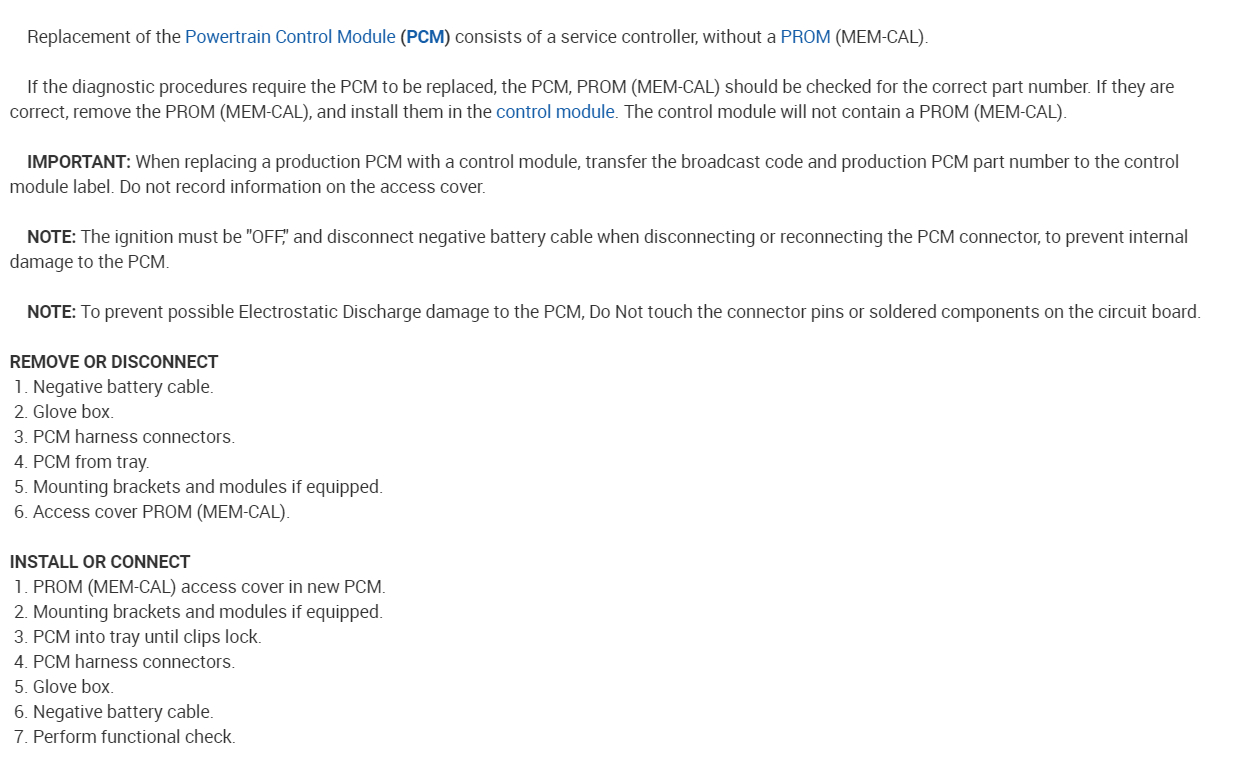

There must be a problem with the PCM since both of these signals run through it. Here is how to change the unit out, you can get a preprogrammed unit by searching Google or Ebay. Check out the images (below). Please let us know what happens.
