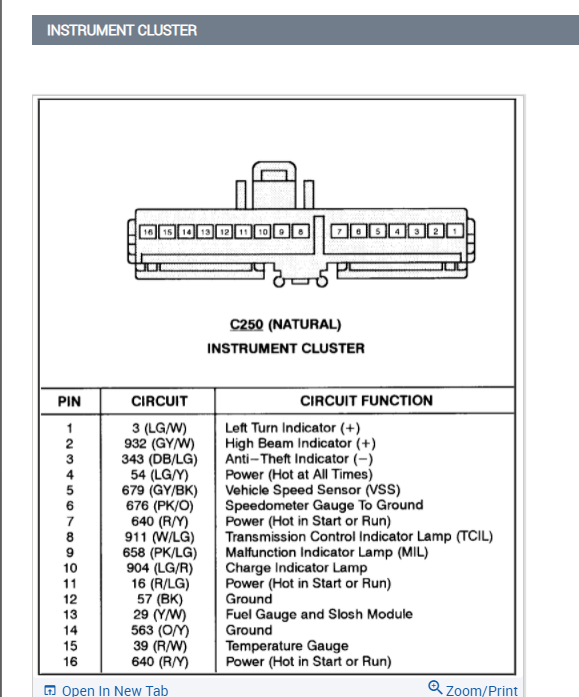

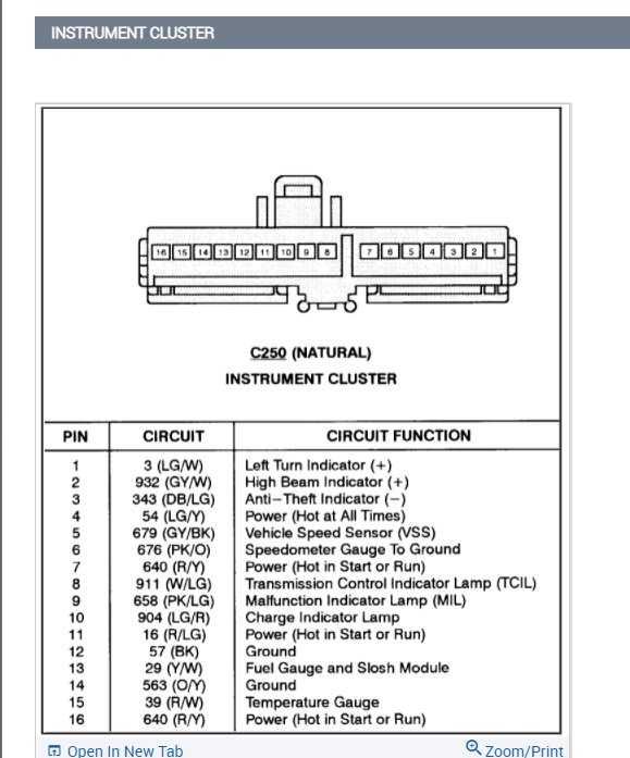

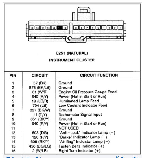

All the wires have been cut that go to my clusters, is there any where I can get a lay out of what wire go where?

It the cluster wires cut not the radio.

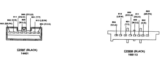

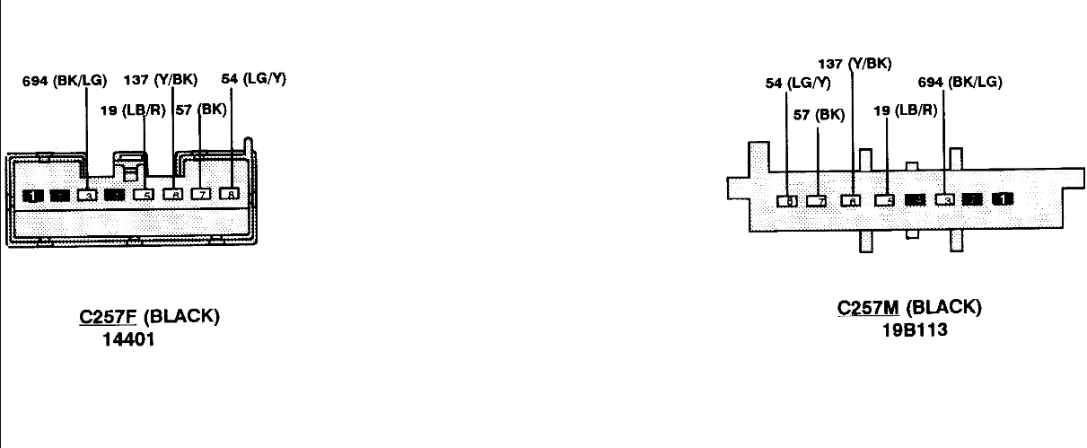

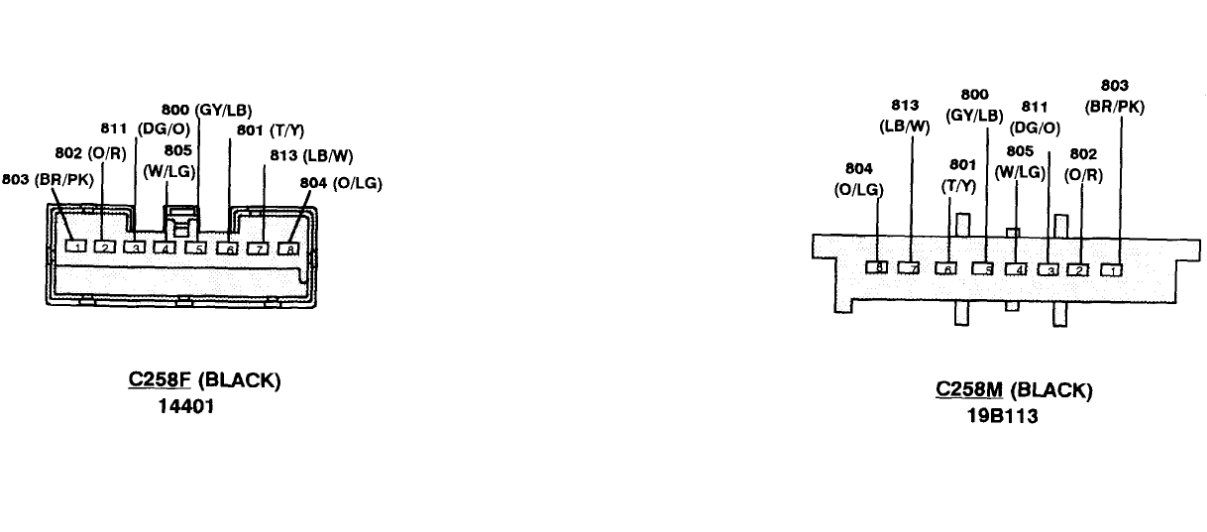

I am attaching the cluster connectors below. Please let us know what else you need with this, and we can get that for you.
