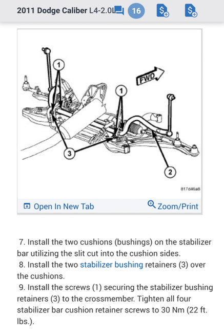

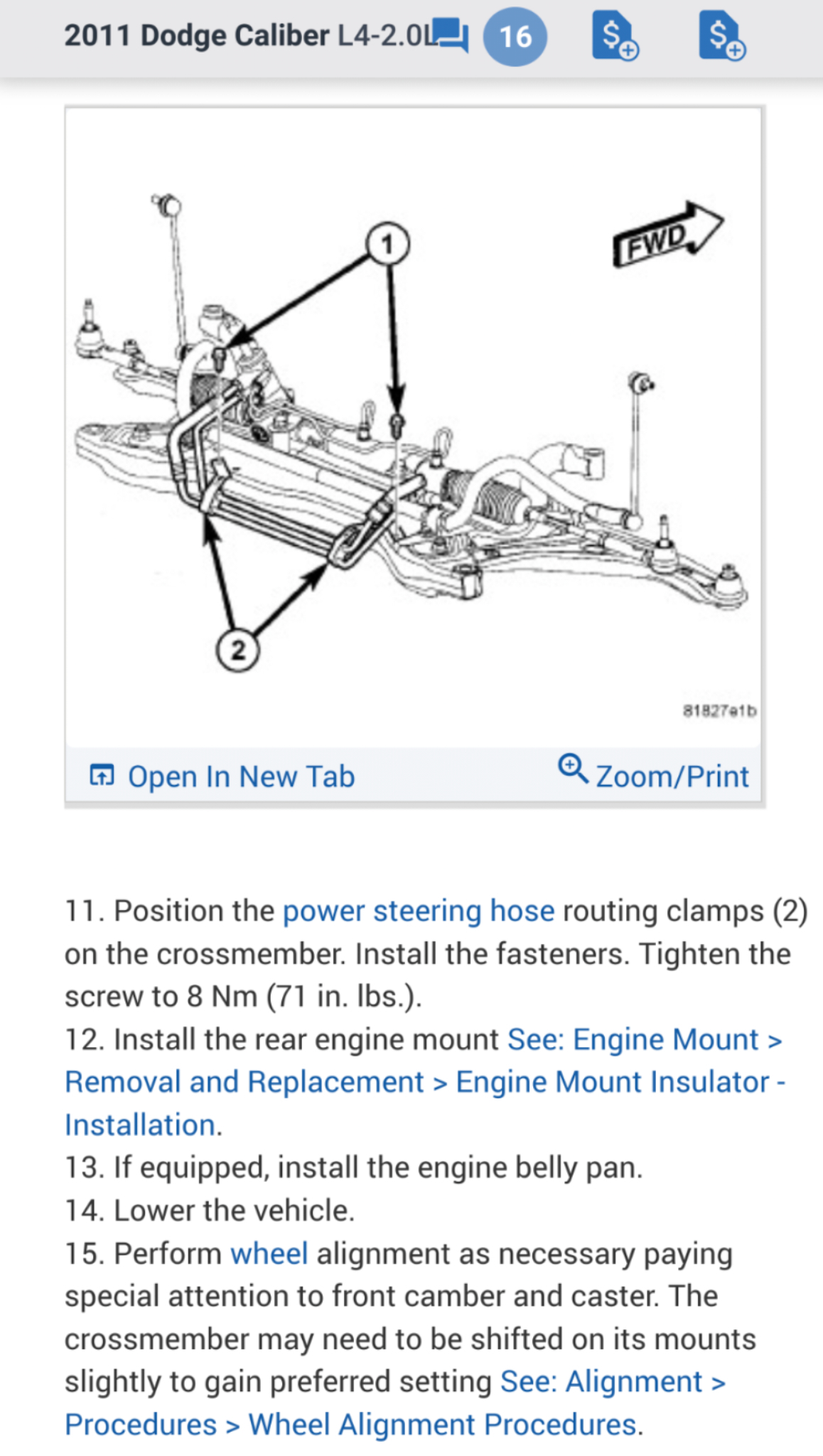

I was told my front sway bar bushings need replaced. Been looking for video showing me where they are located and how difficult to replace, but cannot get my model of car, comes up with trucks or chargers and such.
May 21, 2021 at 11:27 AM
HARRY P
  • 2,292 POSTS

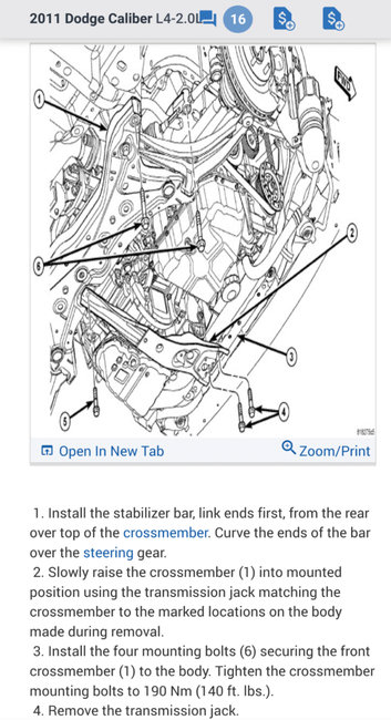

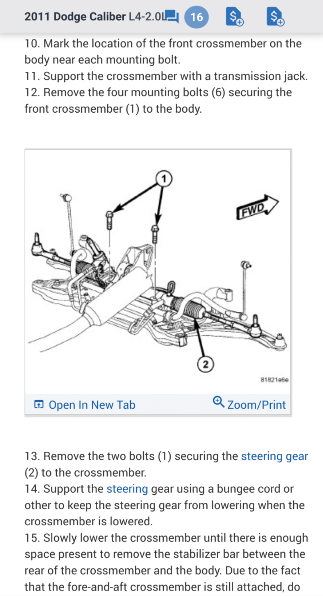

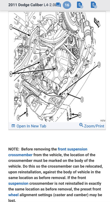

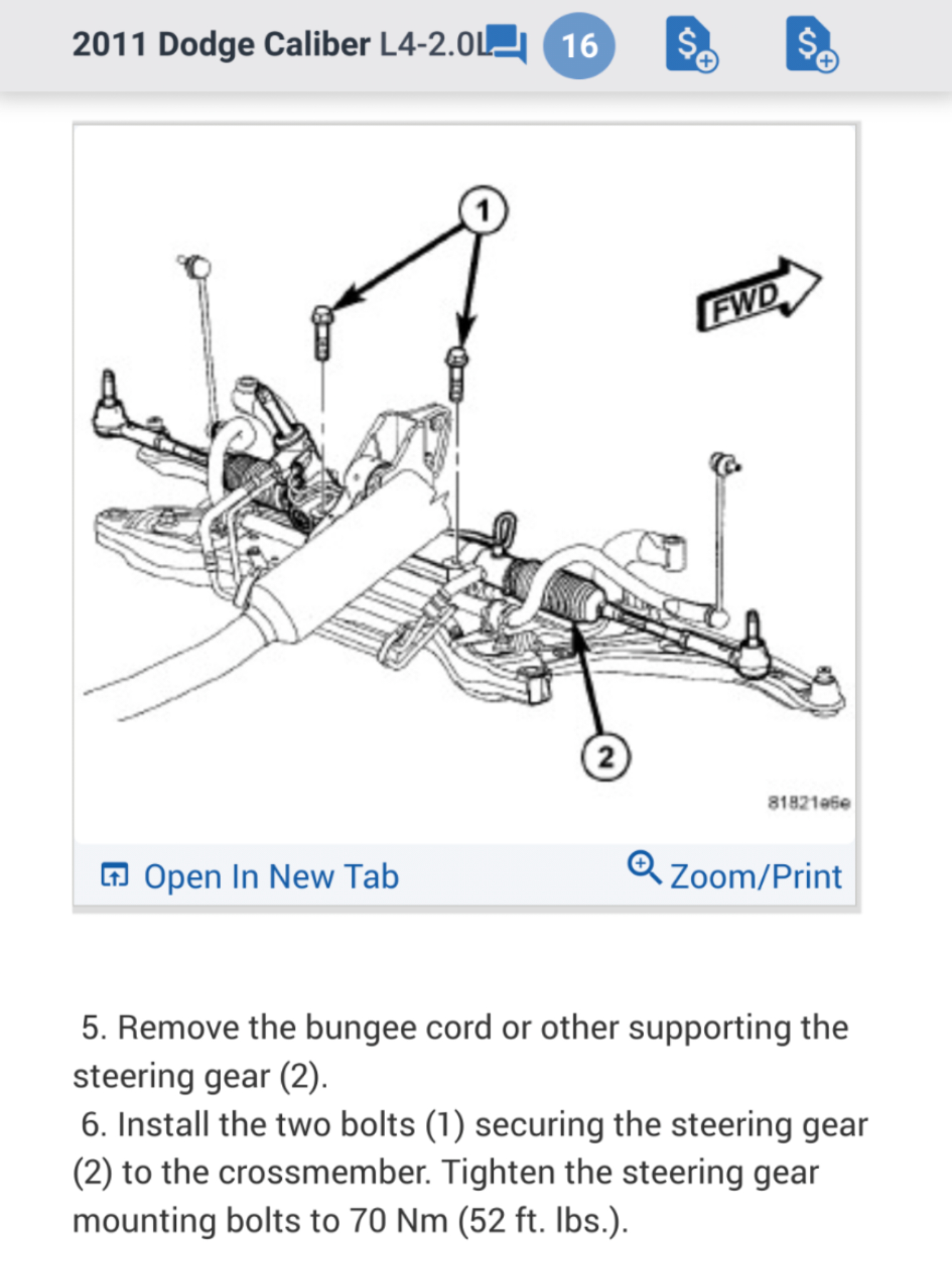

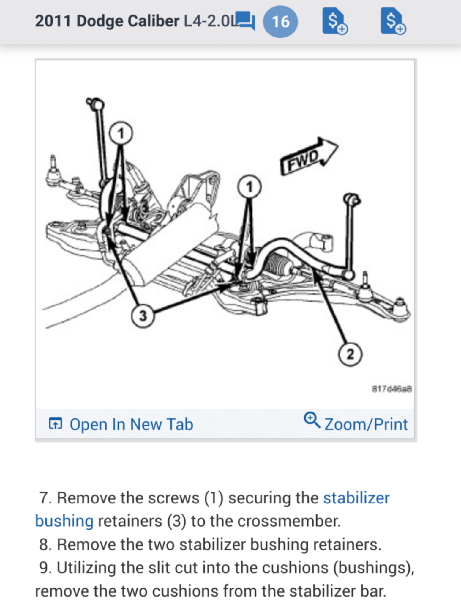

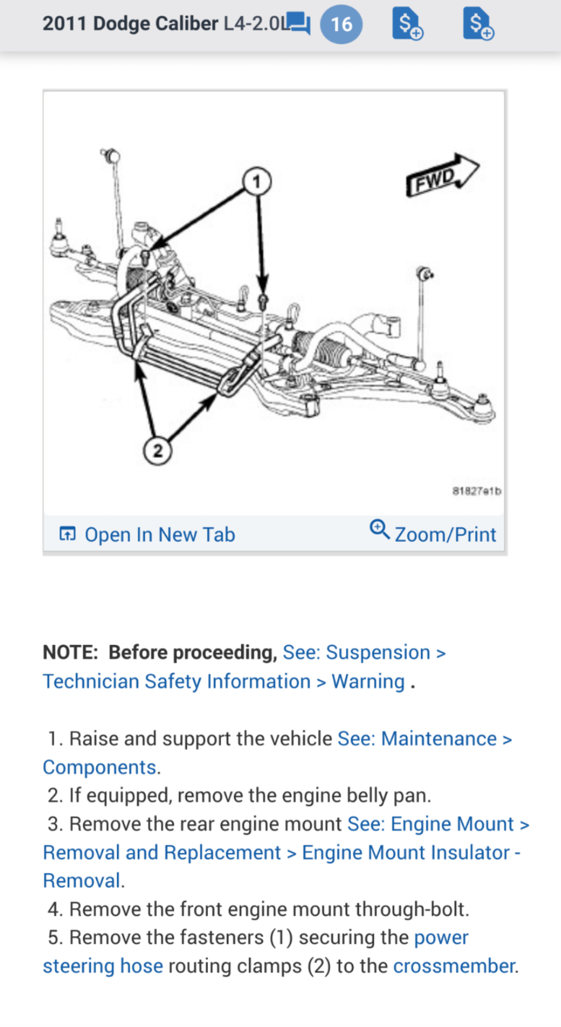

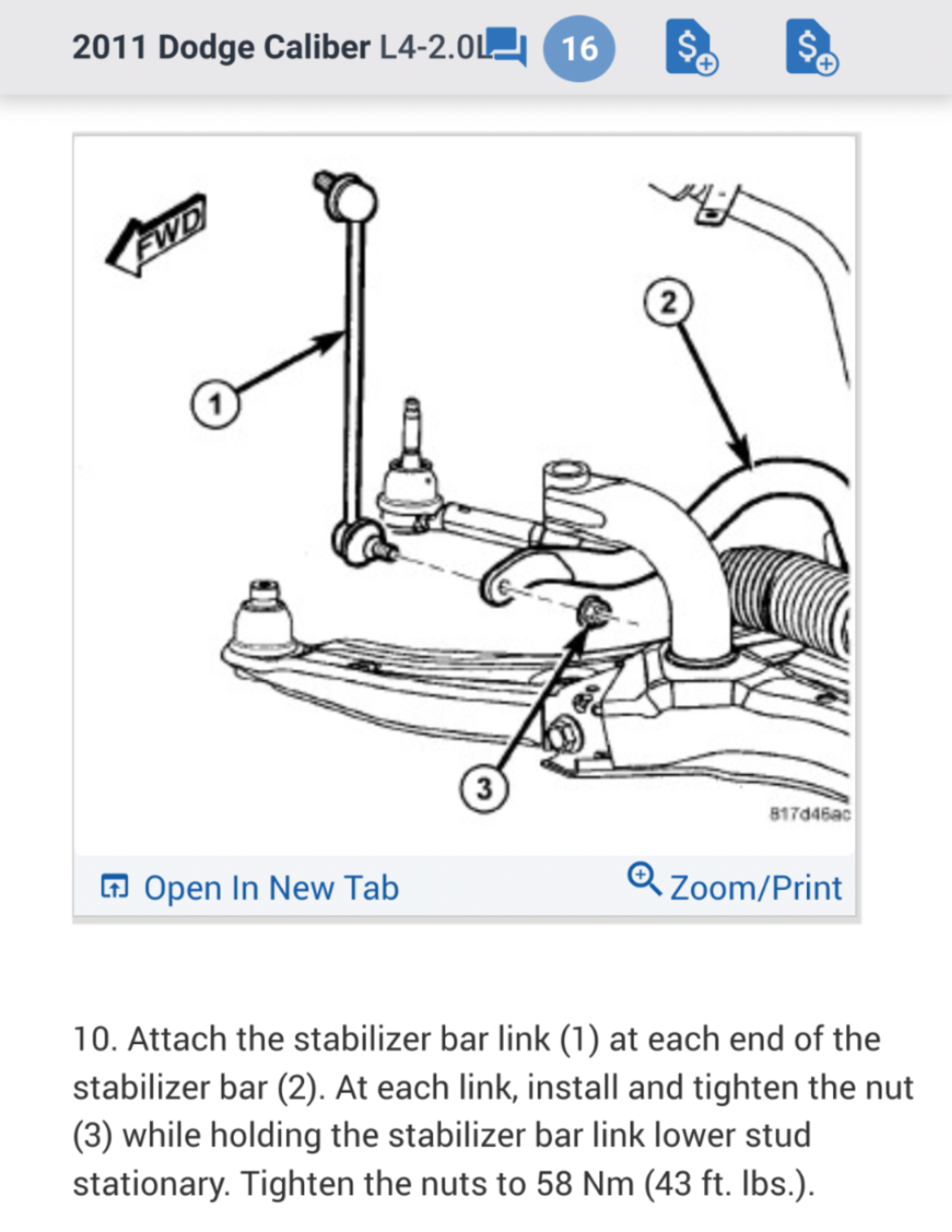

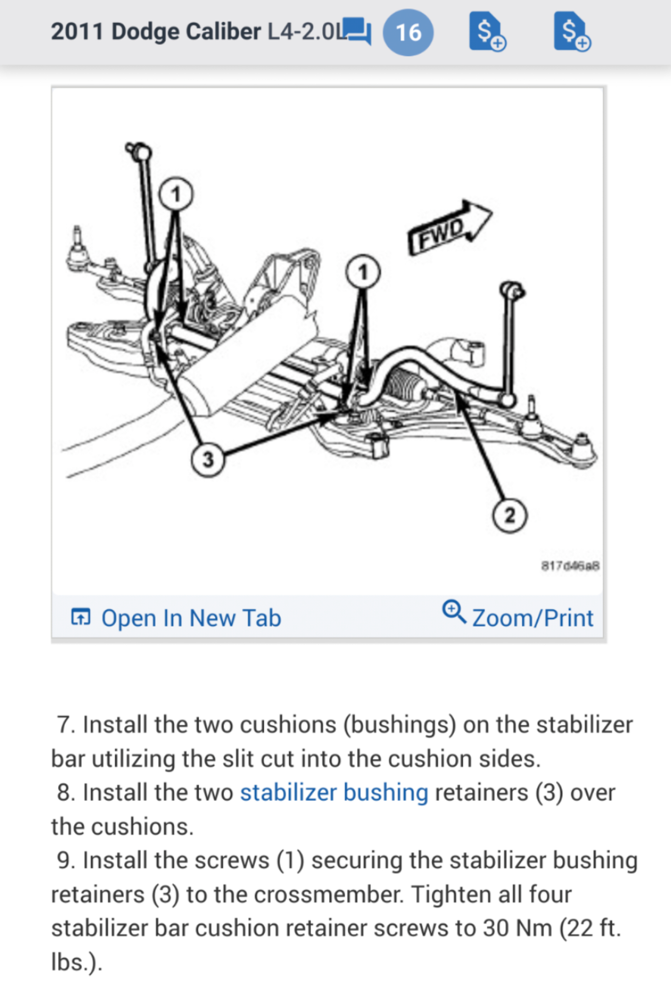

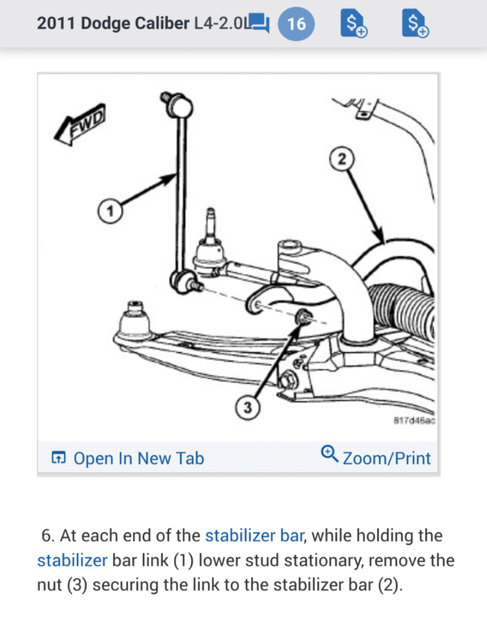

Hello. The best I could do was to find the instructions on replacing the stabilizer bar, which includes steps removing and reinstalling the bushings. It's a fairly straightforward job to do, so I suspect that you can do it.
Good luck and let us know how it goes.
May 21, 2021 at 8:43 PM
HKFROMNY.
  • 112 POSTS
From what i'm seeing, figure it, this whole removal step of cross member isn't needed, can can easily access the four bolts themselves (bushing bolt}?
May 22, 2021 at 1:40 AM
HARRY P
  • 2,292 POSTS
Yeah, I think you're right. I don't see why that cross member has to go anywhere for just the bushings.

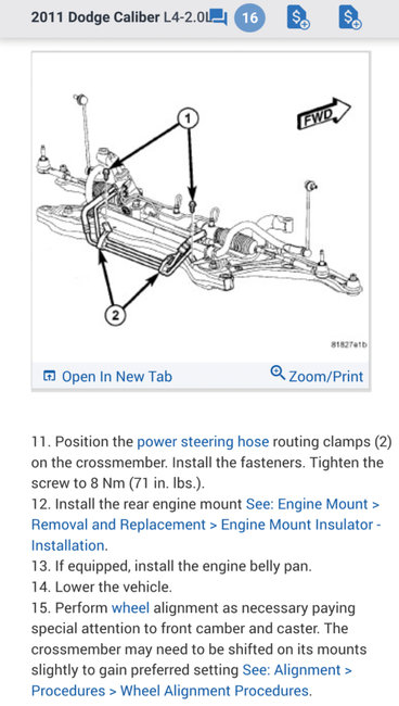

well, with further investigation, found out my bushings aren't the only cause of the noise, my rear motor mount is rusted away. got new from Rock Auto on the way. We'll see after they installed what's what.

Hey guys, all's well and good. Got the mount changed with the normal busted knuckles. Wanted to change the sway bar bushings but can't even get good access to the bolts. My local mechanic will have to do it, the subframe needs to be loosened to do it. As always, thanks for being there.
