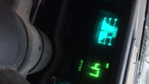

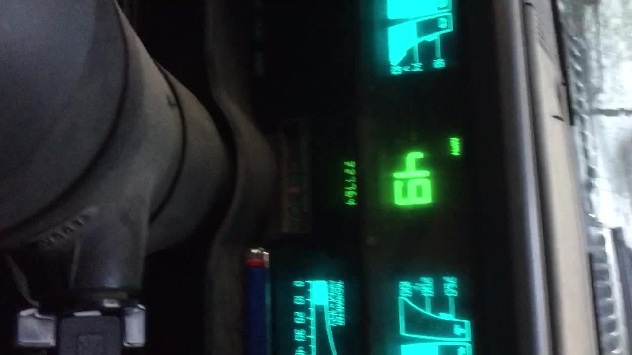

It only happens while driving. Any speed doesn’t matter... also it only does it when the steering wheel is slightly turned like when you are going around a curve not making a full blown turn. Its a loud thumping sound that you can feel under your feet when it happens. Doesnt seem to really be confined to one side of the truck more than the other(basically you can feel the thump about the same amount from driver or passeneger side). Have included a video, kinda hard to hear but the thumping you you hear about 3 seconds in is the sound. I did have someone suggest the crossmember may be bad?

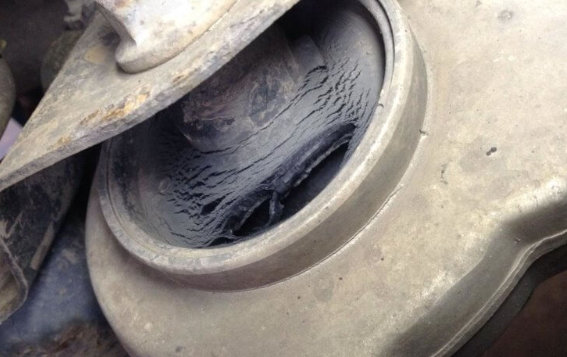

Yep. That is a bushing that is worn out. That deep thumping is the play between the different components and it sounds like a dampened or dead thump. Not a metal on metal because there is still rubber in between the two pieces of metal. Given enough time it will be more of a metallic snapping.
Problem is, there is no real way to tell you which bushing. Could be a mount or a suspension component or one in the steering system. Basically just climb under there and any bushing that looks cracked or worn needs to be replaced.
I attached a picture of a cracked bushing. Just do a google search for more examples. Again, anything questionable should be replaced.
