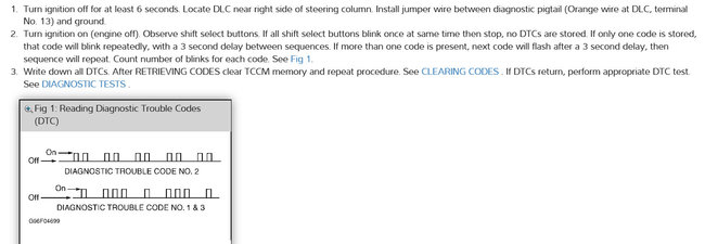

HMAC300
  • 48,601 POSTS
was it full of fluid or did you not check? do what is in picture and get back to us. although, it may be and sounds like it is an internal problem.

CHRIS FISCHER
  • 6 POSTS
Yes, fluid level good and no burnt smells, however there is a small leak, looks like oil, coming from the front "pumpkin".

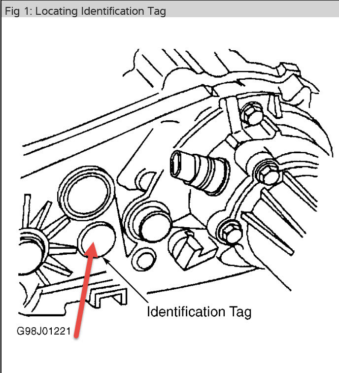

CHRIS FISCHER
  • 6 POSTS
I have four t-cases from other parts blazers. Question, can I replace my four button auto four wheel Dr with a third button four wheel drive that does not have auto. do I change the TCCM and/or cables/connectors? do I have to reprogram the brains together, etc? One of the extra t-cases my have the auto four wheel, but I do not know which one, how can I cross reference these to find the auto t-case out of the other t-cases? Thanks to all who have responded! Hope to return the favor to someone else in need. By the way: the Blazers were scraped, only kept parts, so I do not have the VIN number's.

HMAC300
  • 48,601 POSTS
go by the ID tag at back of case. it should be same number either a NV233-236 etc. otherwise you will have problems. See picture.

STEVE W.
  • 15,415 POSTS
Have never looked at swapping the Auto T-case. I think you would need to swap a lot of parts. The T-case, TCCM, wiring harness, switch are all different. Then there are the extra speed sensors and a different ABS system. The BCM is different as well as different ECM programming for the auto controls.
The auto box will be a NV 236.
