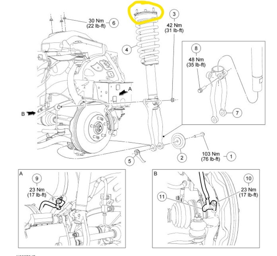

While driving at slower speeds and on slightly uneven ground, there's a clunking sound like something is broken. I've looked under the car and visually nothing seems broken or loose. I've been hitting around with a rubber mallet, and nothing sounds out of place. I recorded a video of me driving and you can hear the sound. Any ideas?
Btw I've had the motor, transmission and torque strut mounts replaced not that long ago.

I checked them and they seem fine. However, I did notice that when I push down on the front of the car and it bounces, it makes that sound every time. Could it be the front struts?

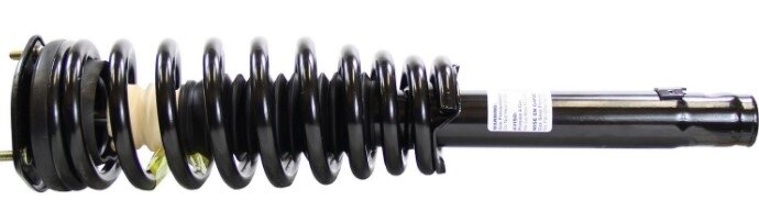

Yes, top strut mounts can make a clunk if they are worn. If the mounts are worn that amount you might want to look at quick struts, they include the strut, the mount and new springs all in one unit. They are much easier to deal with and even the OEM Ford parts are cheaper when bought as complete units than buying individual pieces. They are also not hard to change, you basically jack the vehicle up, put jack stands in place then remove the tires. Then place a jack under the steering knuckle and just take up a bit of weight. Then you loosen the pinch bolt (8) and remove the top three nuts (6). Next you lower the jack just a bit and I use a bar to spread the ears that the pinch bolt was clamping, then the strut pulls out of the fork and the bolts drop out of the top. To get more room it's not a bad idea to remove the speed sensor wiring and unbolt the caliper so that the wires and hoses don't stretch. Then you reverse the process to install the new parts.

I just replaced both front struts, the complete units with strut mounts, and while the sound has been reduced, it's still there, intermittently. What else could it be?
