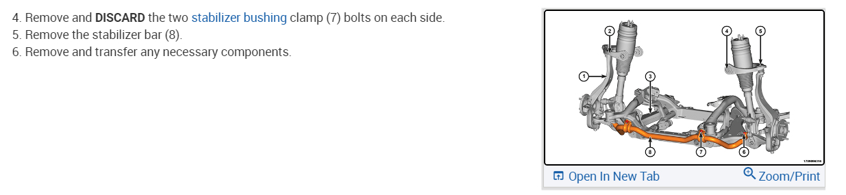

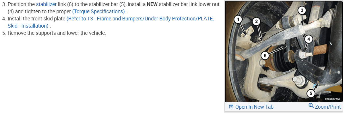

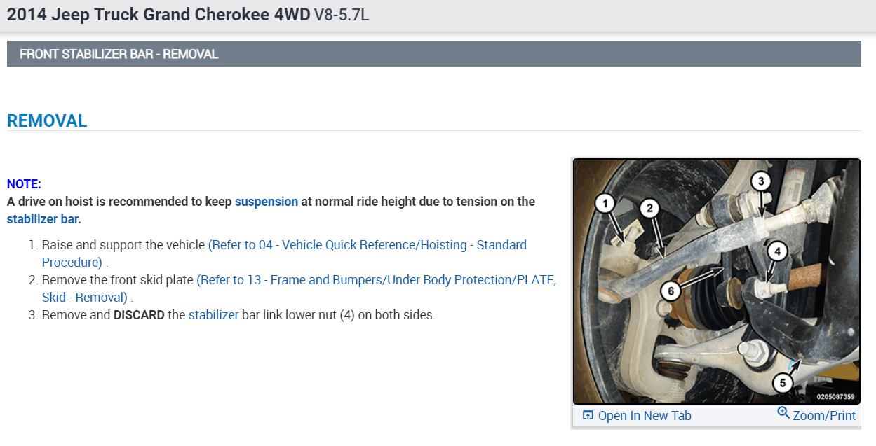

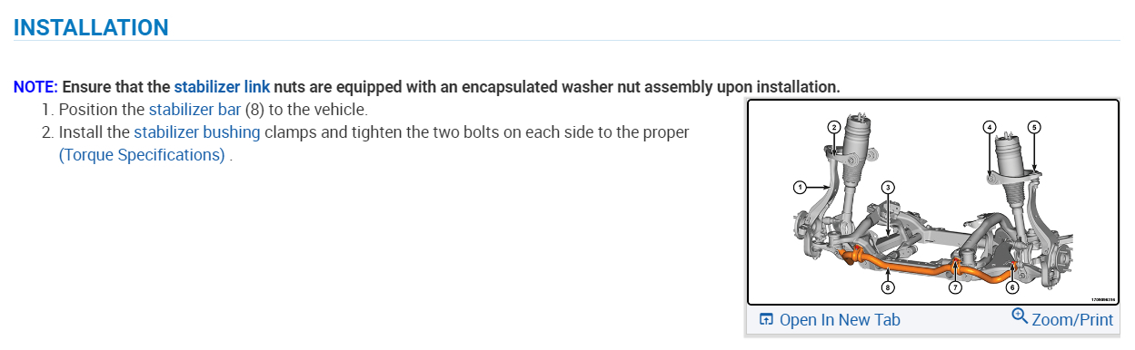

It sounds like the sway bar links or swap bar mount bushings are worn out which is common in these cars. Can you please shoot a quick video with your phone so I can hear the noise? That way I can tell for sure what's going on. You can upload it here with your response. Here is how to change them out. Check out the images (below). Let us know what happens and please upload pictures or videos of the problem so we can see what's going on.
