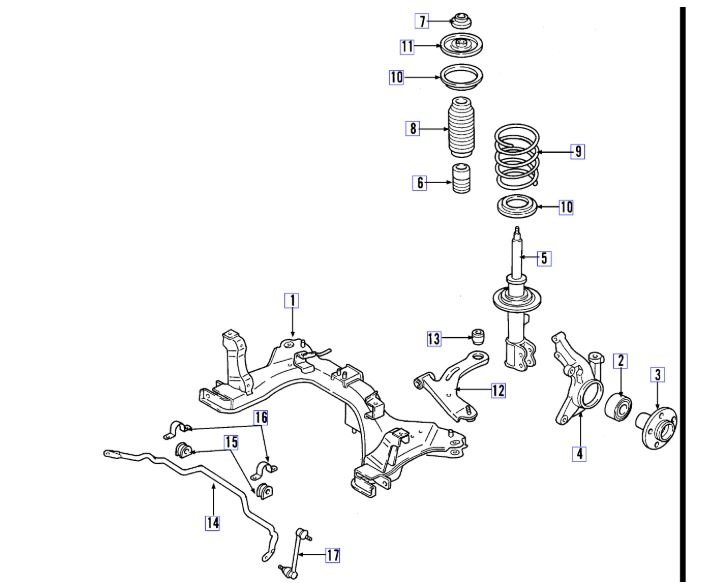

There is a clunking noise when I turn left out of my driveway and any time I have to make a sharp turn.
Tuesday, October 30th, 2018 AT 9:26 AM
MECHANIC
52,796 POSTS
Good afternoon.
It could be several things.
1. Engine mount shifting from too much play.
2. Strut mount or worn strut.
3. Stabilizer link kit loose or broken.
4. Lower control arm bushing is worn.
5. Lower ball joint.
5. Axle shaft joint whether inner or outer worn.
Image (Click to make bigger)
