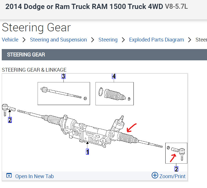

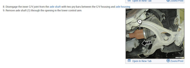

Hear a clunking noise when going about 35 MPH and also a vibration in the tires and a pull but checked the outer tie rod there’s play when you move the steering wheel in and out but there’s also what looks it was leaking at the output shaft for the cv axle and what I feel and see looks like play in it but i don’t know if this is normal.

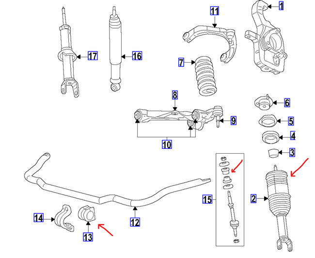

Thanks for the video, it helps. It is difficult to tell if the axle is bad, they do have play naturally and it seems to be okay but you never know until you take them part to check for wear or replace them. You said there is play in the steering wheel as well? I would raise the front of the truck and use a flashlight while a helper is moving the steering wheel back and forth a little bit while you look for play, I have marked the common places to look for this kind of problem.
Please check out this guide as well:
https://www.2carpros.com/articles/popping-noise
Check out the images (below). Please upload pictures or videos in your response of any problems so we can see what to help you with.

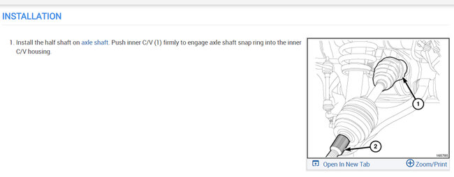

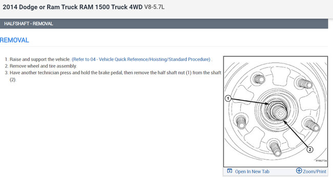

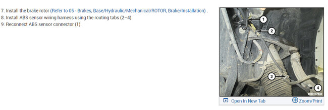

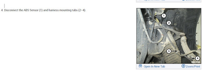

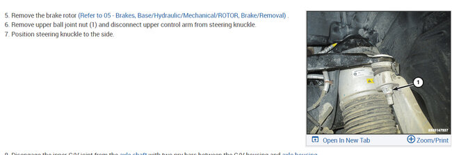

Yep, that is too much play, good find, here is how to change the CV axle out. Thanks for the videos they helped. Check out the images (below). Let us know how it goes.
Oct 6, 2024 at 11:09 AM

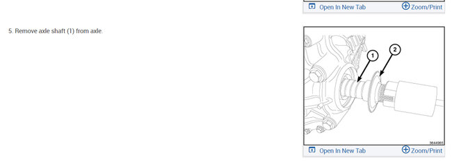

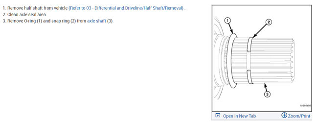

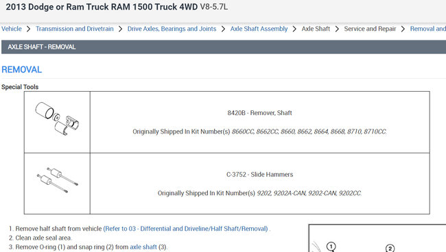

I saw on these that the output shaft gets destroyed from rust both sides has this play on them.
Oct 6, 2024 at 11:13 AM
SKOOTER28
  • 98 POSTS
The CV axle has played but that up and down is coming from the output shaft I think all the rust and water has gotten into the splines like I’ve seen on videos of these and now it’s wearing down the CV axle shaft itself.
Oct 6, 2024 at 11:17 AM
SKOOTER28
  • 98 POSTS
But i know the dealer doesn’t sell these parts separately I don’t want to have to buy a whole front diff housing or whatever this thing is called.
Oct 6, 2024 at 11:20 AM
  • 55,781 POSTS

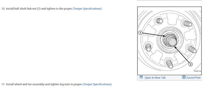

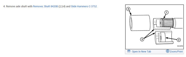

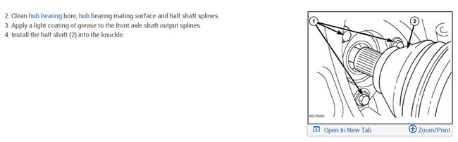

Yep, they sell a stub axle, which can be pulled out much like the CV axle, here is how to do the job. Check out the images (below). Please let us know what happens.
Oct 7, 2024 at 1:42 AM
