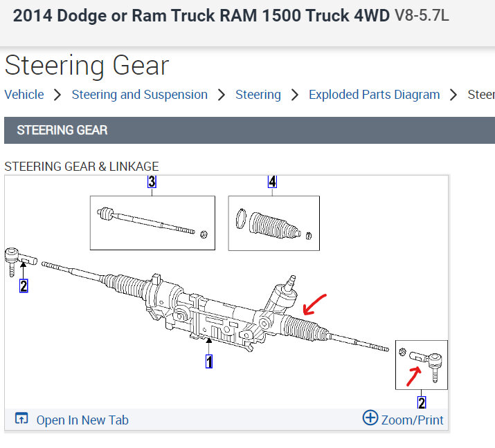

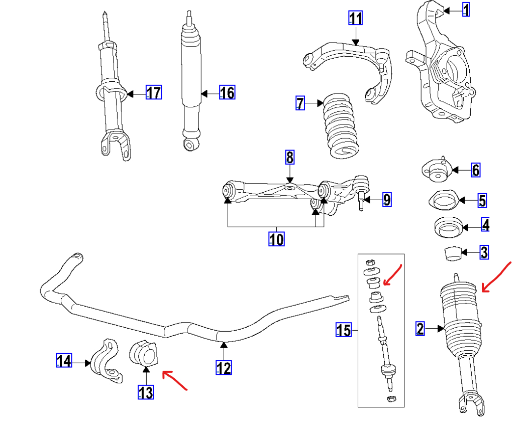

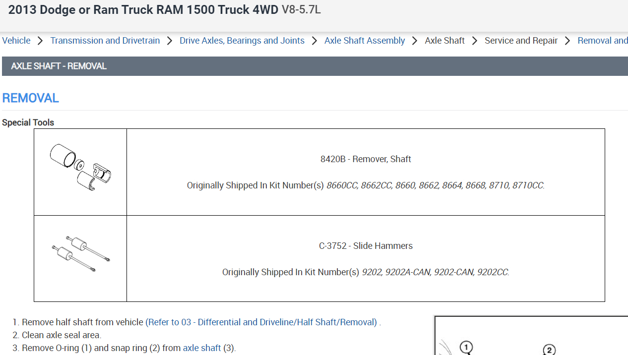

Thanks for the video, it helps. It is difficult to tell if the axle is bad, they do have play naturally and it seems to be okay but you never know until you take them part to check for wear or replace them. You said there is play in the steering wheel as well? I would raise the front of the truck and use a flashlight while a helper is moving the steering wheel back and forth a little bit while you look for play, I have marked the common places to look for this kind of problem.
Please check out this guide as well:
https://www.2carpros.com/articles/popping-noise
Check out the images (below). Please upload pictures or videos in your response of any problems so we can see what to help you with.

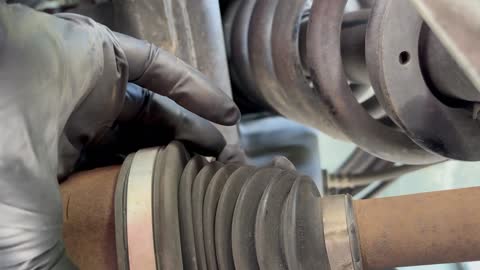

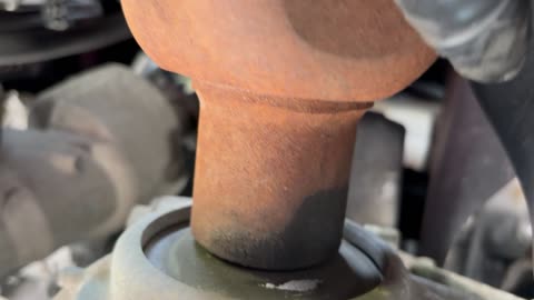

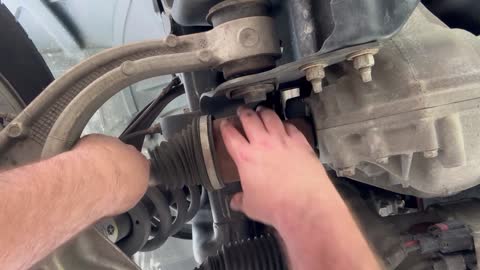

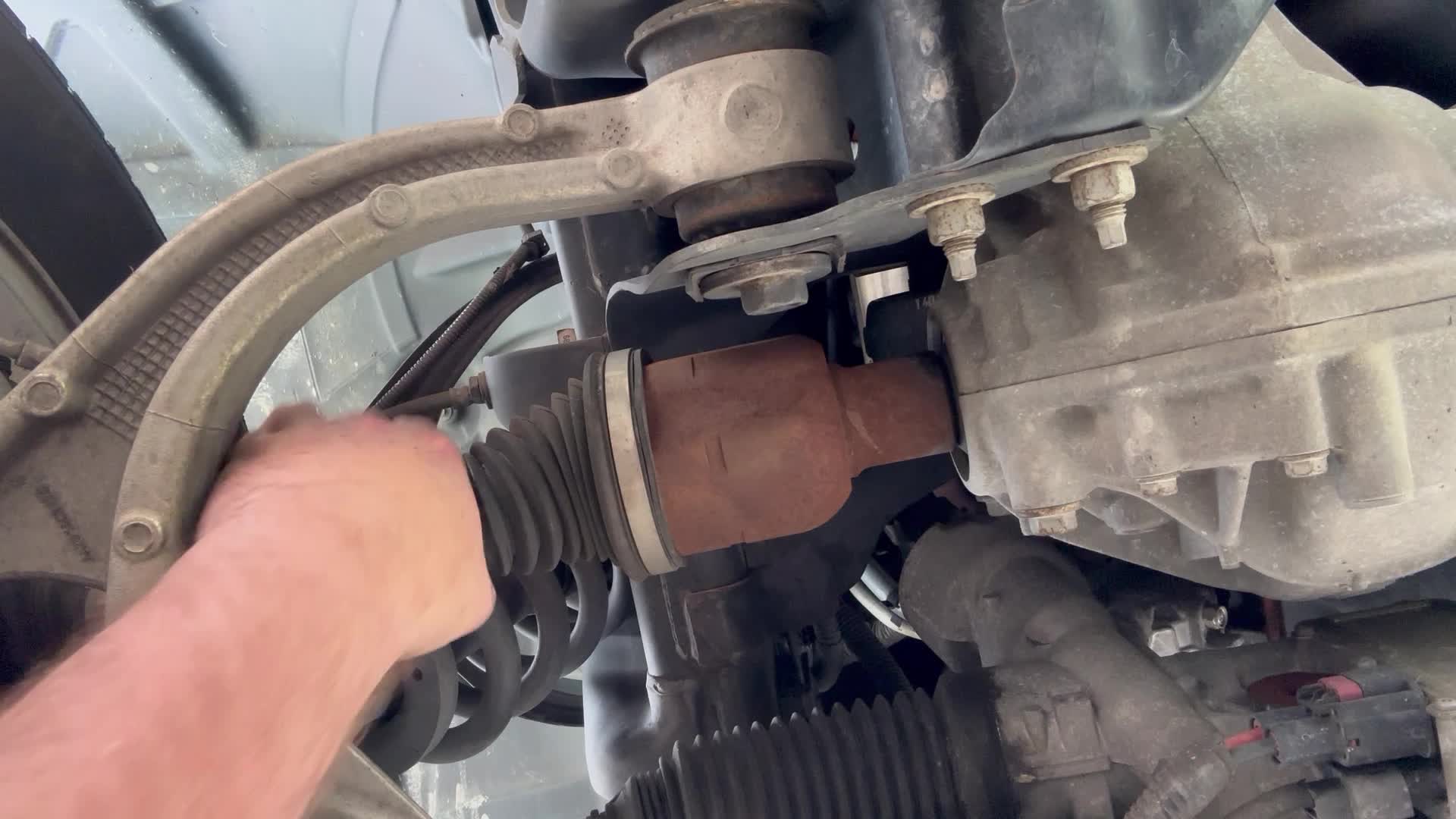

The shaft I’m holding doesn’t move when rotating the part where the clip is, but the other side is tight and moves together but also what concerns me is that the CV axle that slides on the output shaft has up and downplay and you can hear it and see it.
Oct 5, 2024 at 5:58 AM
SKOOTER28
  • 98 POSTS
But the other side the CV axle hasn’t worn like the driver side has but the where the axle slides on the output shaft has up and downplay it almost slid out but I do not know if that’s supposed to happen but I see on a lot of videos this seems to be an issue with this truck.

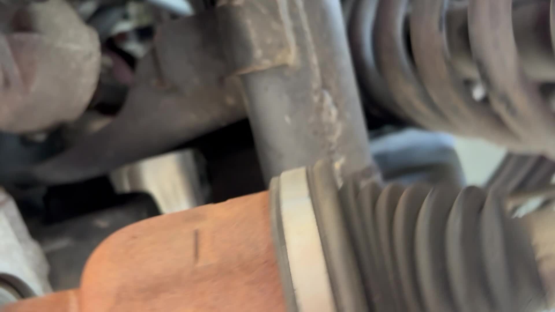

This up and down play.
Oct 5, 2024 at 6:32 AM

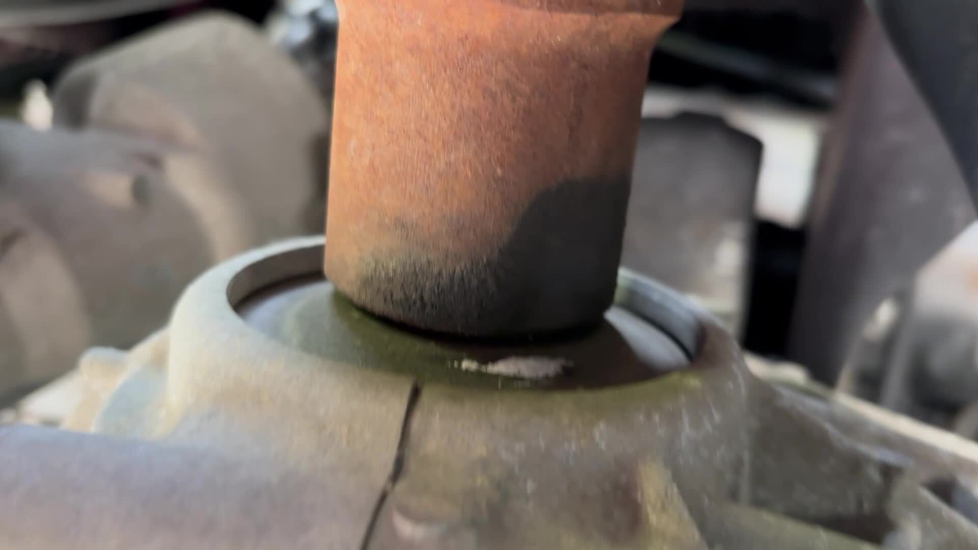

Here it looks like it’s been leaking.
Oct 5, 2024 at 6:36 AM

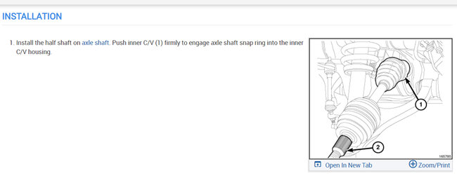

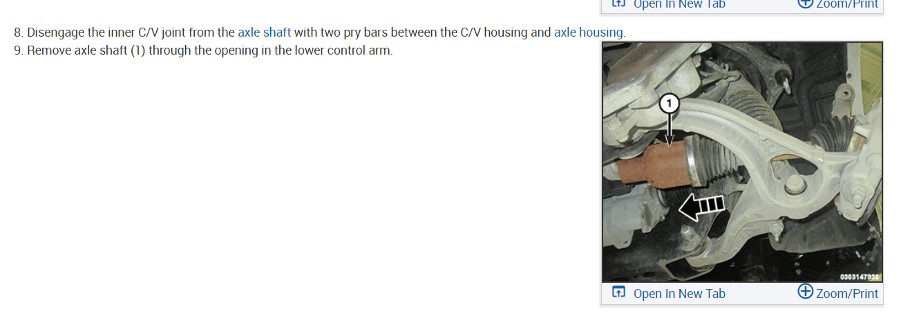

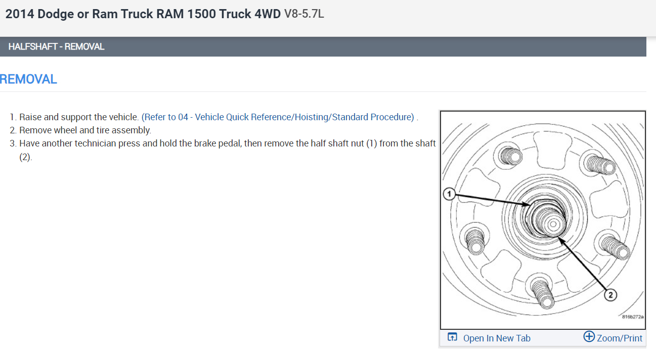

  • 55,447 POSTS

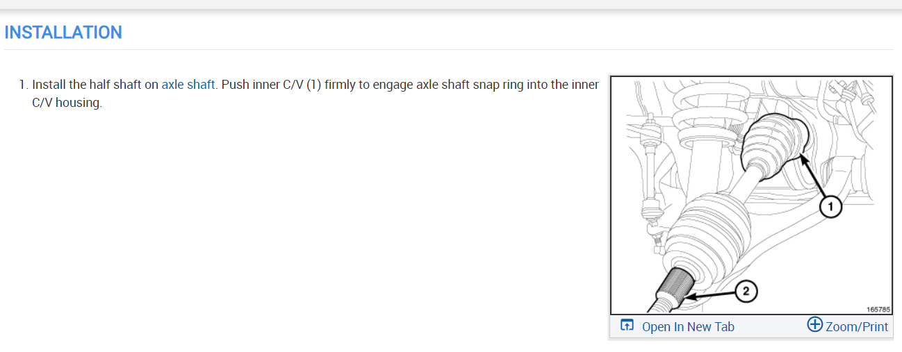

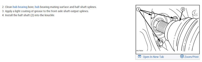

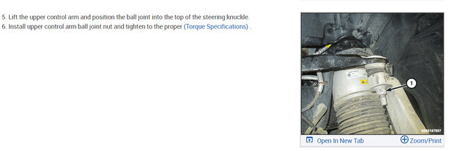

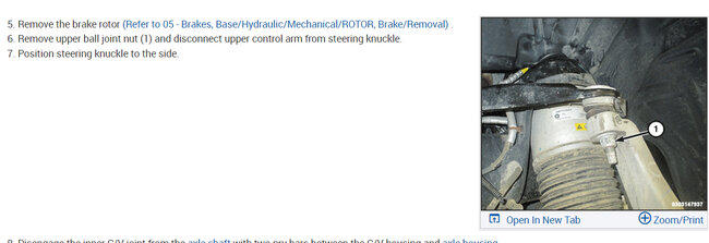

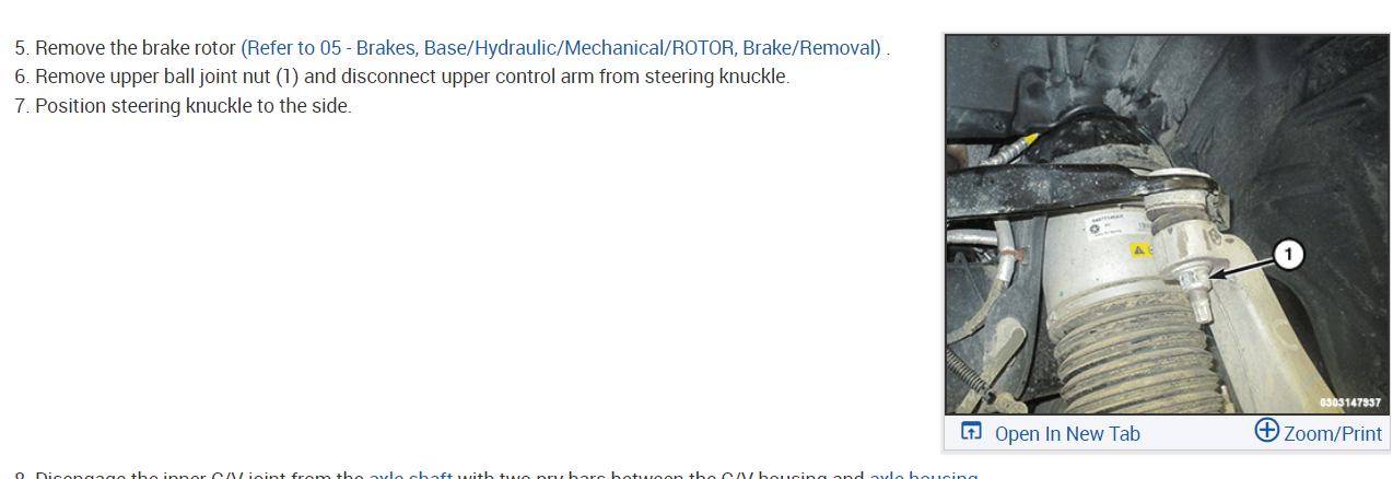

Yep, that is too much play, good find, here is how to change the CV axle out. Thanks for the videos they helped. Check out the images (below). Let us know how it goes.

I saw on these that the output shaft gets destroyed from rust both sides has this play on them.
Oct 6, 2024 at 11:13 AM
SKOOTER28
  • 98 POSTS
The CV axle has played but that up and down is coming from the output shaft I think all the rust and water has gotten into the splines like I’ve seen on videos of these and now it’s wearing down the CV axle shaft itself.
Oct 6, 2024 at 11:17 AM
SKOOTER28
  • 98 POSTS

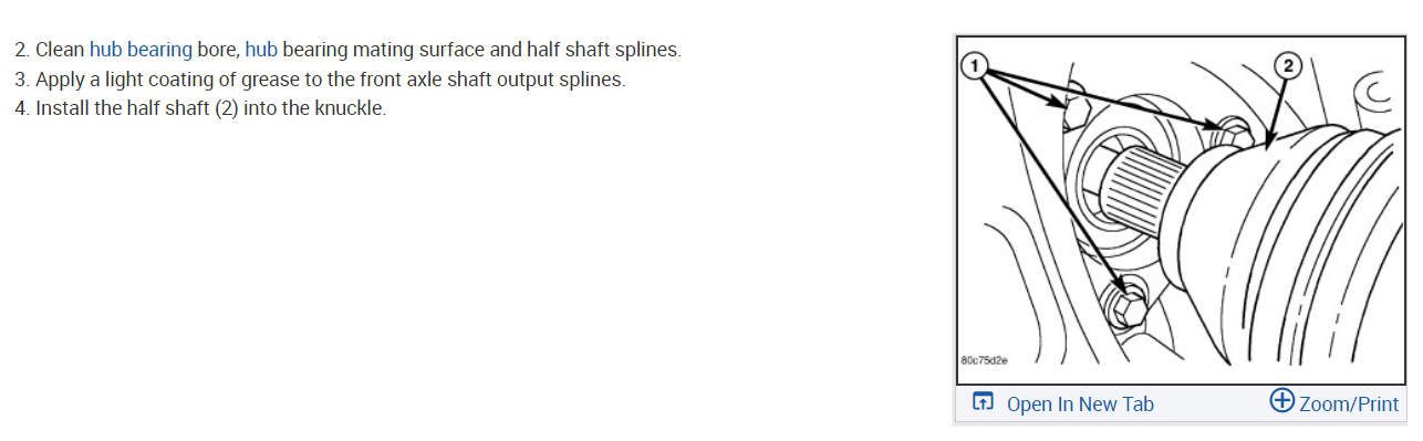

But i know the dealer doesn’t sell these parts separately I don’t want to have to buy a whole front diff housing or whatever this thing is called.
Oct 6, 2024 at 11:20 AM

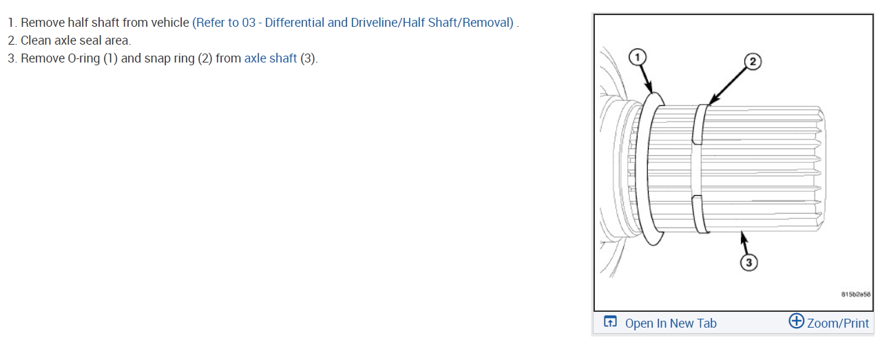

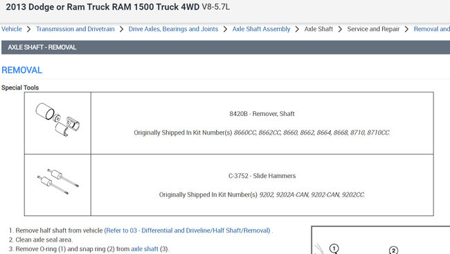

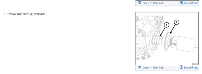

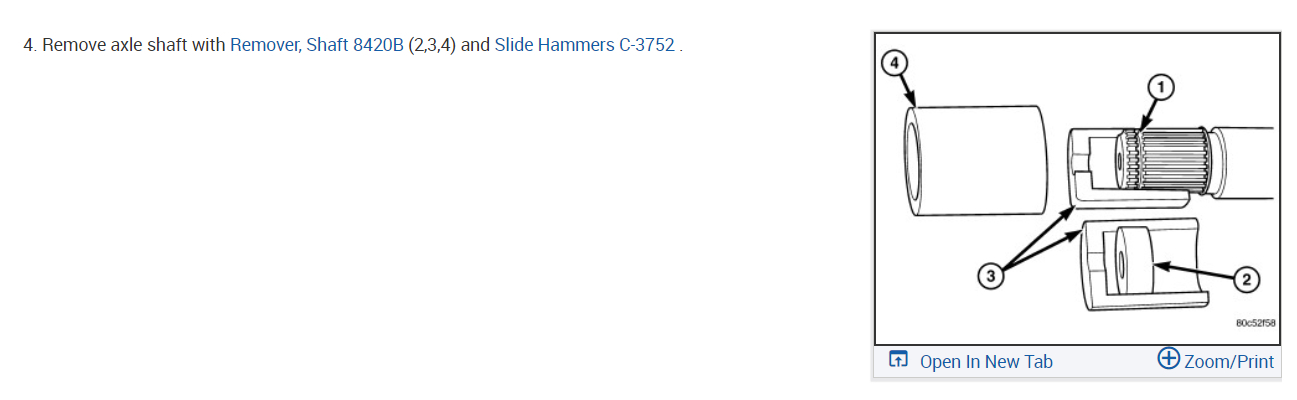

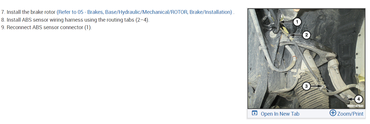

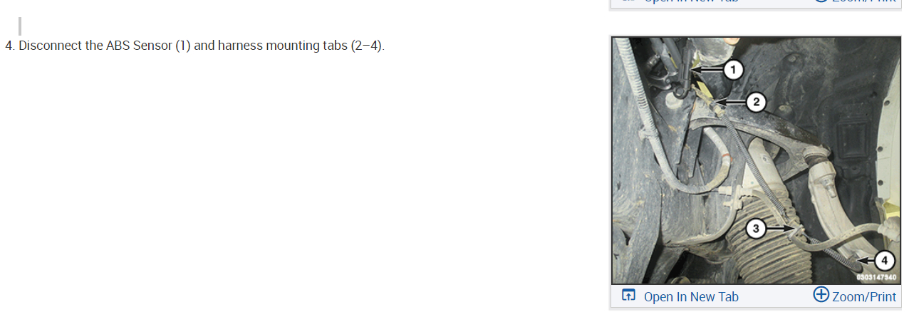

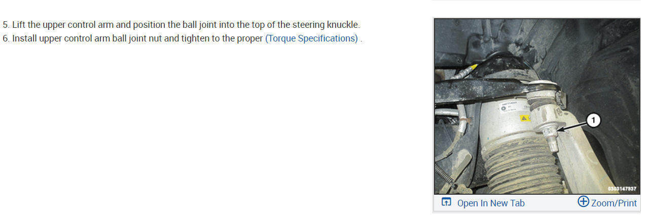

  • 55,447 POSTS

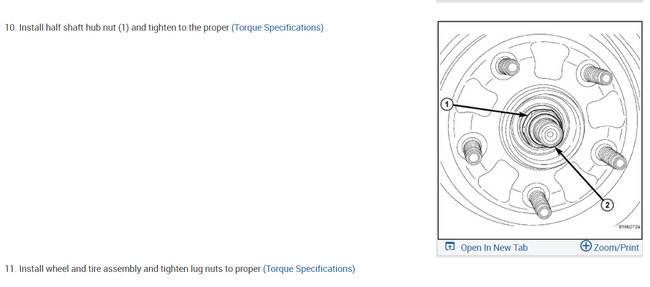

Yep, they sell a stub axle, which can be pulled out much like the CV axle, here is how to do the job. Check out the images (below). Please let us know what happens.
