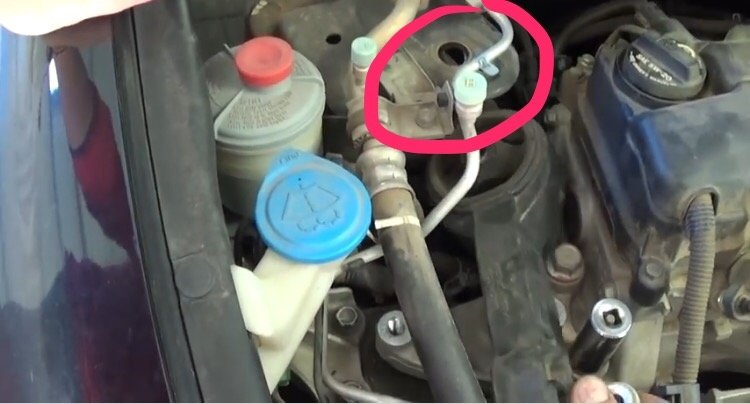

This is what a normal hole for the upper dog bone motor mount looks like(circled in red),the hole in my car looks like a stretched out circle(oval). If that's the case does anyone know if that's part of the frame and the only way to fix it is to replace that metal part of the frame?

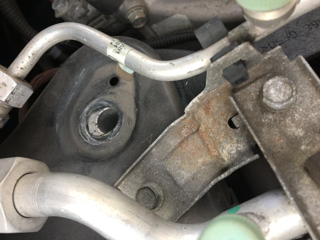

This is what mine looks like, finally just took the mount off for a picture

That is what it should look like, make sure the bolt is tight and you should be fine, if the bolt was loose it would make the noise you were talking about.
Please let us know what happens so it will help others
Best, Ken

The problem was a cracked bushing on the front left lower control arm.
