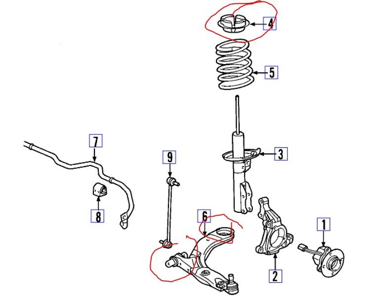

There's a clunking noise and pulls to the left and if let go of steering wheel it jerks to the left real hard.
Jan 27, 2021 at 8:13 AM
Good morning,
I would have the suspension checked as soon as possible. There are common points of failure with the noises and I circled them in the diagram I attached.
https://www.2carpros.com/articles/lower-control-arm-bushing-replacement
https://www.2carpros.com/articles/replace-shock-absorber
The struts are also common when they are worn out and the suspension is not level anymore.
https://www.2carpros.com/articles/popping-noise

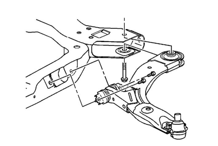

Lower Control Arm Replacement
Removal Procedure
1. Raise and support the vehicle. Refer to Vehicle Lifting.
2. Remove the wheel.
3. Notice: Do not free the ball stud by using a pickle fork or a wedge-type tool. Damage to the seal or bushing may result.

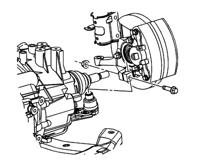

Remove the ball stud to steering knuckle pinch bolt and nut.
4. Separate the ball stud from the steering knuckle.
5. Remove the rear frame bolt.
6. Remove the control arm-to-frame bolts.
7. Remove the control arm from the frame.

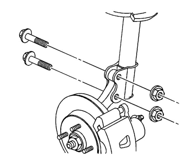

Strut Assembly Replacement
Removal Procedure
2. Remove the front wheel.

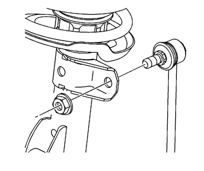

3. Disconnect the stabilizer link from the strut.
4. Remove the strut to steering knuckle nuts.
5. If applicable, reposition the wheel speed sensor harness and bracket.
6. Remove the strut to steering knuckle bolts.

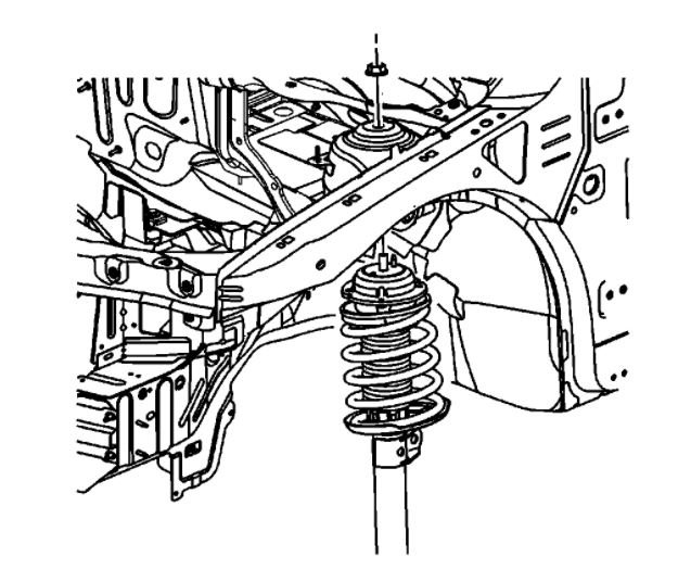

7. Remove the upper strut cap to body nut.
8. Important: In order to prevent damage to the CV joint boot, place a shop towel over the CV joint.
Remove the strut from the vehicle.
9. For strut replacement, refer to Strut, Strut Component and/or Spring Replacement.
