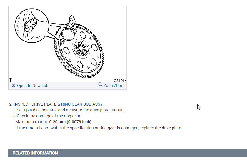

This is almost always a mount issue. So when you say you replaced the engine and transmission mount, was this all of them?
https://www.2carpros.com/articles/replace-motor-mounts
If the mounts are not the issue then the next likely issue is a possible RPM issue. Where does the vehicle idle?
Then we need to check the suspension components including the control arms
https://www.2carpros.com/articles/lower-control-arm-bushing-replacement
https://www.2carpros.com/articles/upper-control-arm-replacement

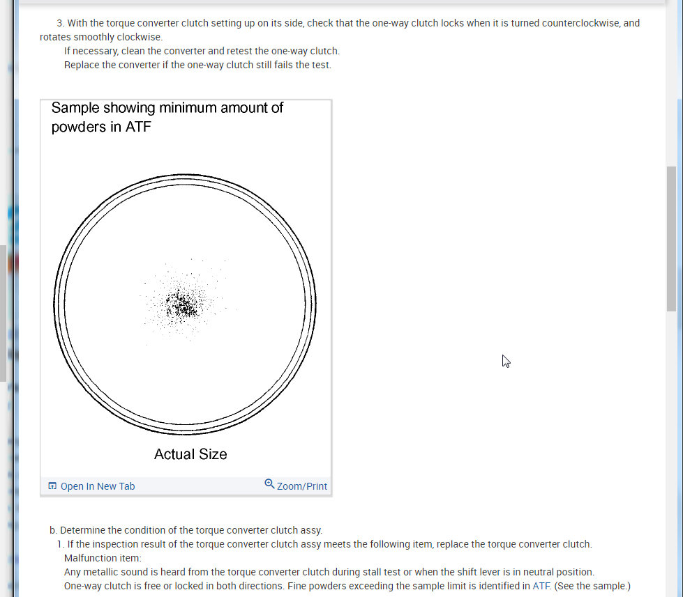

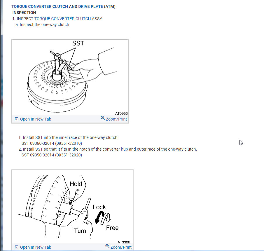

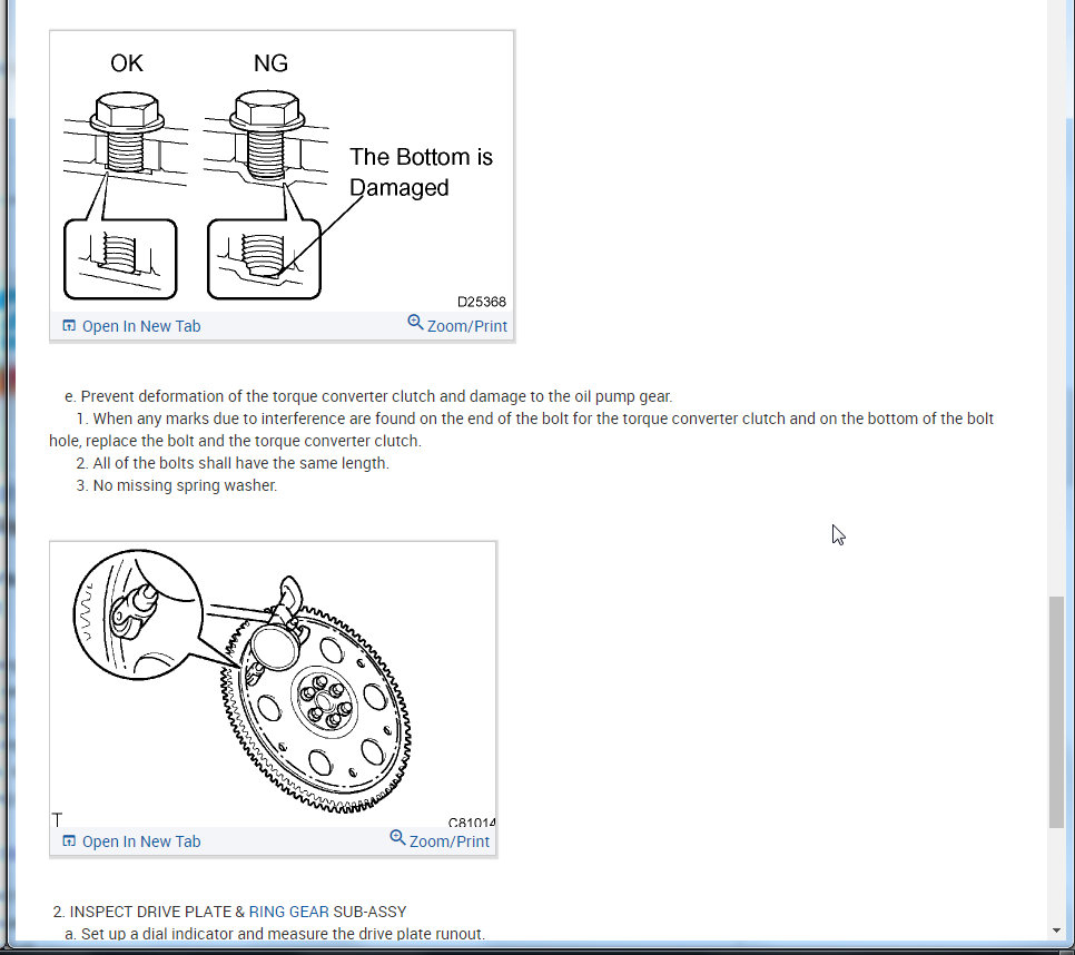

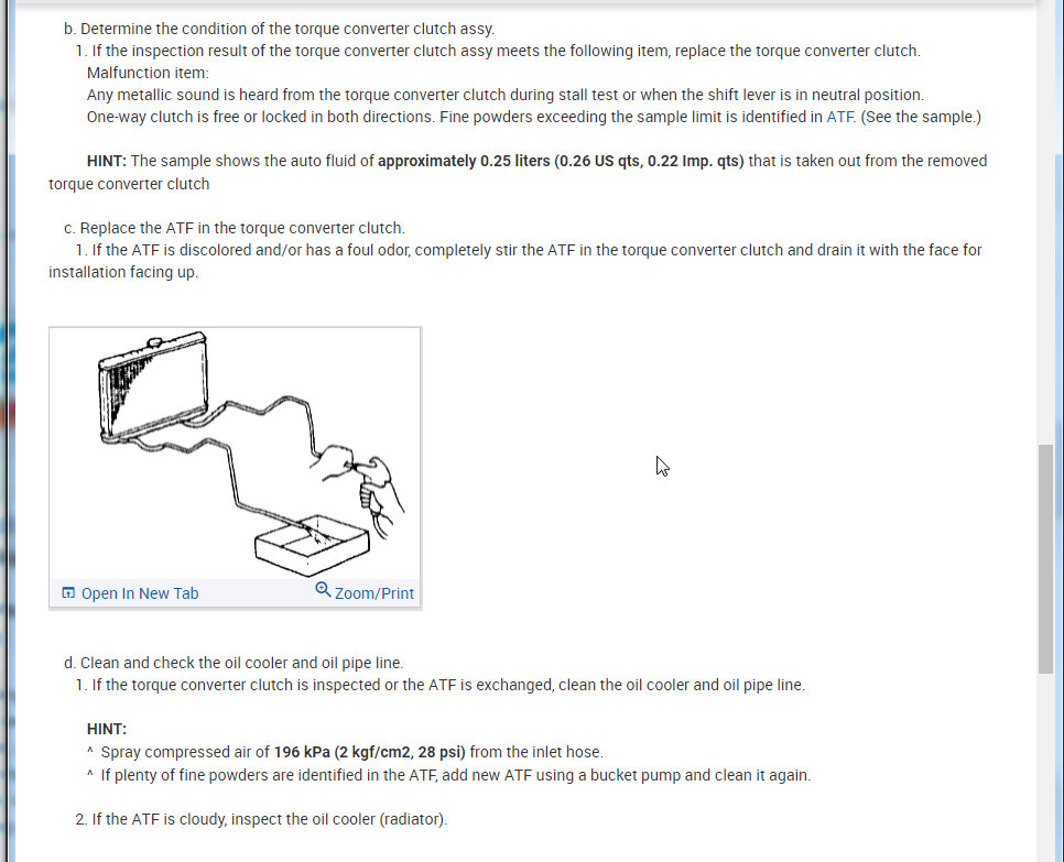

Also, we need to suspect a possible torque converter/pump issue if this all checks out.
I included testing below but this requires removing the converter which is clearly not fun without more proof so let's start with this other info first.
