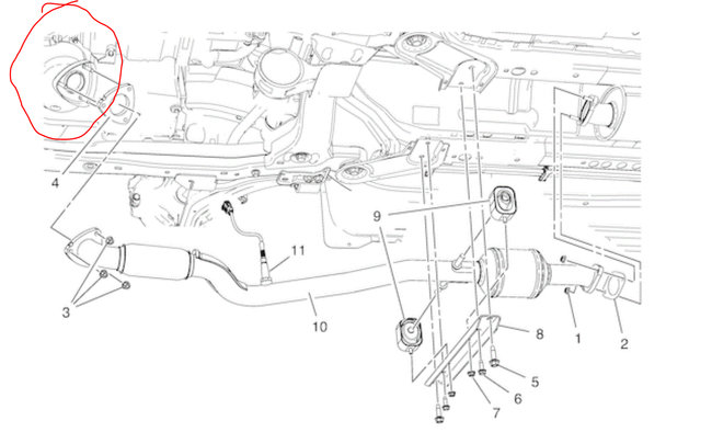

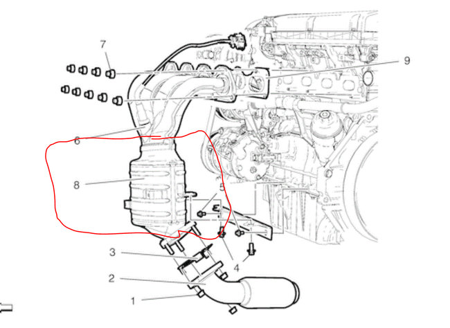

I attached two pics below. They show the catalytic converter from two points of view. The converter on this vehicle is part of the exhaust manifold. You can see it best from under the hood of the vehicle. It's tough to see from the underside unless the vehicle is lifted.
Do me a favor. After driving it and before you turn it off, open the hood and inspect the converter. If it is plugged, often times it will be glowing red hot.
Also, let me know if you have noticed a loss in power.
