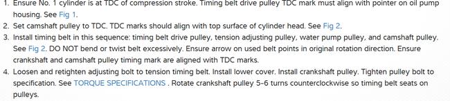

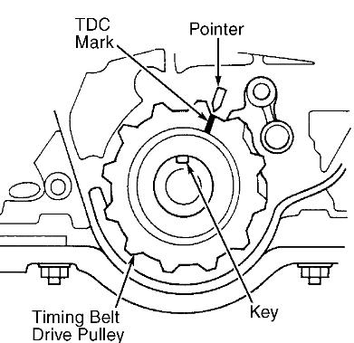

After replacing cylinder head gasket and resetting TDC at tension pulley for timing belt heard clucking sound because car would not idle when starting it
Mar 10, 2015 at 8:27 AM
HMAC300
  • 48,601 POSTS

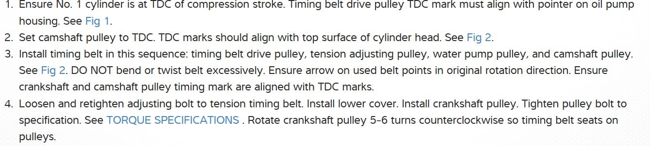

you have to set cam as well as tdc you may have bent valves now. instructions are for a 1.6L Check out the images (below). Let us know if you need anything else.
