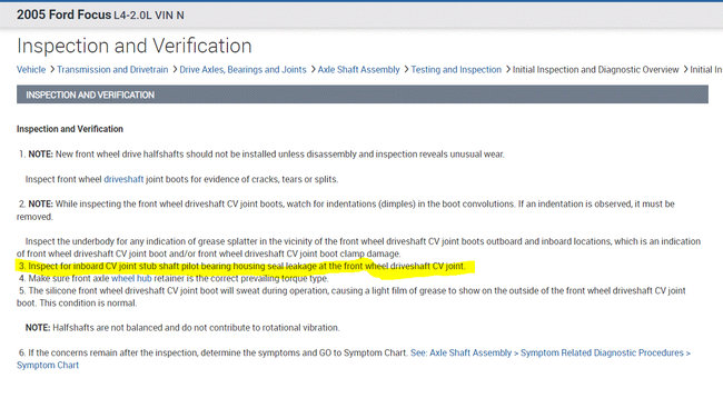

When I go from R to D it goes into gear hard and sometimes makes a clunking noise. It doesn't slip going down the road. I think there is a leak around the inner CV or some where else.
Aug 21, 2021 at 9:44 AM
  • 110,244 POSTS
If you hear a clunk, there could be an issue with one of the CV joints. Take a look through this link. It explains how a CV joint works.
https://www.2carpros.com/articles/how-a-cv-joint-works

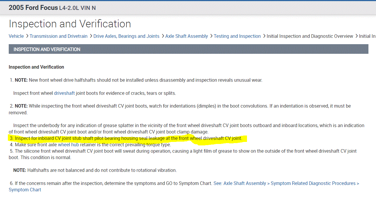

Let's start there. I'm suggesting this because if you noticed a leak at the transmission, where the axle goes into it, a bad inner joint could cause the seal to fail.
I attached some basic checks below in pic 1. Take a look through them and let me know what you find.

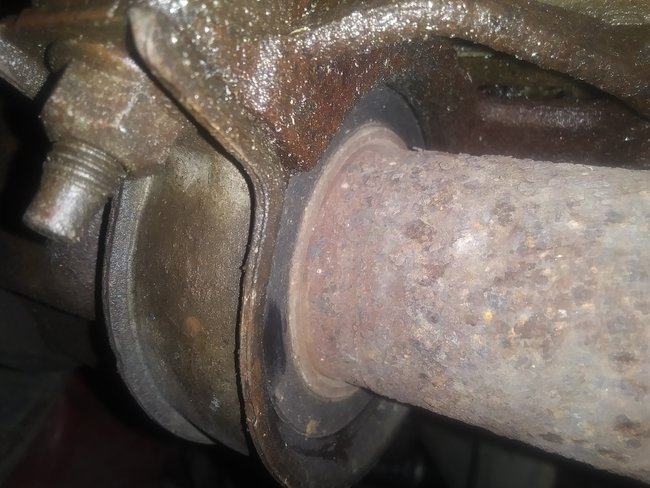

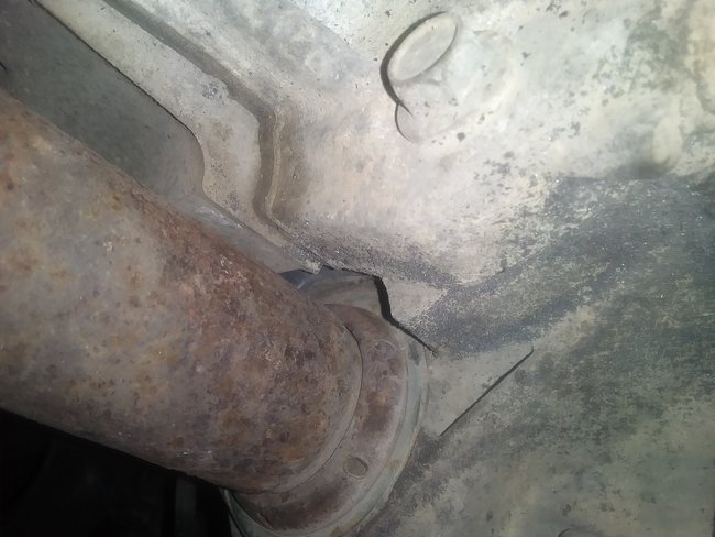

Okay, my transmission is you going into drive and reverse kind of hard and that's one the right side. Well, the passenger side is making the noise while going down the road. Can't tell if it's a wheel bearing or it is the CV going bad. My boots are fine on the CV's.
Aug 23, 2021 at 7:36 AM (Merged)
  • 110,244 POSTS
I can't tell by looking at the pics. However, there is a difference between a bad CV joint and a bad wheel bearing.
In most cases, a bad wheel bearing will make a howling noise. A CV joint will make a clicking when making sharp turns. Also, if the CV joint is very bad, it can clunk when shifting gears.
If I'm correct, the second pic is of the intermediate shaft. If that bearing is bad, you should be able to move it around when there is no load on it. Place the parking brake on and block the wheels so the car can't move. Place the vehicle in neutral to remove any load on that bearing and see if there is play in it.
Let me know what you find.
