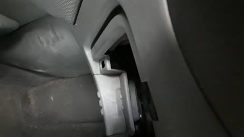

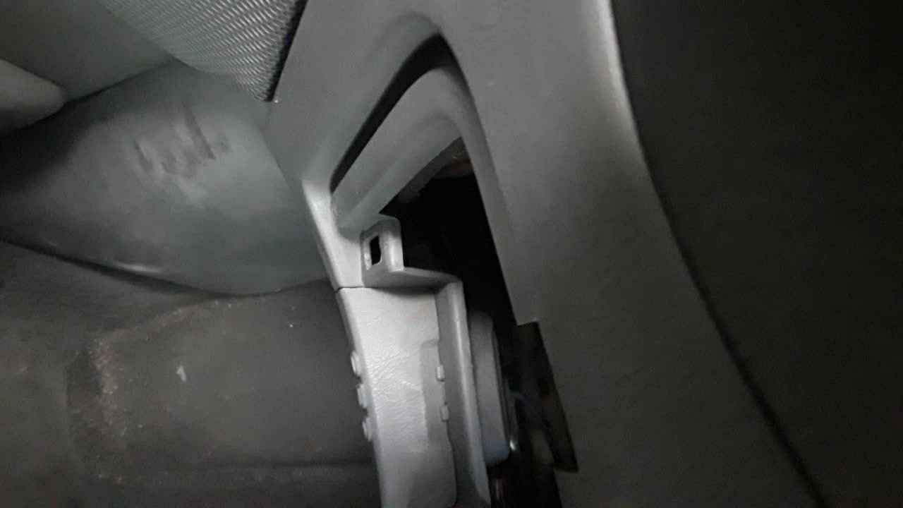

I have a video of the clicking.
Apr 10, 2020 at 3:29 PM
That clicking sounds like a relay clicking. It looked like you were under the dash so can you locate the relays under the dash and put your finger on each of them and then get the clicking to occur and see if you can feel it clicking. Most likely the relay itself is the issue for the clicking.
