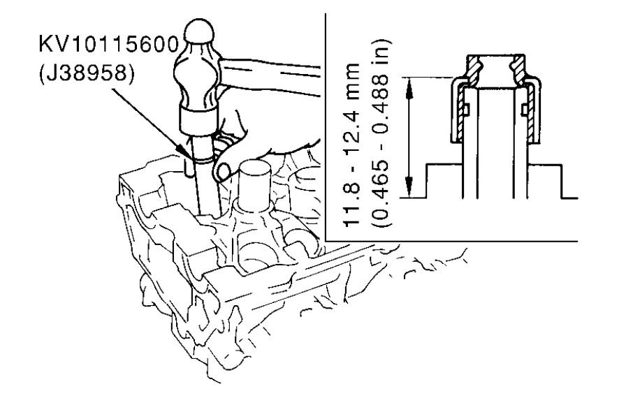

No, most likely it is valve seals. When they are bad, oil goes down the stem of the intake valve and settles into the cylinder on an overnight sit.
When you start it up, the oil burns off and does not smoke again until the next start with a long sit time.
