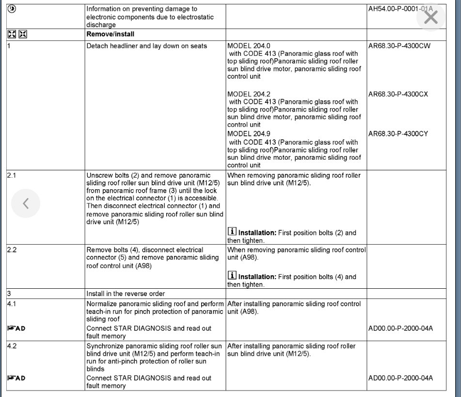

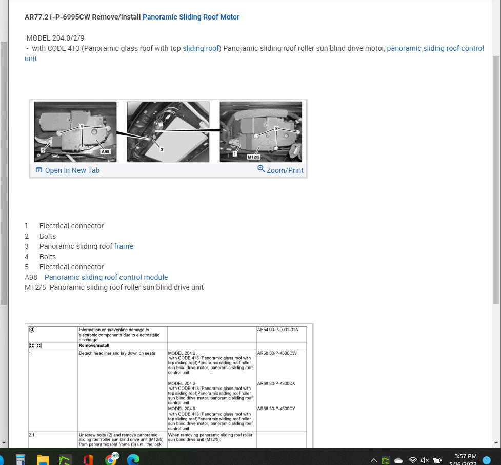

How to manually close roof if power motor stuck?
May 15, 2022 at 3:24 PM
  • CAR REPAIR CONTRIBUTOR

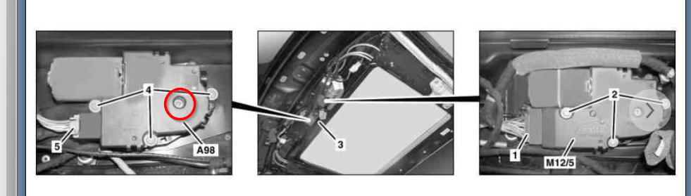

Normally on all these motors they have an allen key that you are able to turn so that you can manually turn the motor when it fails. The only time this doesn't work is when the motor internally is locked up. So, if this is locked then you are going to have to remove it and then try and slide the window by hand.
So, in other words, the allen key only works when there is an electrical issue for the motor or the windings in the motor have failed. When it locks up then it is not much use at all but worth trying.
I attached the info below on replacement and it appears this does have an allen key.

Mine has a sunroof not a panoramic roof, does that make a difference?
May 16, 2022 at 4:08 PM
No. The moveable part of the moonroof and panoramic moonroof is the same motor.
So that should be everything you need for this motor.

Removed the overhead light and removed motor, barely moves while its out and under no load.
May 21, 2022 at 2:48 PM
Thanks again for updating us with your findings. Sounds like you need a motor and as always, I am sure this is going to help others.
