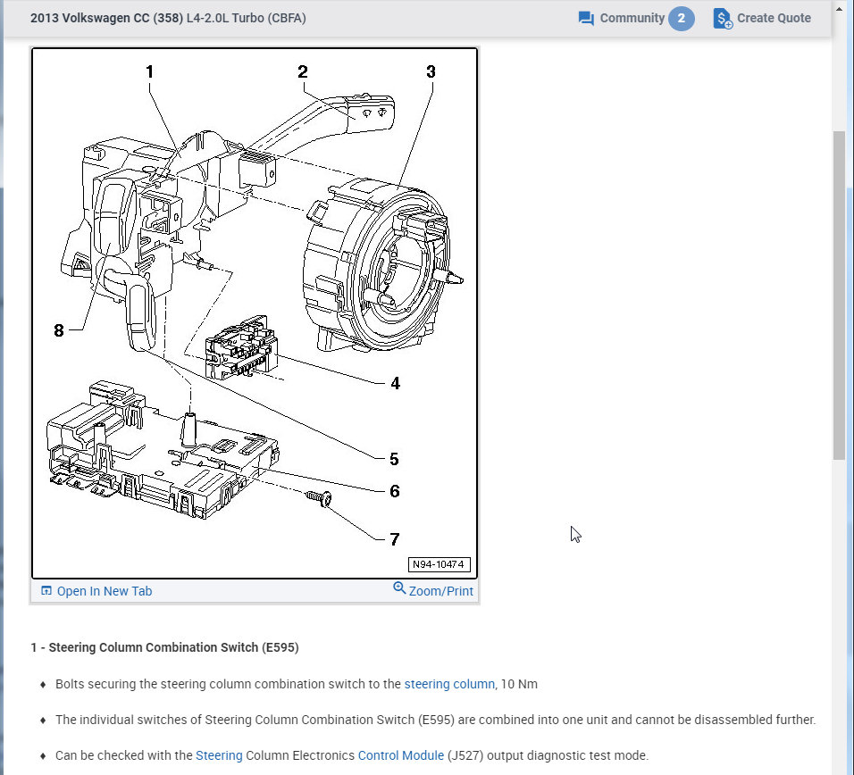

If you change a clock spring do you need reprogram anything as additional dashboard lights came one once it was replaced?
Feb 22, 2020 at 12:40 AM

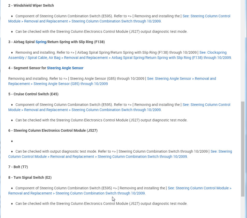

Did you only change the clock spring or did they replace the control module as well? See the images below.
If it was only the clock spring then we need to know what dash lights are coming on now. Can you get a picture of the dash and the lights that you are seeing?
Depending on what they are, we may need to get codes from it but lets start with this and go from there. Thanks
