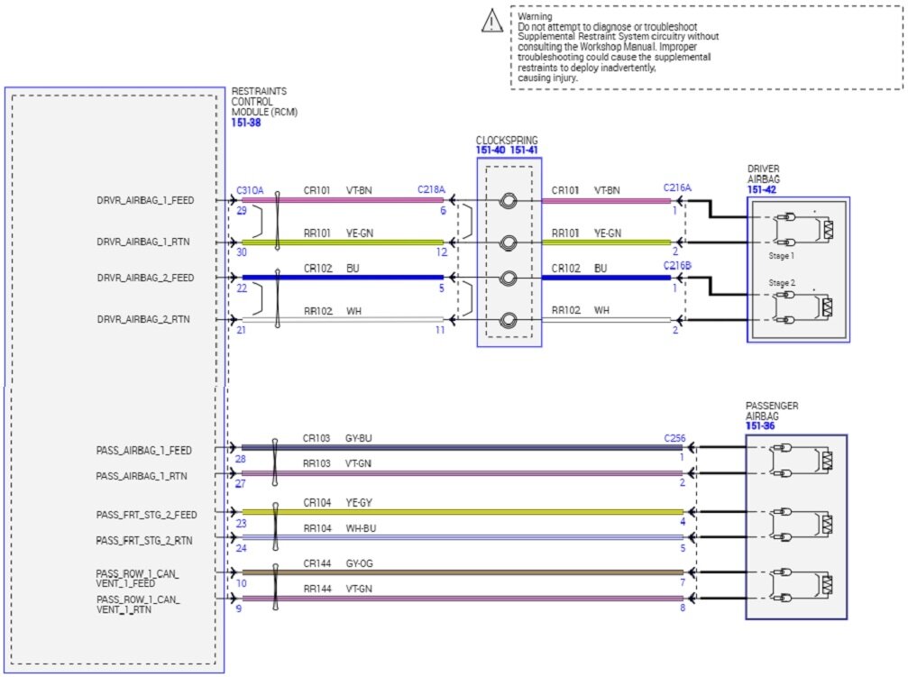

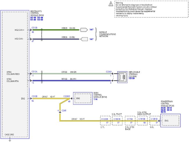

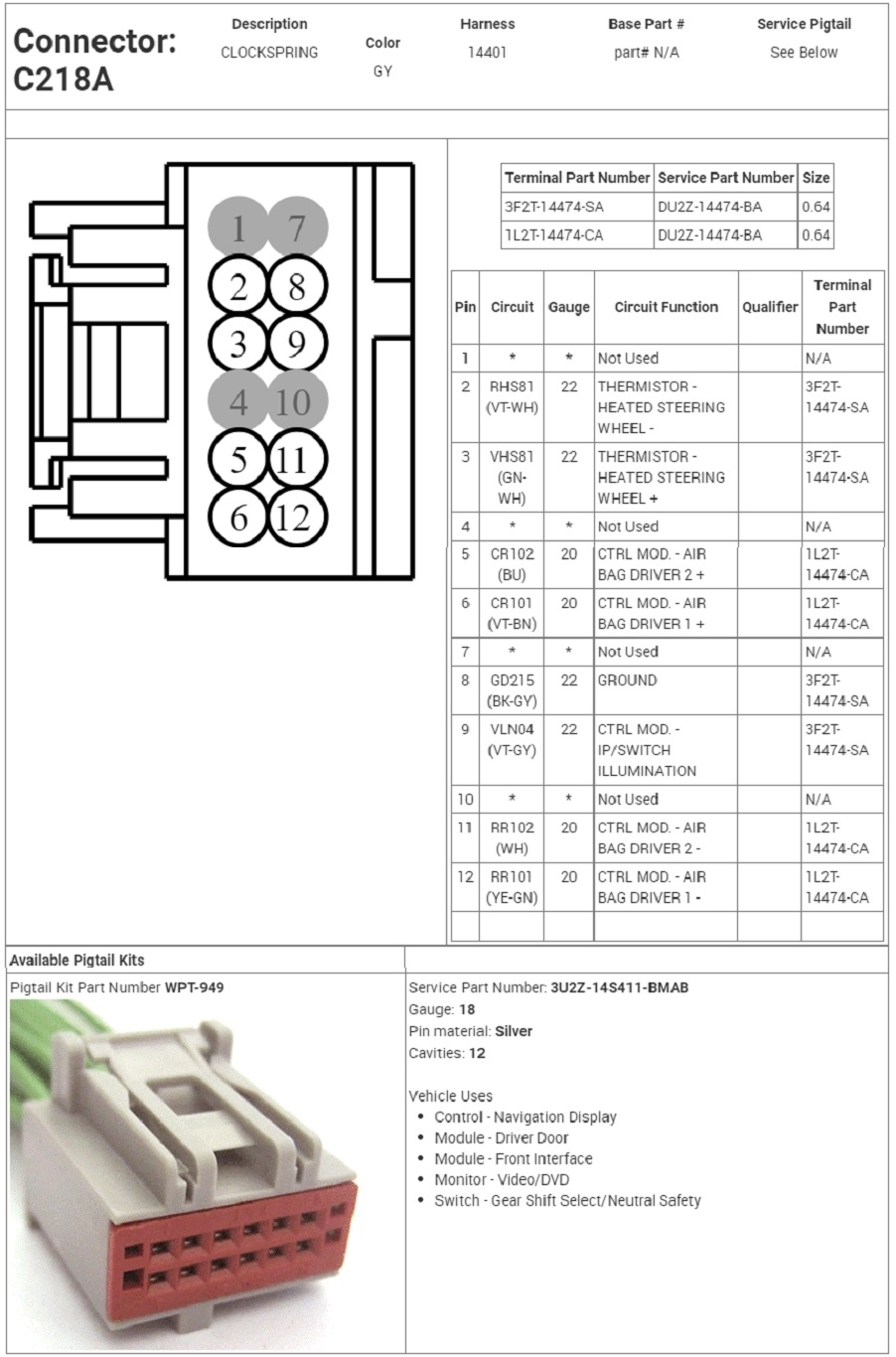

clock spring wiring diagram for 8 pin connector for clock spring needed?
2020 FORD F-150
10,000 MILES • 5.0L • V8 • 2WD • AUTOMATIC
T9370ML
MEMBER
1 POST
connector damaged on vehicle theft.
Oct 13, 2022 at 11:49 PM
CARADIODOC
Experienced Mechanic
34,411 POSTS
The clock spring is shown in the sixth diagram. It appears you're looking at connector C218A. That's in the last drawing.
