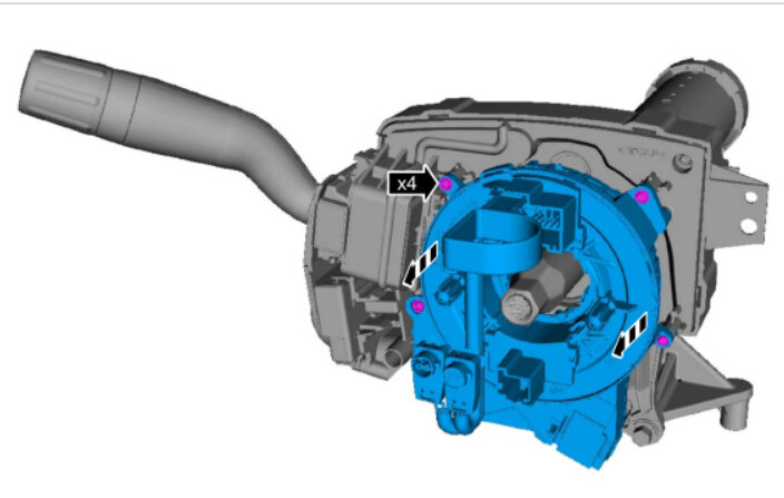

I have this harness you speak of in place. This harness completes the loop on the backside of the clock spring. I need to connect the paddles on the other side of the clock spring, behind the bag. The XL F150 harness does not have the plugs for paddles & ford does not sell this harness. So I need to remove the 2 prong male plug, replace the end with the female WT 1001 plug & plug them into the empty spots on the large plug at the top of the CS. PIC is of a 2024 harness inside the wheel as an example. I need pinout locations for the Top plug so I know where to pin them correctly. Yes sir, I have all the 3 & 4 speed CT's, SL's & Z50's from 1969-1979. GG

I am not sure what is going on here, Does the steering wheel have shift controls? The only thing going through the clock spring and airbag and any controls the steering wheel has. Do you plan to remove controls to try and make the paddle shifter work? They don't show the clock spring pin out by itself. They only show systems. To be clear this is the part you are talking about correct? Check out the images (below).
