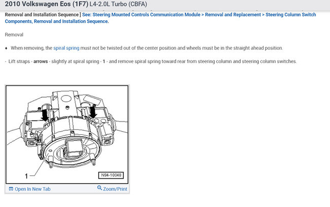

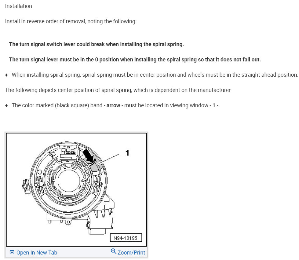

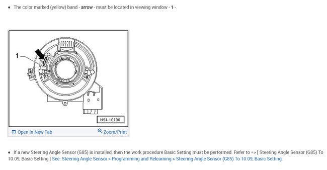

Clock springs go bad when they have been over extended have you had any steering work done recently? Here is how you can replace the clock spring yourself. If you need to know how to take the steering wheel off let me know. Check out the diagrams (below). Please let us know what happens.
