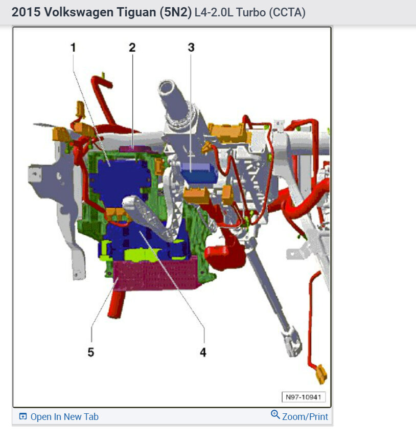

I replaced the clock spring this morning with the same identical part number and now additional error codes are on the screen but not on my reader airbag steering column, ABS and traction control. Any suggestions out of manually reset. Clock spring is working properly due to horn working and Steering wheel controls back functional.
Jun 8, 2023 at 7:20 AM
  • 55,381 POSTS
I would clear all codes then without cranking the engine over, turn the system on to see which codes come back on, please let us know the codes numbers. Also make sure the steering column control module is plugged in here is the location so you can check it out. Check out the images (below). Let us know what happens and please upload pictures or videos of the problem so we can see what's going on.
