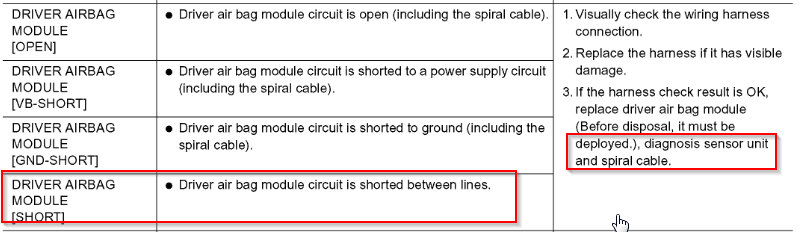

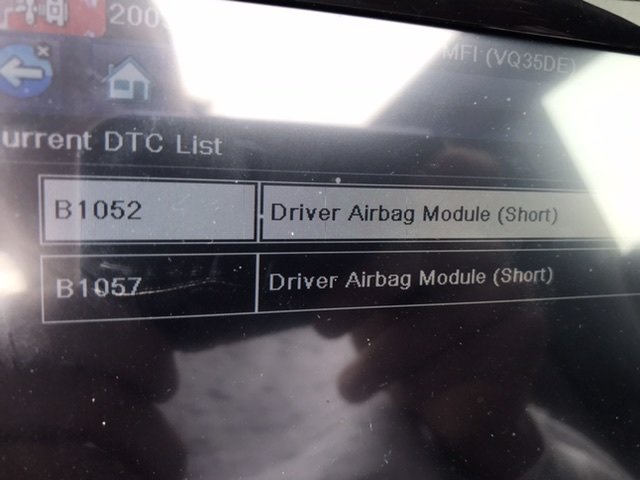

Okay, so I put everything think back to normal with the OEM steering wheel and airbag. then scanned it and got two very similar codes.
May 7, 2020 at 3:28 AM
So the clock-spring is the most likely cause of these codes so I suspect your initial thoughts were correct.
Take a look at the attached info about these codes.

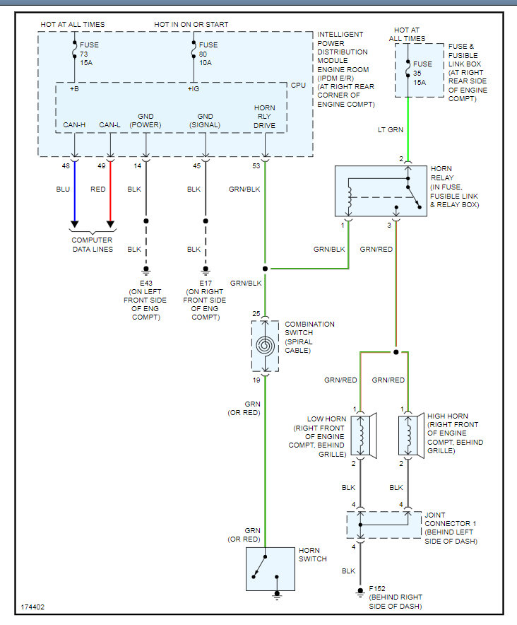

Okay, so I did more messing around and I figured out that my clock spring was turned 360 degrees off from being centered and I found the center put it all back together and the lights were all gone and no problems with the airbag. The only thing is the horn still blows a fuse after a while. so I’m wondering if when the horn went off like crazy for a little bit it melted something together in there allowing it to produce more amps there for blowing the fuse? What do you think or any other ideas?
May 7, 2020 at 1:03 PM
Yes. That theory could be true but we need to test it. Let's start with finding out which fuse is the one that keeps blowing. You said it was when you turn the key on so I assume it was fuse 80 because fuse 73 is hot all the time.
If this is the case let's unhook the components on this circuit one at a time and replace the fuse each time until it does not blow any longer.
Basically you want to unhook the horns and the horn relay and other connectors one at a time and turn the key on until the fuse doesn't blow any more. We need to narrow down the circuit to try and find the issue.
Let me know if you have questions.
