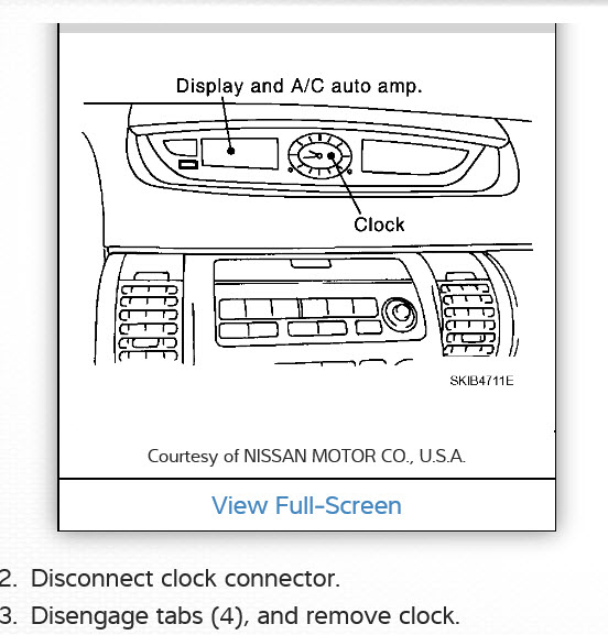

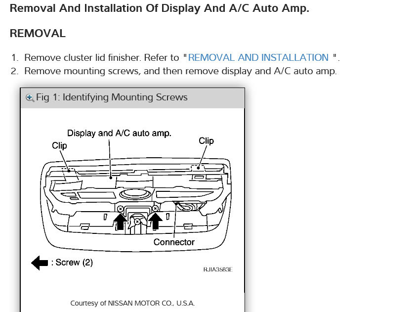

how to remove the dash trim panels to remove the clock
Apr 30, 2016 at 4:50 AM
HMAC300
Experienced Mechanic
48,601 POSTS
see pics I think ihave everything listed if not it's gonna be a lot more that I can't paste here
