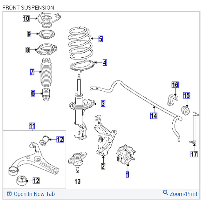

Clunking sound on the first drive of the morning
2018 HYUNDAI ELANTRA
44,901 MILES • TURBO • 2WD • AUTOMATIC
AMBERLYNM
First thing in the morning when driving my car, it sounds like I am driving with a bag full of empty cans of soda under the front passenger side. I have tried looking in the engine compartment, underneath the car (without using a jack) and even in through the wheel spokes area and I can’t see anything that looks loose, detached or could be even remotely close to a problem. After a while, I’m assuming once the engine is warmed up, the noise will stop. The sound also only happens at low speed. Any ideas?

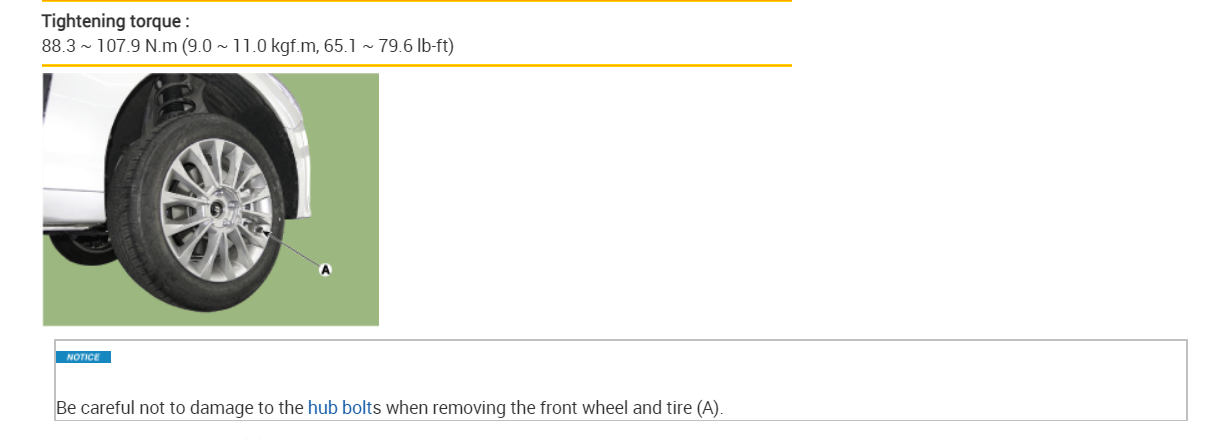

I would make sure the front wheel is tight on the car, but with noise, we can't tell what is wrong. If you can take a quick video with your phone and then upload it here with your response. Then I can see for sure what's going on.
This video will show you how to tighten the wheel:
https://youtu.be/_HIaE1MyDiw

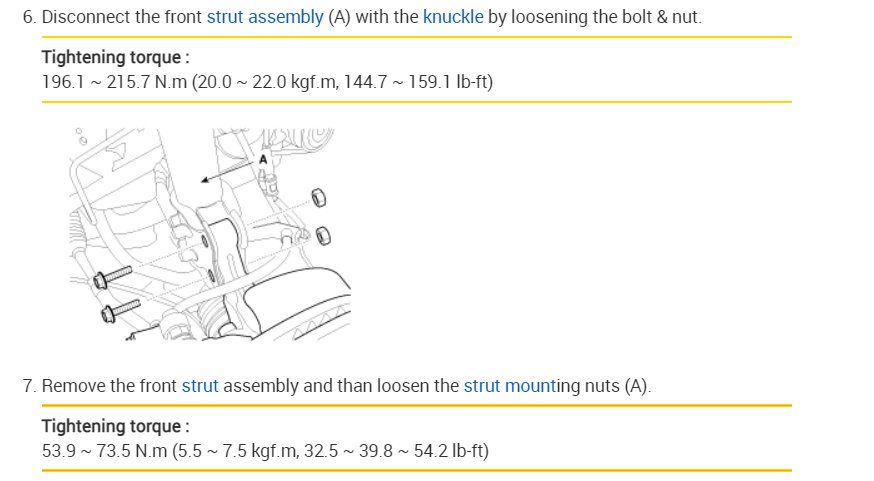

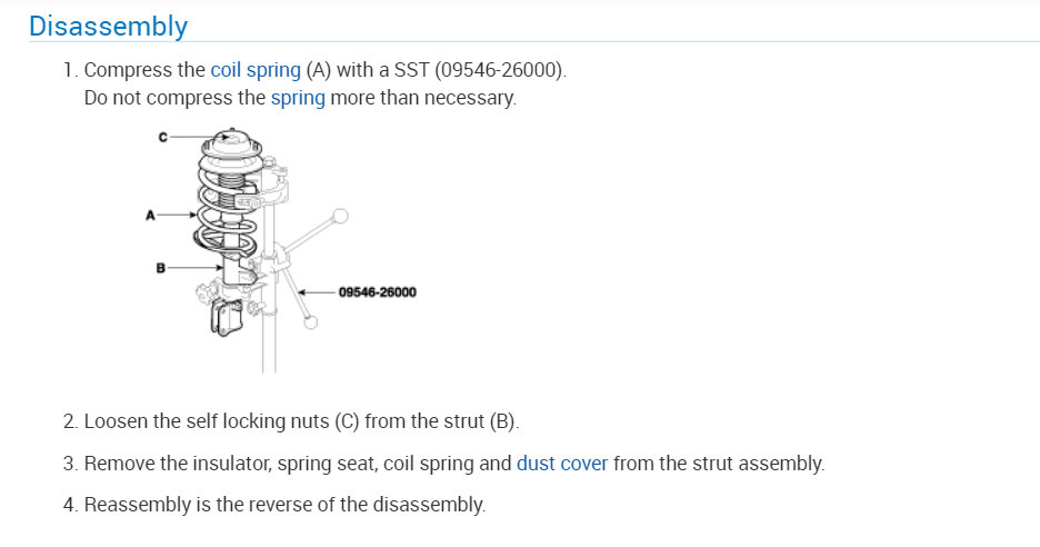

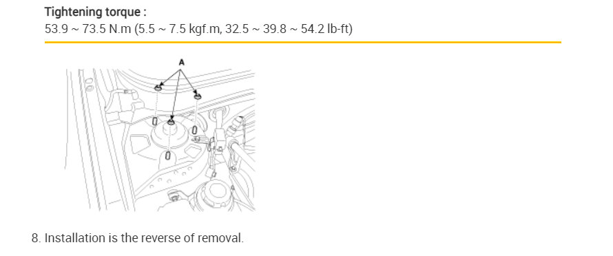

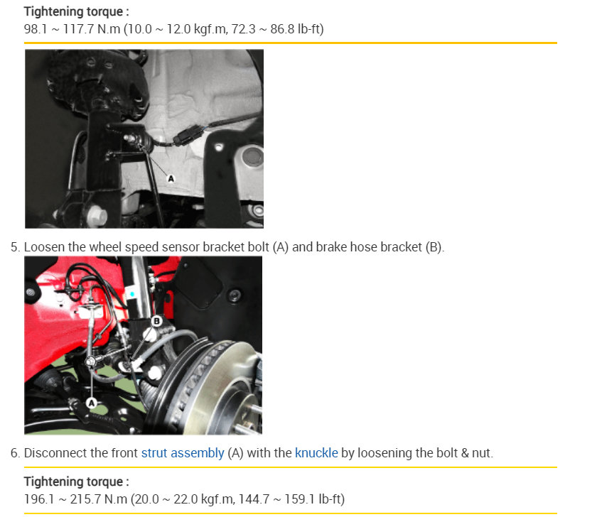

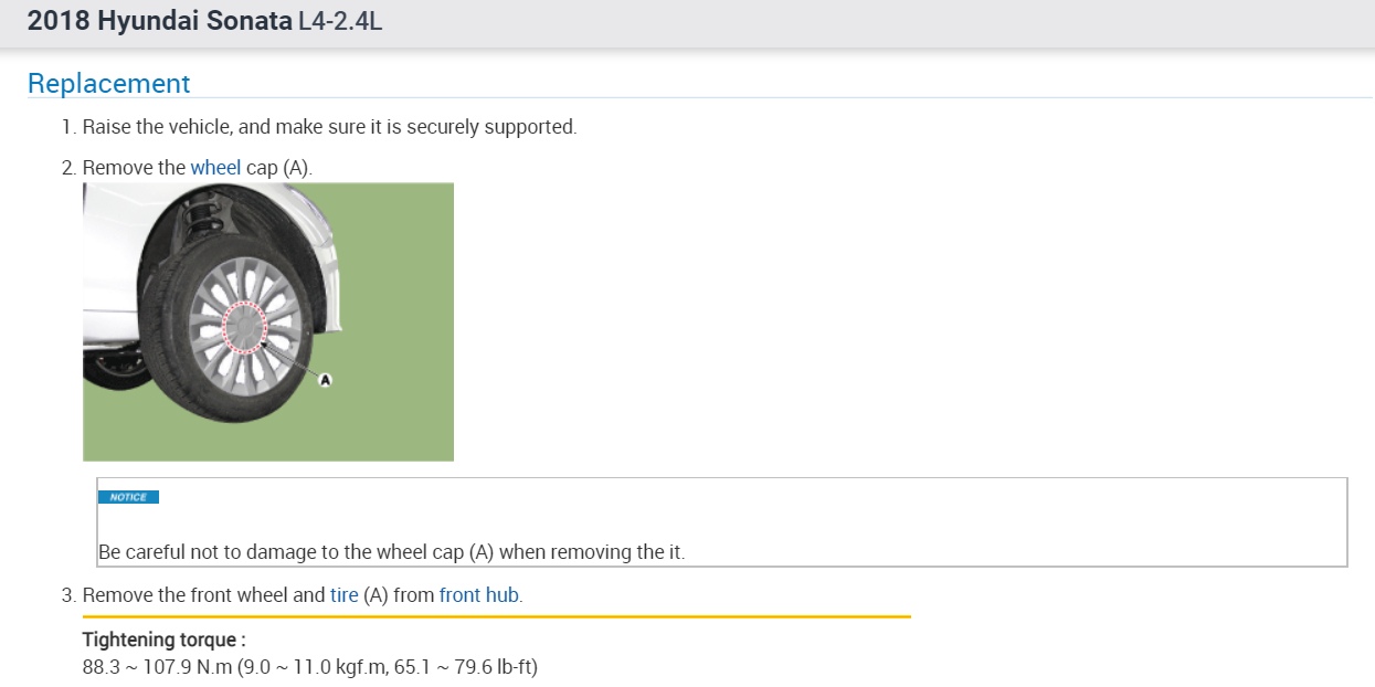

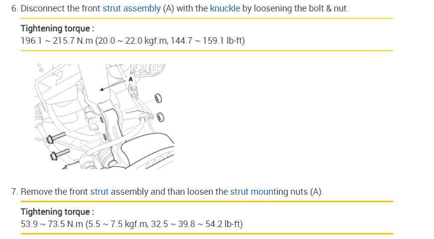

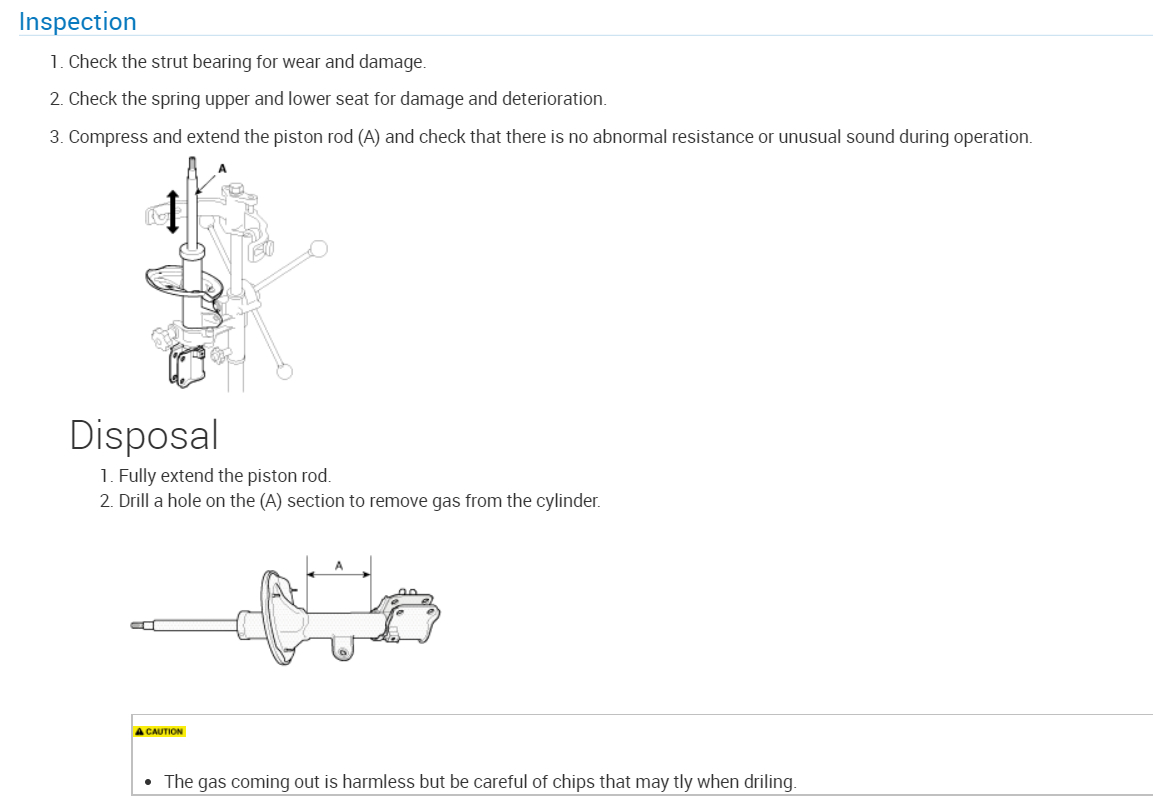

Thanks for the video, it sounds like a front strut or sway bar link is no good which is common. The strut fails internally so it is difficult to see, here are the instructions and a generic guide so you can see how the job is done and the cost to get it fixed:
https://www.2carpros.com/articles/how-to-replace-a-suspension-strut-and-spring
and
https://www.2carpros.com/articles/how-to-replace-a-sway-bar-link
Here are the instructions in the diagrams below for the sway bar link (#17) and strut replacement. Check out the diagrams (below). Please let us know what you find. We are interested to see what it is.
