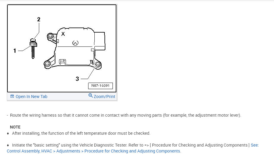

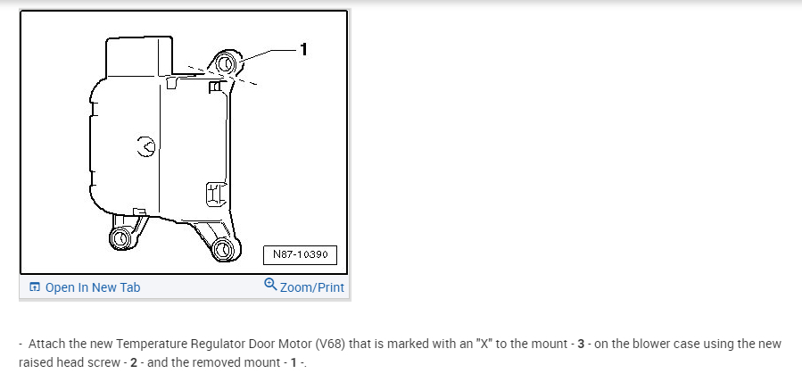

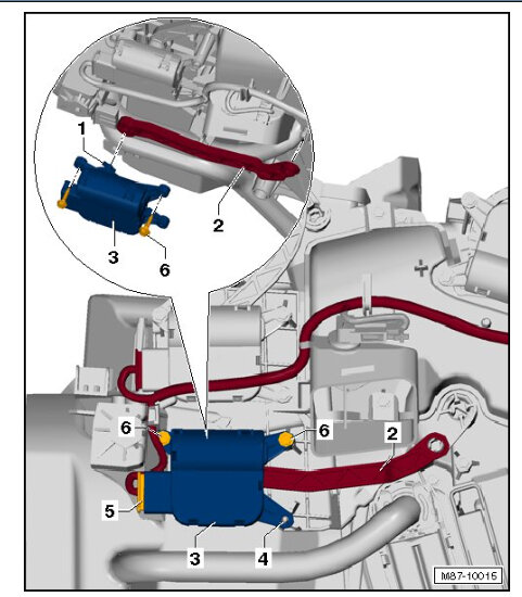

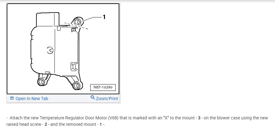

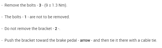

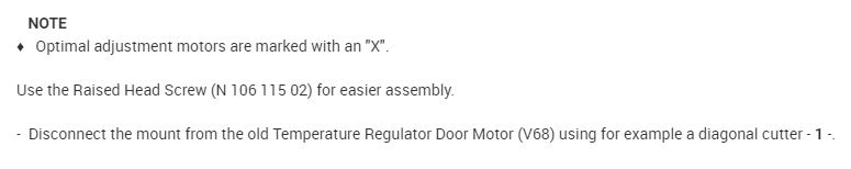

When you turn the A/C on, do you notice if the A/C compressor is actuating? If it is, then my first suspect would be a blend air door issue, especially if the air is always hot.

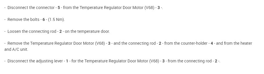

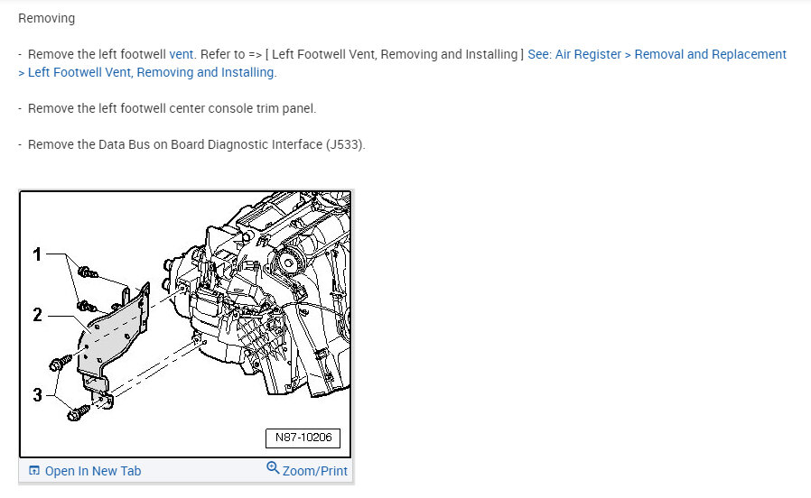

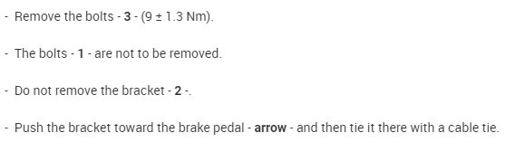

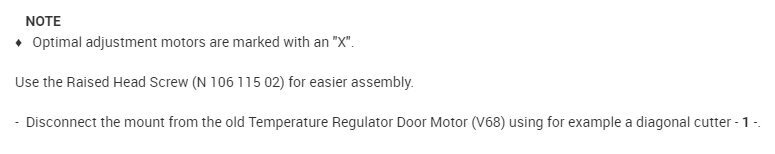

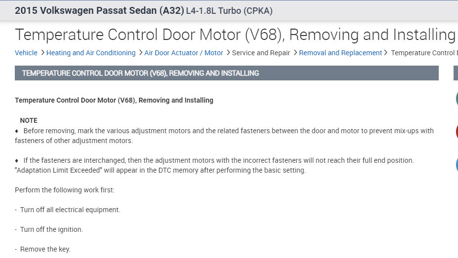

If the compressor does turn on, then the blend door is the first suspect. If you look below, I attached the directions for the removal and replacement of the actuator. Before purchasing one, remove the old one and see if it responds when you change the temp.
joe
see pics below.

Hello. Thank you for your rapid response to my HVAC issue. It turns out that it was in fact a stuck blend door. I followed your advice by removing the panel by the footwell of the driver's side. Once I was able to see the actuator and arm that was connected to the blend door, I used a metal rod I had to move the arm slightly. Then I started the car and A/C on, and it instantly started blowing cold air. So yes, it was just as I thought, a stuck blend door. I just saved myself $380, from an estimate I got last week from a mechanic shop. Thank you for all your advice. I hope someone else can benefit from my experience.
