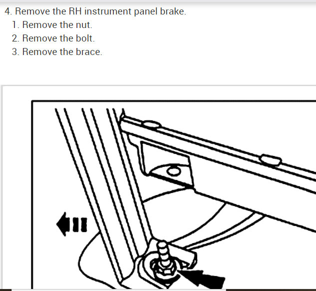

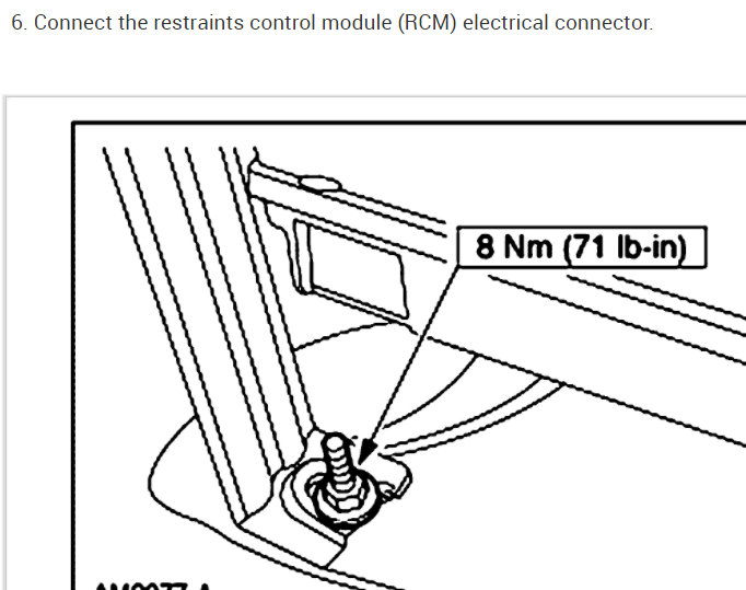

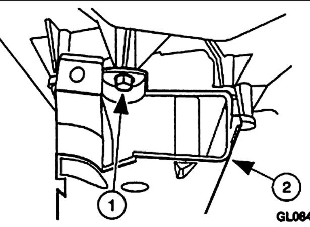

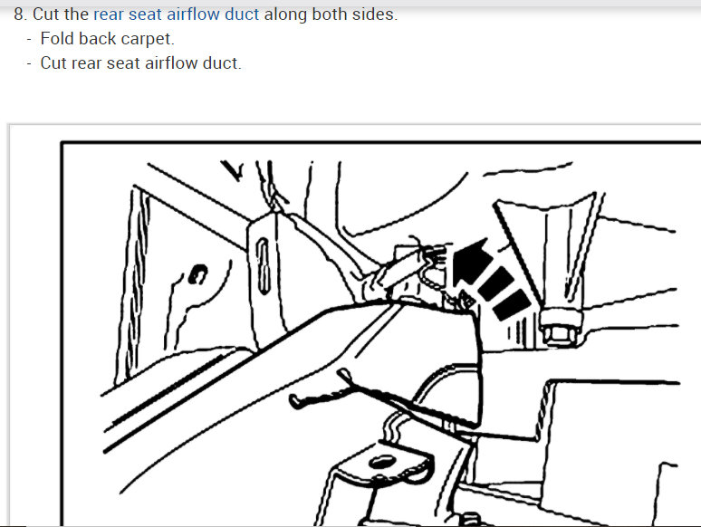

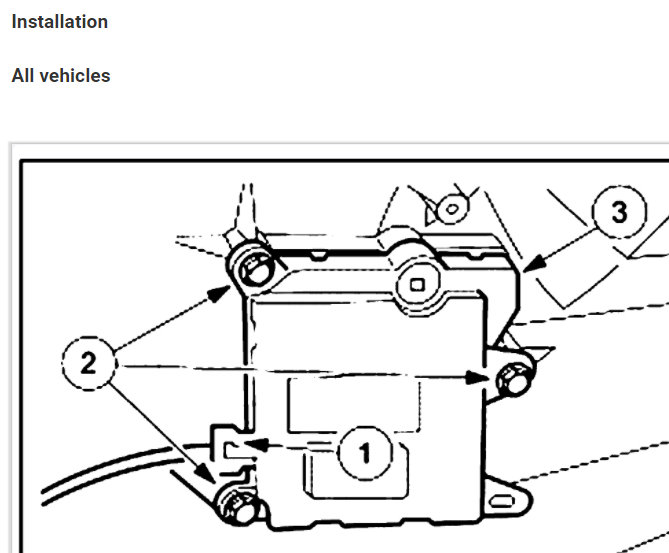

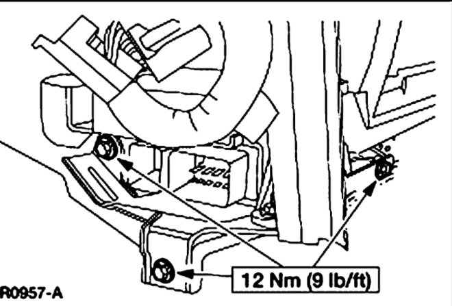

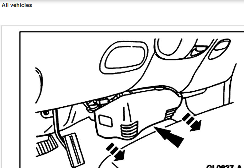

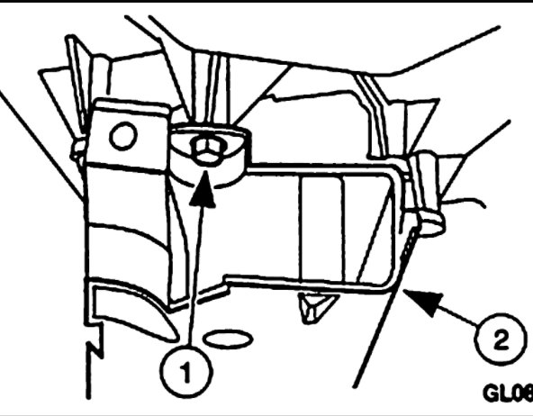

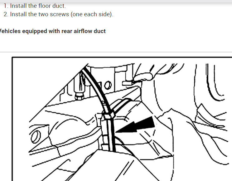

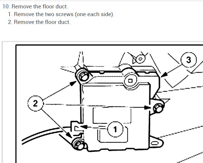

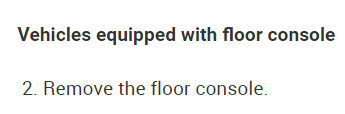

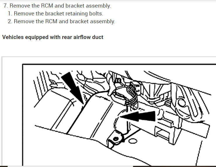

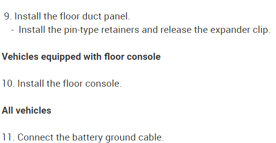

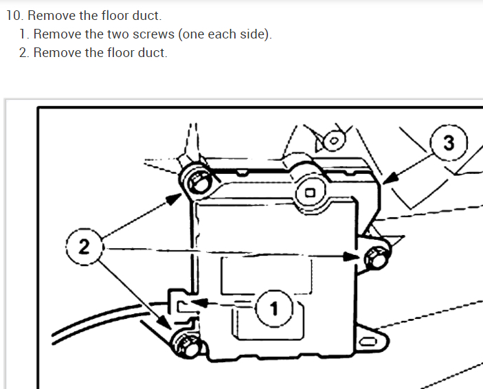

On my XLT it blows cold air no matter how you turn the switches or nobs. What could be my problem?
Jan 5, 2018 at 7:05 AM
DANNY L
  • 5,648 POSTS
Hello, I'm Danny.

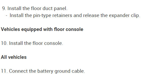

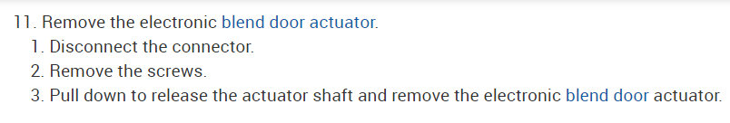

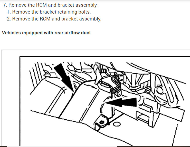

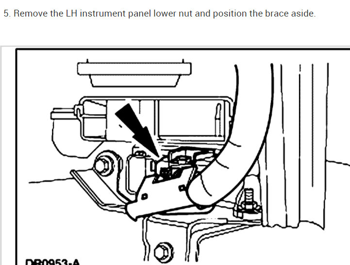

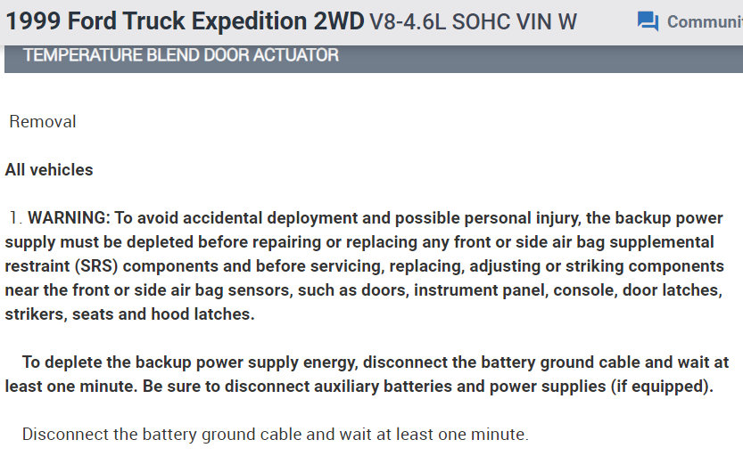

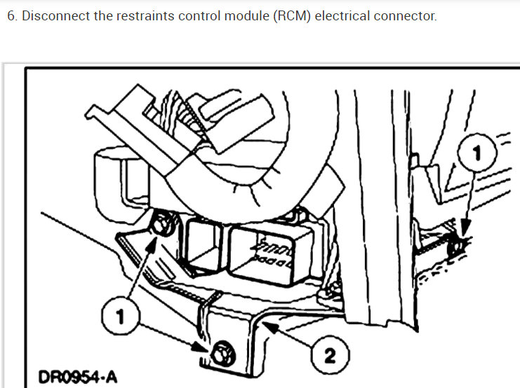

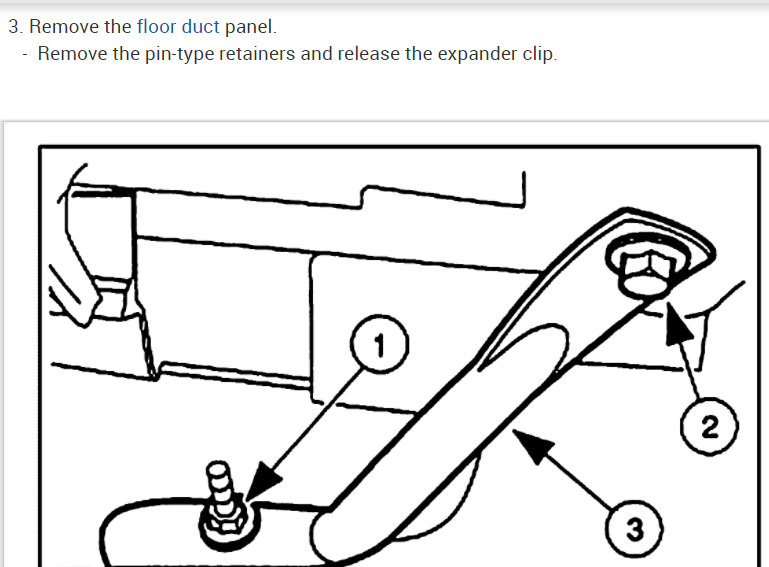

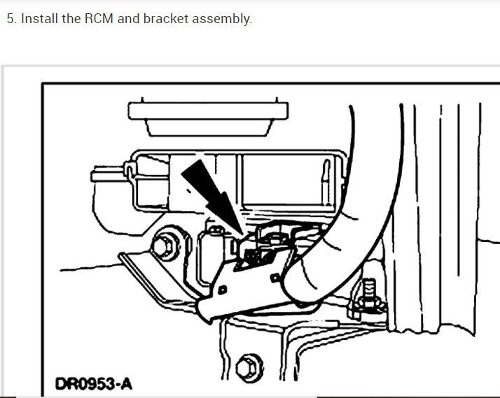

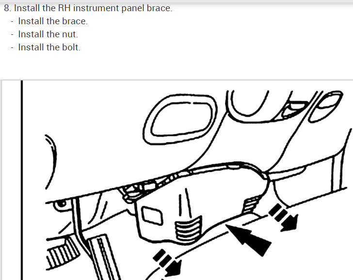

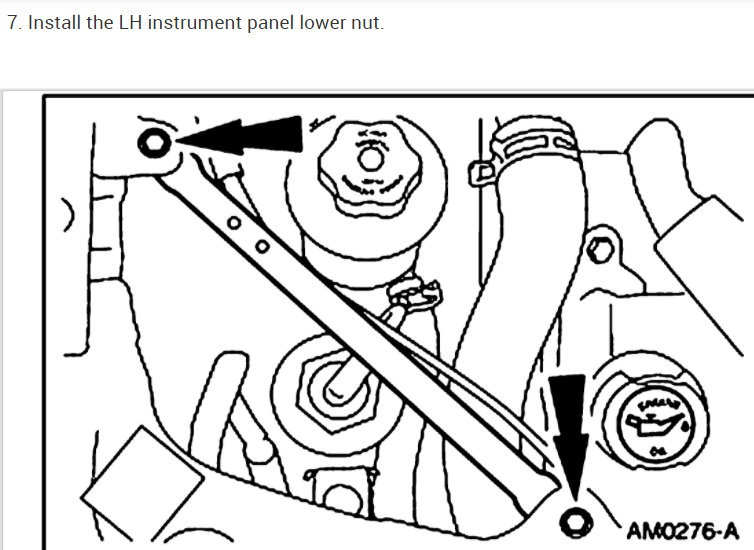

It sounds like you have a failed or defective blend door actuator. It's a small electric motor that opens a door to direct hot air throughout the various air ducts in the HVAC box. Here is a tutorial showing what is involved for the blend door actuator replacement:
I've attached picture steps below for the blend door actuator replacement on your vehicle. Hope this helps and thanks for using 2CarPros.
