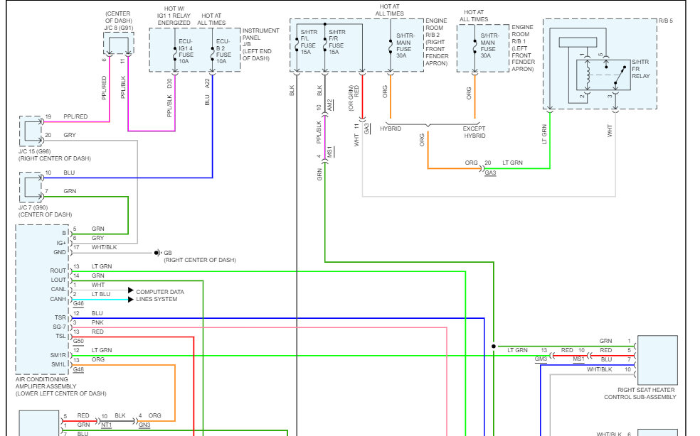

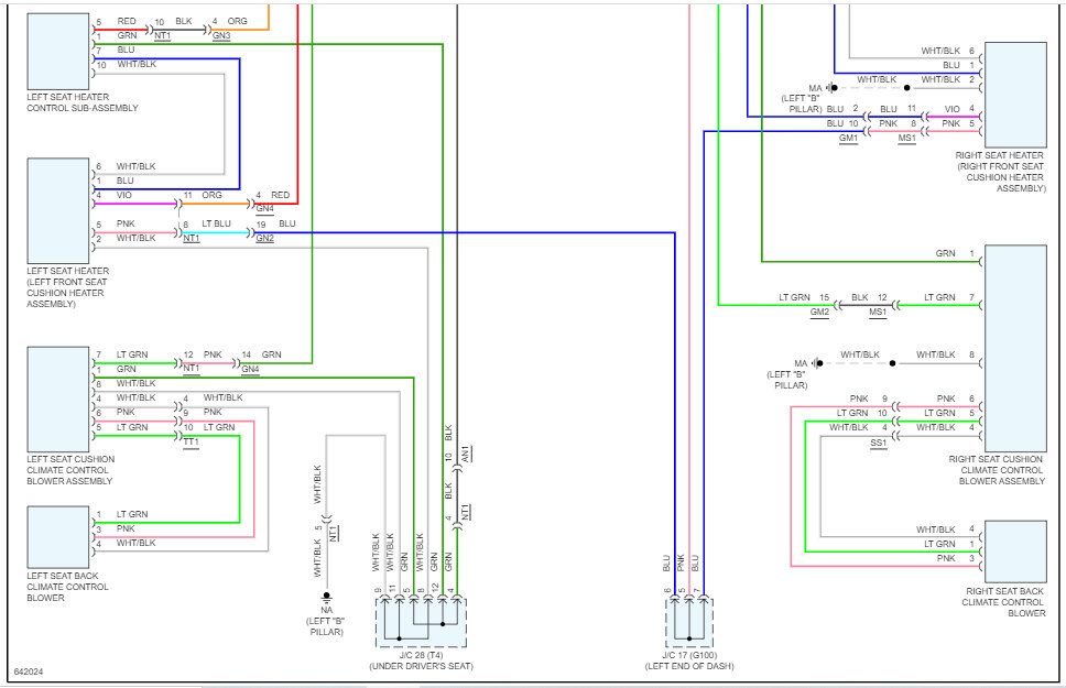

Did you check if there is power available to the fans? If not, you may want to check that first.
As far as the wiring is concerned, I attached the schematics for the climate-controlled seats.
Take a look through them and let me know if you have questions.
joe
See pics below. Note: I had to cut the schematic in two to make it readable for you. I did overlap the two so you can follow from one to the next.

I looked over the schematics you sent and did a little testing. At the driver's cushion fan I measured 12v on pin 1 Green wire. Also made sure pin 4 had ground. Not sure what is supposed to be on the Light/Green pin 7 ?
I also need to locate the Air Conditioning Amplifier assembly. that says it is located lower left center of dash. Still looking.
Can you tell me what NT1 and GN4 mean?

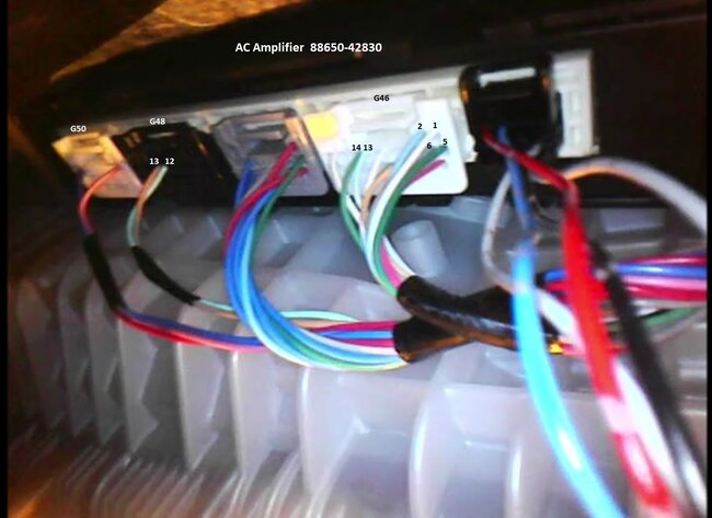

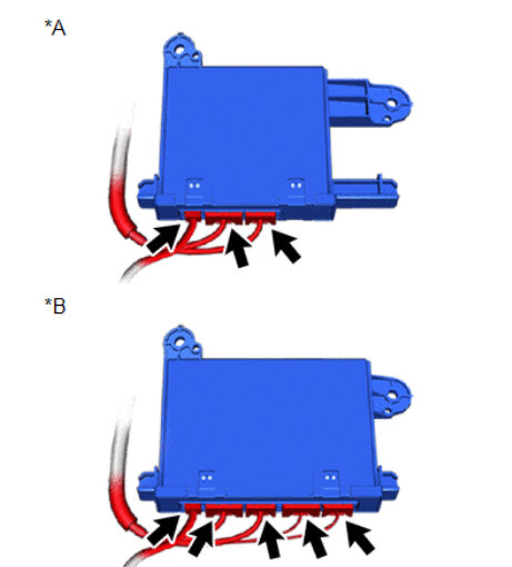

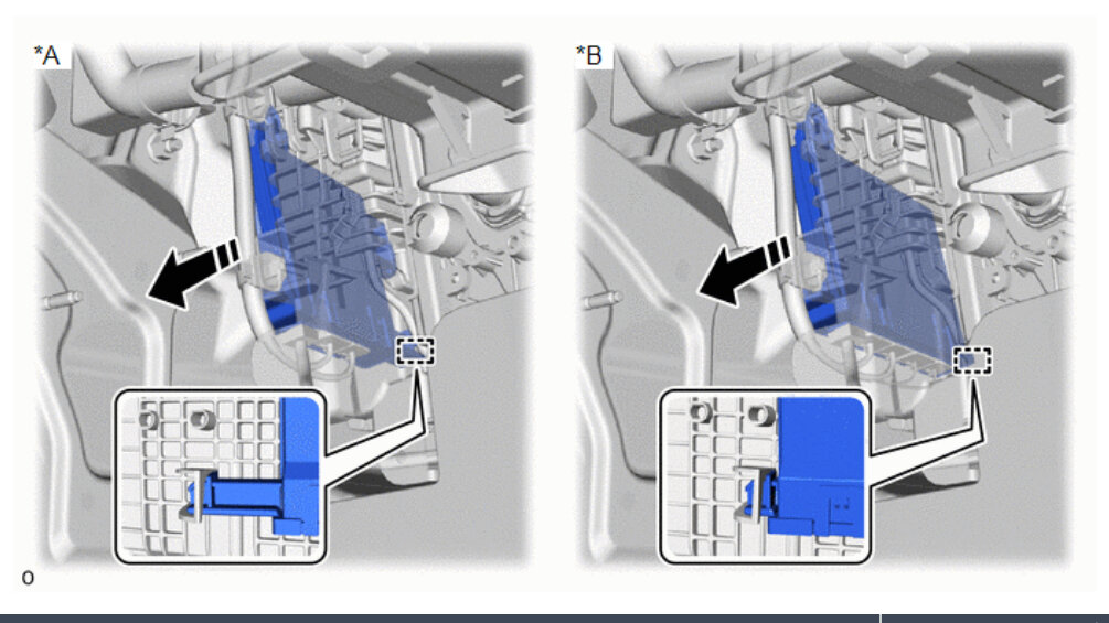

The A/C amplifier is mounted to the HVAC box under the dash near the throttle pedal. If you want to remove it, you need to remove the accelerator pedal assembly.
I attached the best pics I could find and attached them below. Let me know if they help you find it.

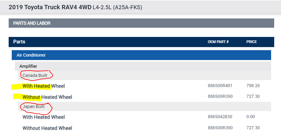

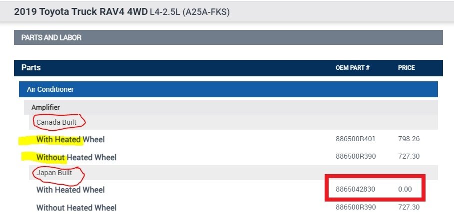

Those are excellent picks. I think my AC amplifier is bad. When looking for a replacement I found so many model numbers of this unit. When I put in my VIN # JTMN1RFV5KD030682 It comes back with two model numbers 88650-0R390 and 88650-0R401 not sure the difference. I did find one site that said the 88650-0R390 part was for w/o heated drivers' wheel, and 88650-0R401 was for with heated drivers' wheel. I'm not sure why Toyota's part website does not say this if true. I have a heated steering wheel. Can you verify this?

Yep, I sure can. If your vehicle was built in Canada and has a heated steering wheel, you need 886500R401. If the vehicle was built in Japan and has a heated steering wheel, you need part number 8865042830.
There are a total of 4 different ones. I attached a pic below listing them and which one is used based on the location it was manufactured and if it has the heated steering wheel.
Let me know if this helps.

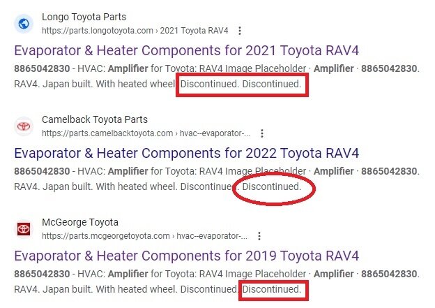

Not sure what to do because 88650-42830 looks discontinued. Any suggestions?

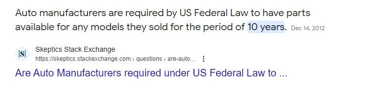

I wouldn't think the part would be discontinued already. They are required to provide parts for the first ten years. After that, they discontinue.
If you look under the hood or the driver's door frame, there should be a few tags that indicate the point of production. Check that. I believe the first digits in this VIN are the order numbers for this vehicle. In other words, a Rav 4 may have been recognized when ordering it with "J49" I just made up the 49. LOL

That is hard to believe. Wow! Have you tried contacting a dealership? Maybe there is a new part number that isn't in my manual.
This vehicle is too new to have this concern. Take a look at the pic below. If they can't provide the part, there is a serious legal issue.

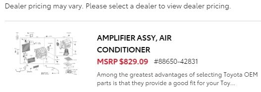

I did contact my Toyota dealer and I asked him if I could use the Canadian AC amplifier and he said his system says no.
He said they have a newer part number for 8865042830, it is 8865042831
But they can't get it. He could order it for $800 and wait.
