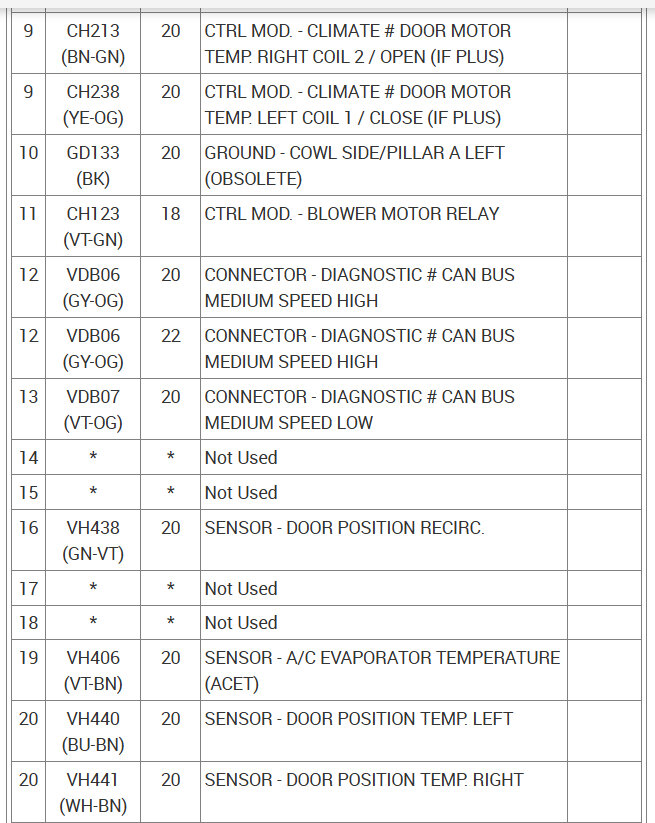

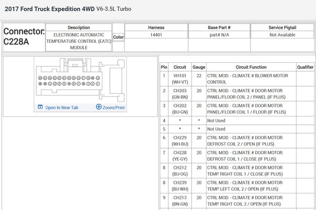

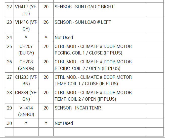

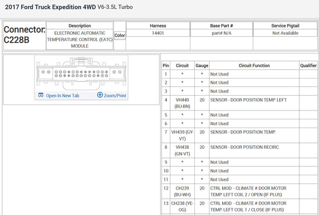

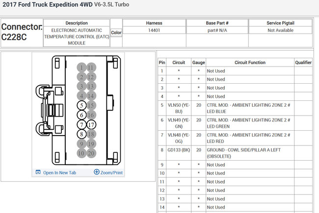

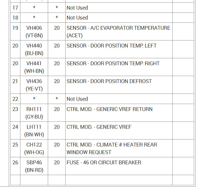

Got in my explorer this morning and the climate control panel would not work. No lights, no nothing. The outside temperature gauge on the radio is out also. So far, I've tried a system reset, checked climate control fuses under the dash and checked fuses under the hood. The only thing I can think of is the module is not getting power, or it just went bad. I think it's under the dash on the pass side, but I'm not sure about that. I was going to pull it tomorrow and check power at the pin. And If it did have power then order a module. If it didn't then start shooting some wires. So, I was looking for the pin out for the module and a wiring diagram do see if it pulling power from somewhere else besides the fuses I looked at.
Mar 13, 2025 at 10:24 AM
  • 55,711 POSTS

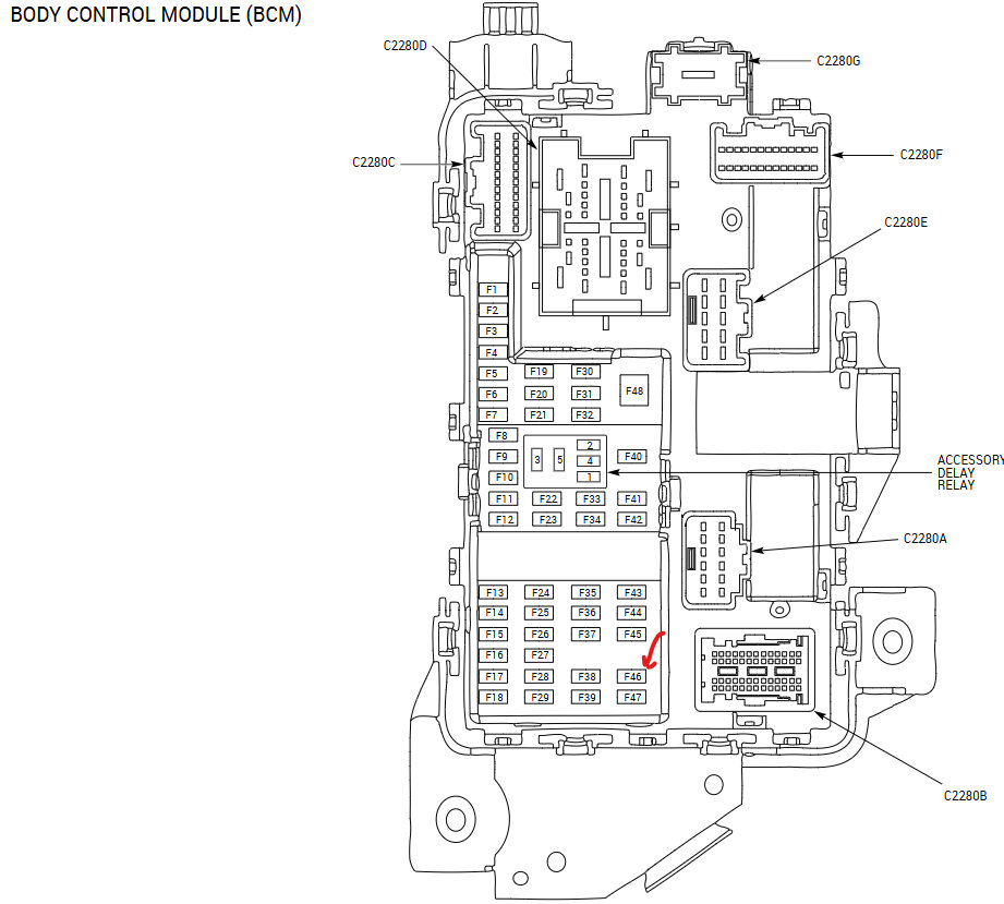

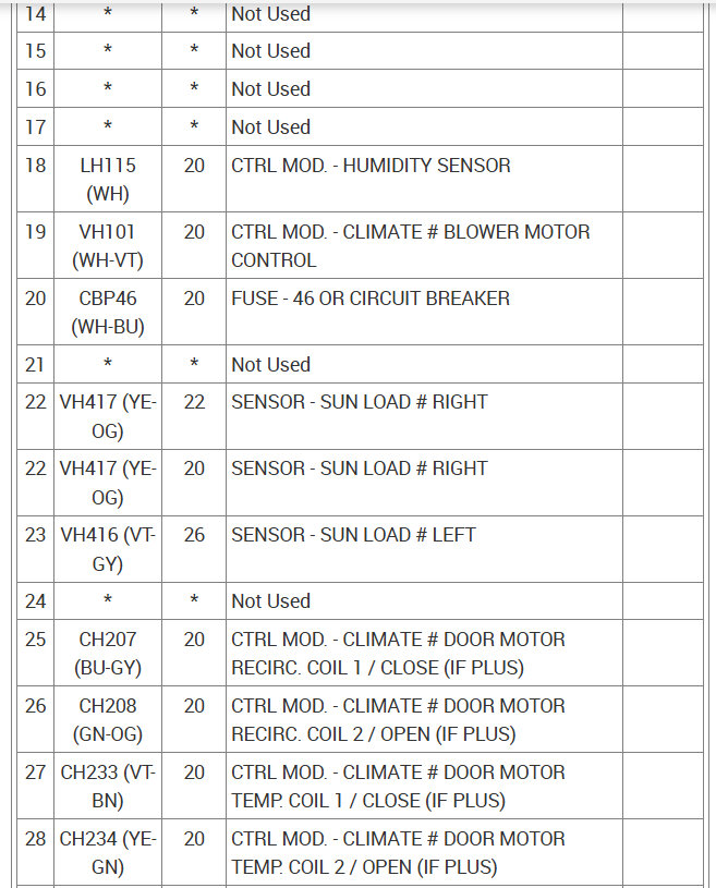

Fuse #f46 10 amp in the BCM fuse panel, (right kick panel) powers the HVAC system. Here are the pin outs for the HVAC control module so you can check it out. Here is a guide to help check the fuse for power and the location of the fuse in the images below.

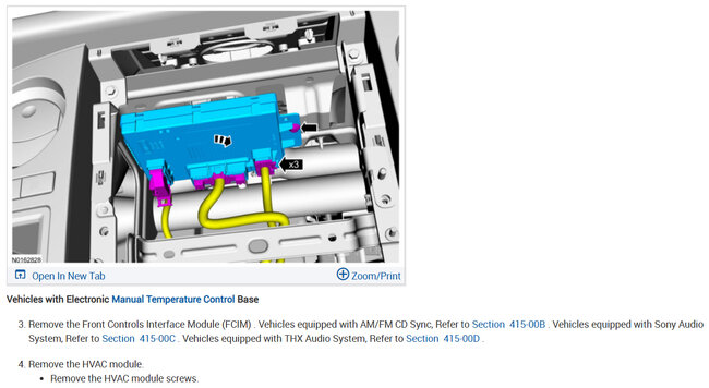

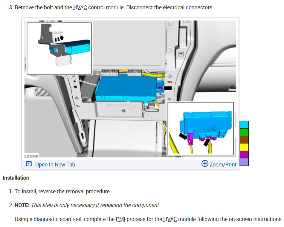

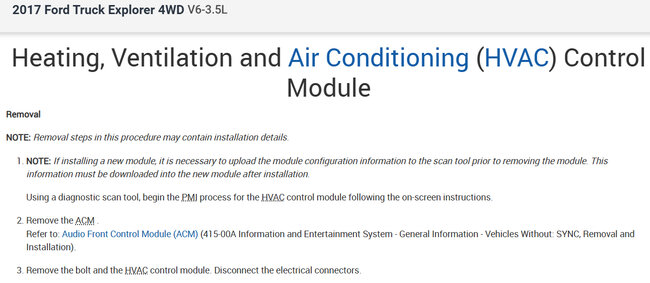

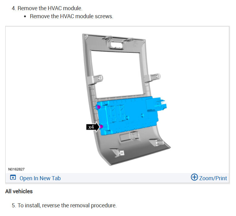

Here is how to change out the HVAC module as well. Check out the images (below). Let us know how it goes.
Mar 14, 2025 at 4:41 AM
  • 55,711 POSTS
Mar 14, 2025 at 4:43 AM
TABREWINGTON

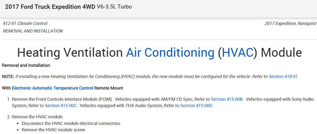

Was this for an Explorer or Expedition? I see expedition at the top of one page. And my BCM doesnt look like that. I just wanted to verify.
Mar 17, 2025 at 3:17 AM
  • 55,711 POSTS
My bad, I updated the image above. let me know what you find please.
