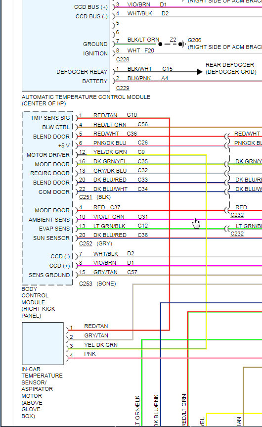

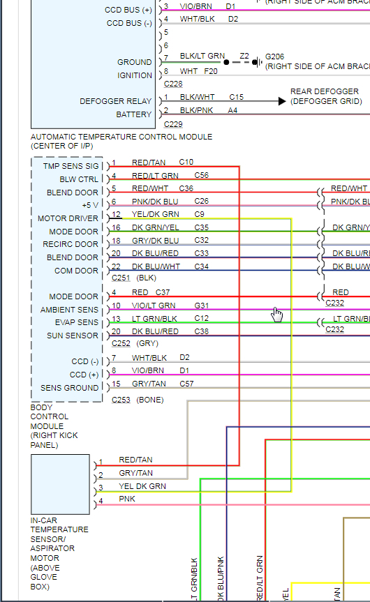

Short answer is yes it could be the BCM but most likely only if you have auto temperature control. Do you have a manual or auto system?
I attached the wiring diagram for the auto temperature control system. Basically the BCM controls most all operation of the system on auto systems. If it is a manual then the HVAC module controls these functions.
Let me know which system you have and we can go from there. Thanks

Well, I suspected that it was the body control computer but could it be the in car temperature sensor above the glove box Aspirator motor. Is there an actual motor there. I.e. blower that is clogged with dust? I will use a duster and blow some air . Or a vacuum to see if there is an improvement/fix.
I have the factory service manual but I could not associate the dash Heater/ac control with the body control computer. I found it and looked it over , it doesn’t Look very difficult to remove and install.
I will check the Chrysler Dealership and see if they have one in stock . Usually they will want the old one in exchange. They will give me a discount.
I thank you for taking the time to answer and the diagram you sent shows the temperature se.

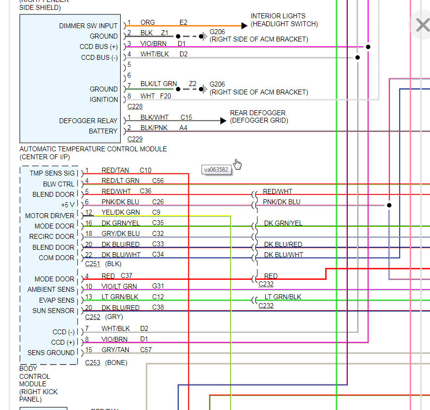

Atc. In vehicle temperature sensor Code 36 panel communication failure suggests a loose wire ! Something is not talking to something. We request that we start a new post for questions that are not directly related to the topic. The only reason is others will not find the answer to this question under a different subject. Basically this site is here to assist those that need direct help but also provide a resource for others that have the same issue.
Apr 30, 2020 at 6:26 AM
I attached the wiring diagram for the ATC. If this is a loose wire then you may be able to get it to act up by wiggling the harness. Just be very gentle with it. You don't need to pull it like trying to start a chainsaw. Try to mimic the movement it may have while driving down the road. Small gently wiggling and see if you can get the issue to happen.
