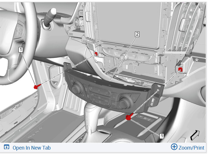

My climate control unit will randomly quit working/no lights or ability to use any of the controls but IF the blower was on for example for heat, it will continue to run. This happens just randomly...everything may work for several days in a row then it doesn't. There are times it will come on/light up when I start the car but then 5 minutes later go off. At times it may come back on after sitting a few hours, other times it won't. It is not the battery, just put a new battery in 4 months ago when this issue started with climate control unit. Dealership thought the battery was the issue....within a 5 mile drive the power/lights went out on the control unit. Took it back, they say it's not throwing any codes. When you live in an area the weather changes day to day sometimes every few hours it's important to have a working climate control unit! My rear unit works fine.

Yep, I have seen the HVAC control module start to go out and cause this issue. I would get a used unit form ebay and install it which should fix the problem, I have had good luck with used parts from there. Here is how to replace the unit. Check out the images (below). Please upload an image or a short video in your response.

I do have a warranty on the vehicle would it be better to have dealership install a new one??

If it is covered than yes, I would have the dealer fix it. Please let me know what they say.
