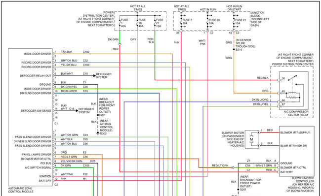

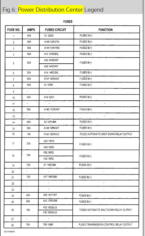

At the climate control module.
Connector C1
Pin 9, black wire ground
Connector C2
Pin 12, pink wire Constant 12V from fuse 7, 10A
Pin 11, white/pink wire Ignition from fuse 20, 10A

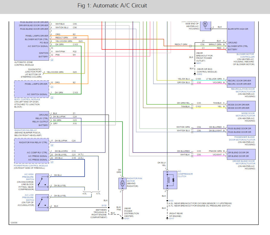

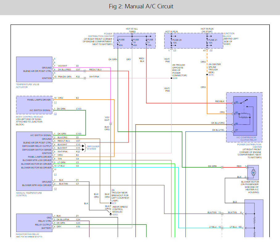

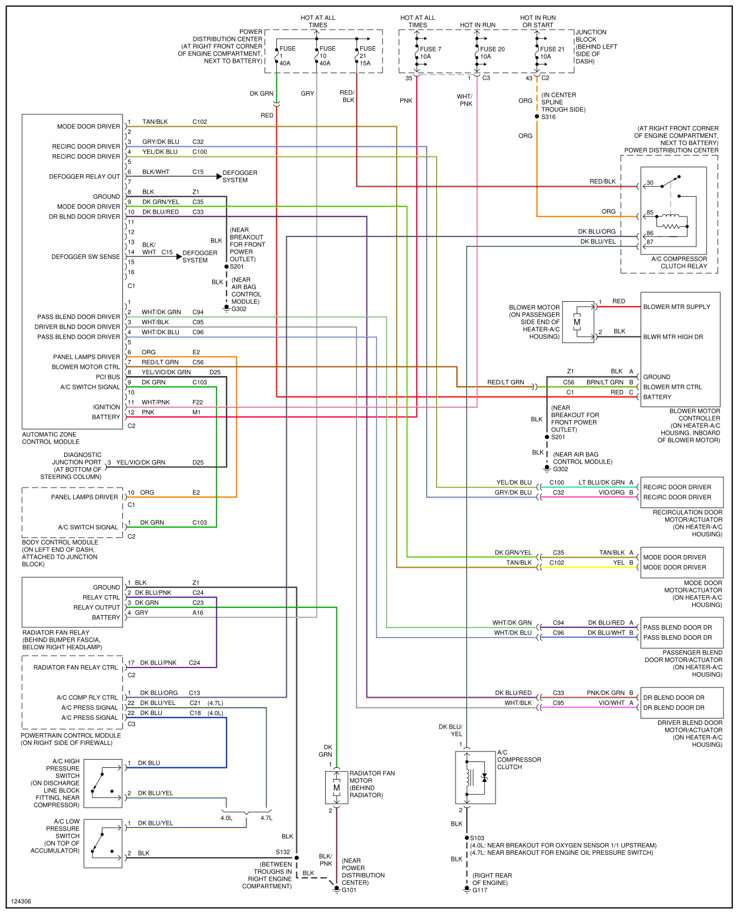

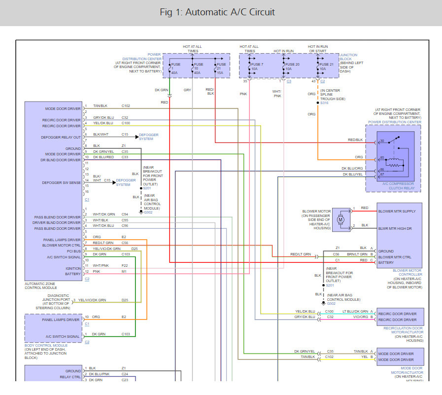

Please see schematics below.

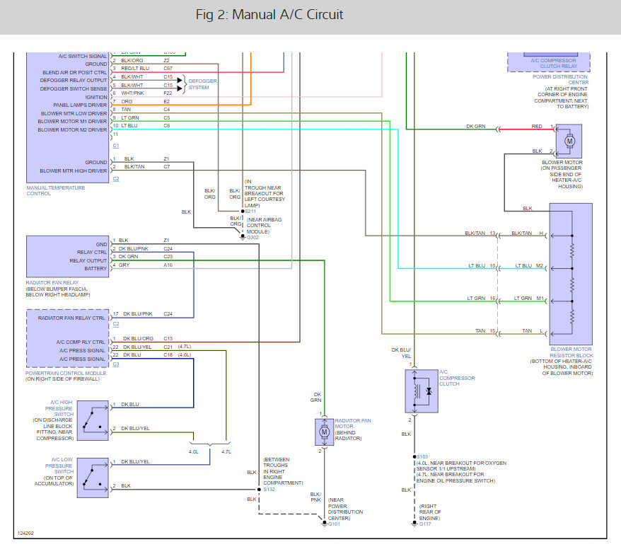

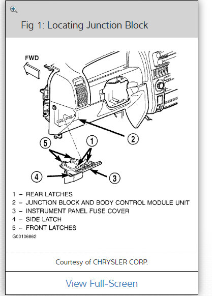

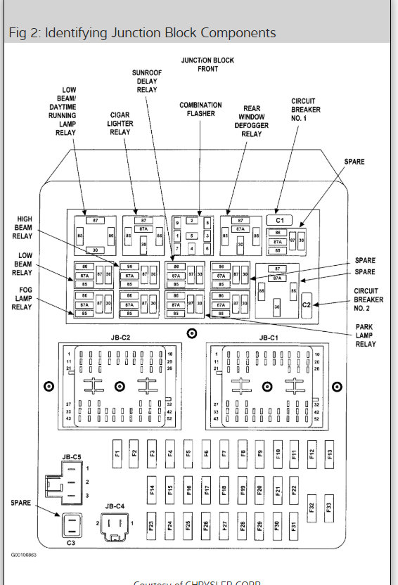

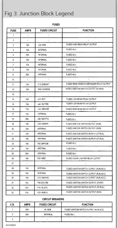

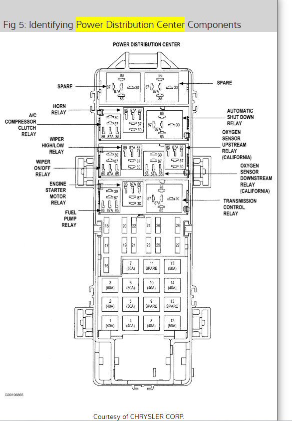

We need to start by checking the fuse # 1, 10 and 21 in the under-hood fuse panel, and fuse # 7, 20 and 21 in the interior fuse panel. here is a guide to help and the fuse locations in the diagrams below. Also, I have included the A/C and HVAC wiring diagrams so you can see how the system works.
