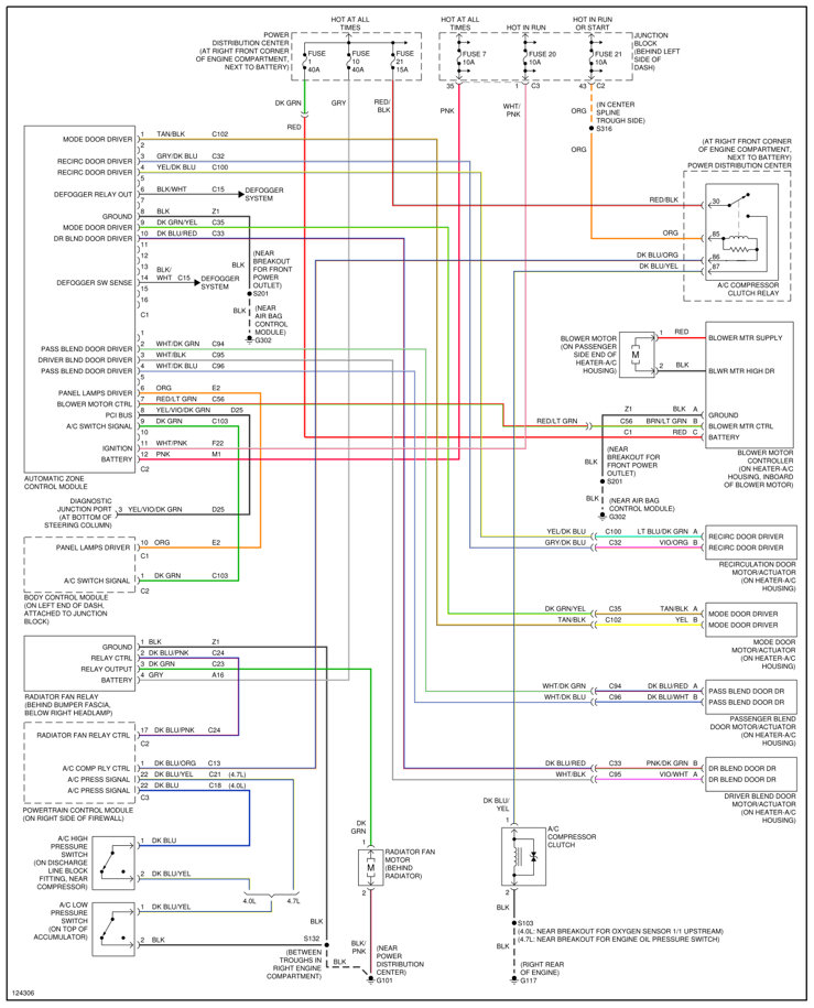

Climate control system stopped working, where are the fuses located?
2000 JEEP GRAND CHEROKEE
98,000 MILES • 4.0L • 6 CYL • 4WD • AUTOMATIC
DIRTRACER822

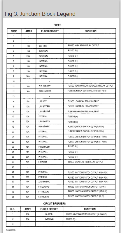

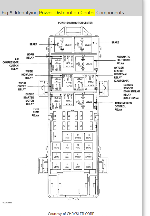

Vehicle listed above is a Limited model. While driving on a dirt road my climate control lost power. The control panel lights went out and the blower stopped. I looked at the fuses but I’m unsure which fuse(s) is for the climate control.
I did remove the control panel from the dash to inspect the plugs and look for a shorted wire. Everything looks good. Just unsure how to proceed. I don’t like throwing parts at a problem until I know what the root cause is.
Any information will be greatly appreciated!

At the climate control module.
Connector C1
Pin 9, black wire ground
Connector C2
Pin 12, pink wire Constant 12V from fuse 7, 10A
Pin 11, white/pink wire Ignition from fuse 20, 10A
How to test fuses
How to use a test light or voltmeter:
and

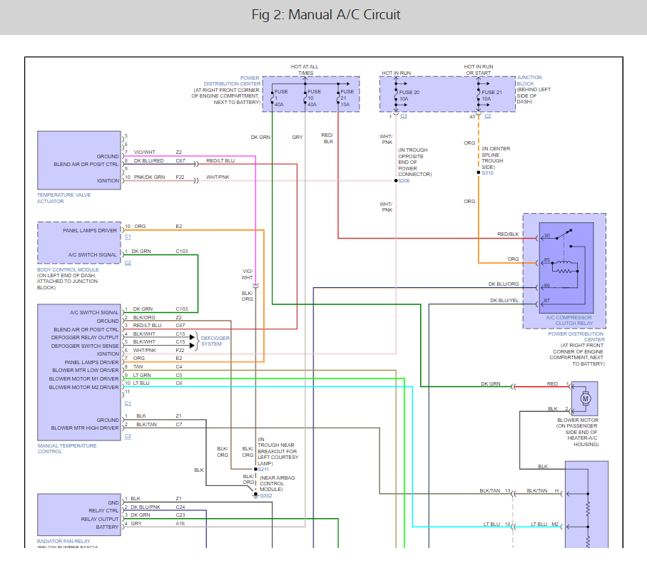

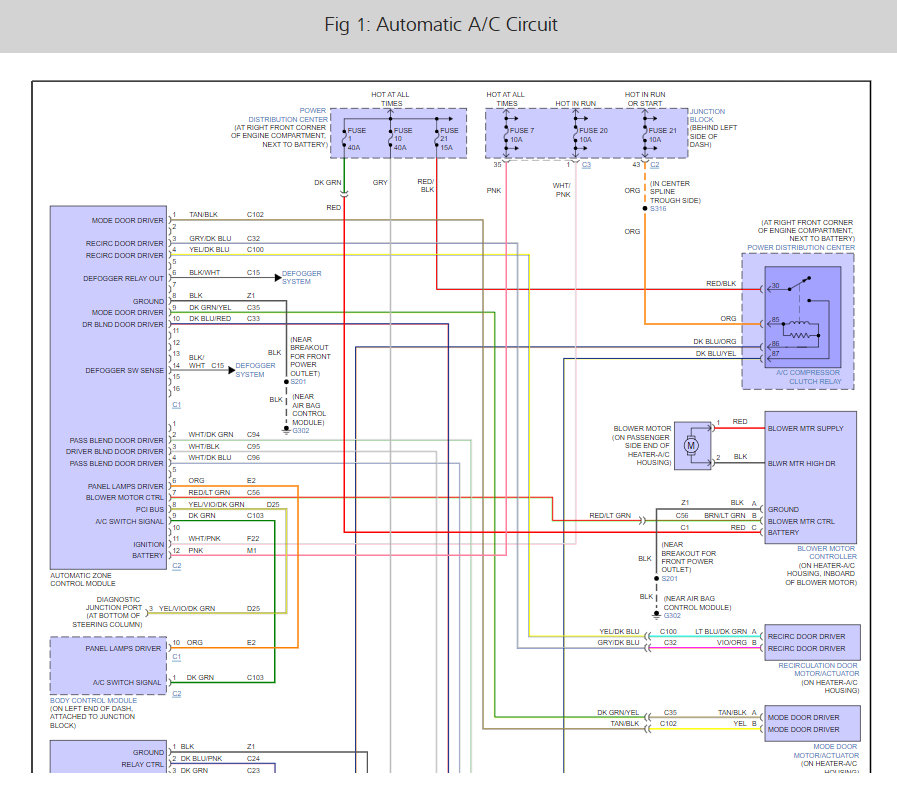

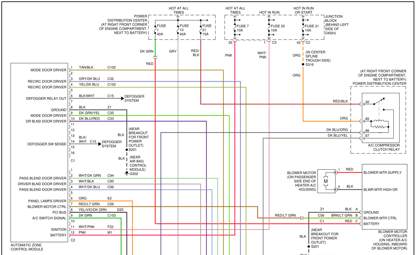

Please see schematics below.
Hope this helps.

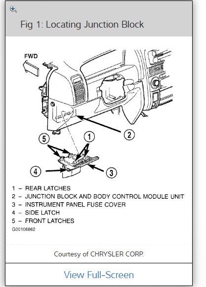

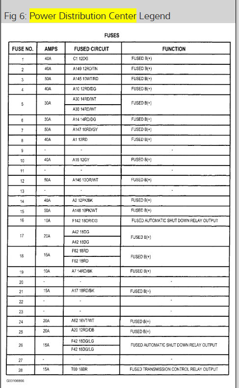

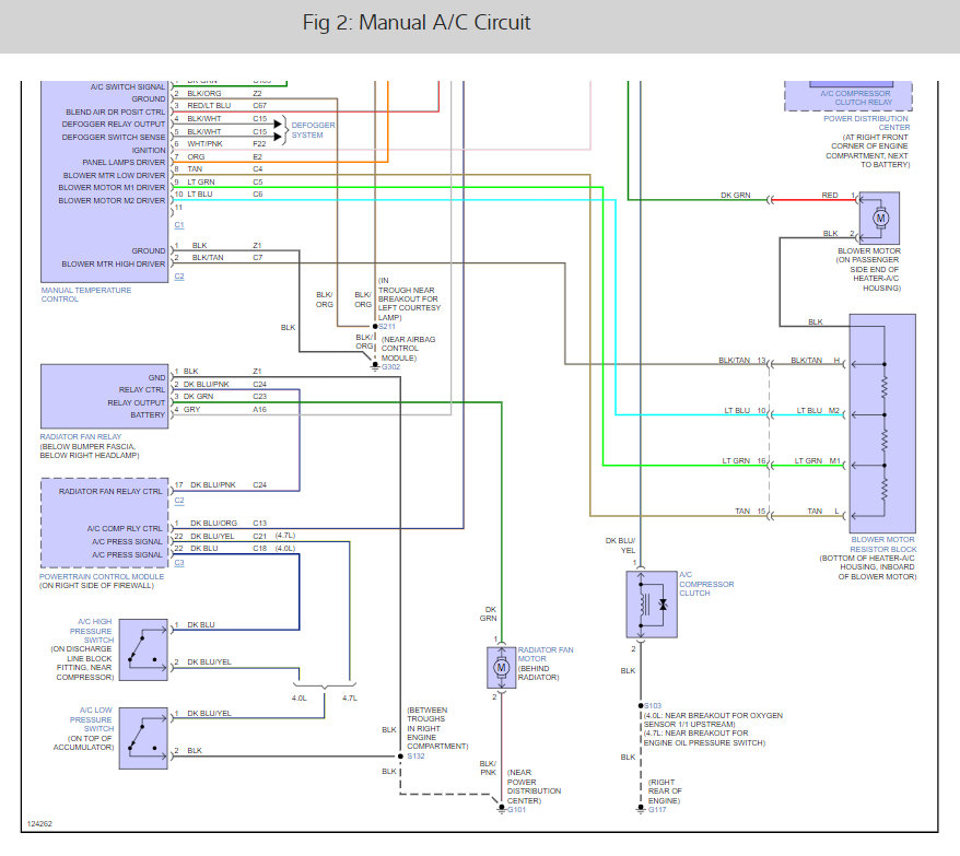

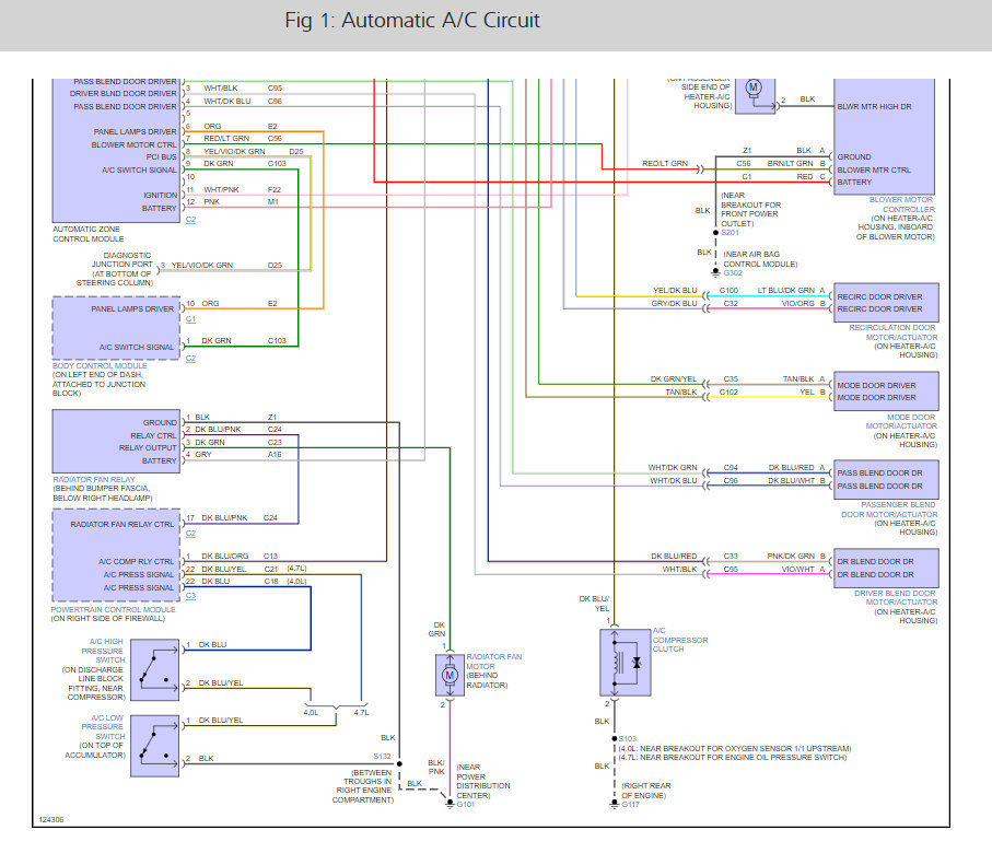

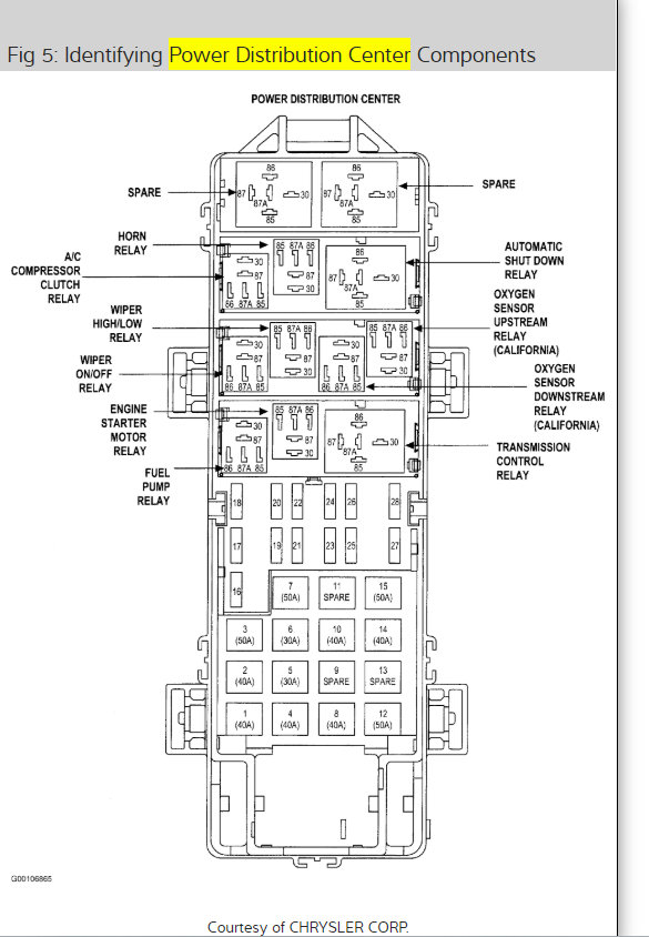

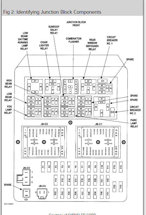

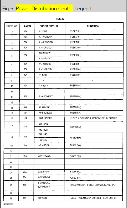

We need to start by checking the fuse # 1, 10 and 21 in the under-hood fuse panel, and fuse # 7, 20 and 21 in the interior fuse panel. here is a guide to help and the fuse locations in the diagrams below. Also, I have included the A/C and HVAC wiring diagrams so you can see how the system works.
