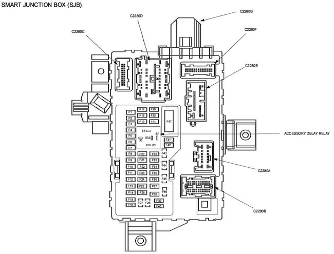

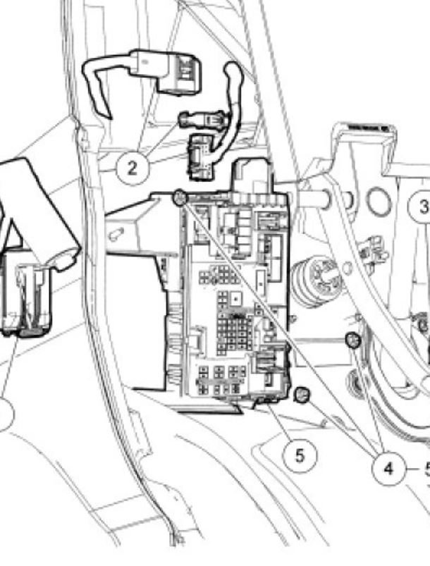

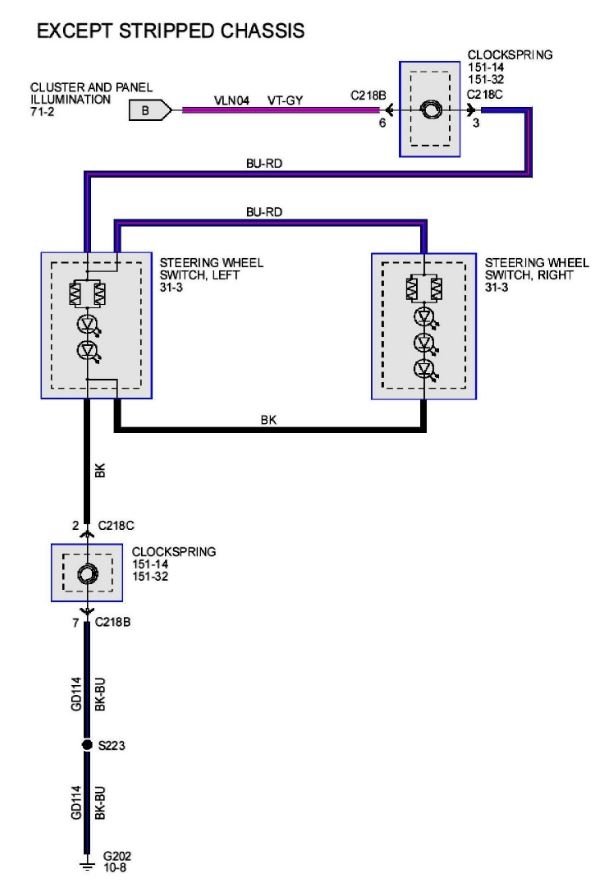

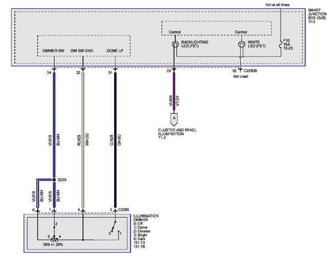

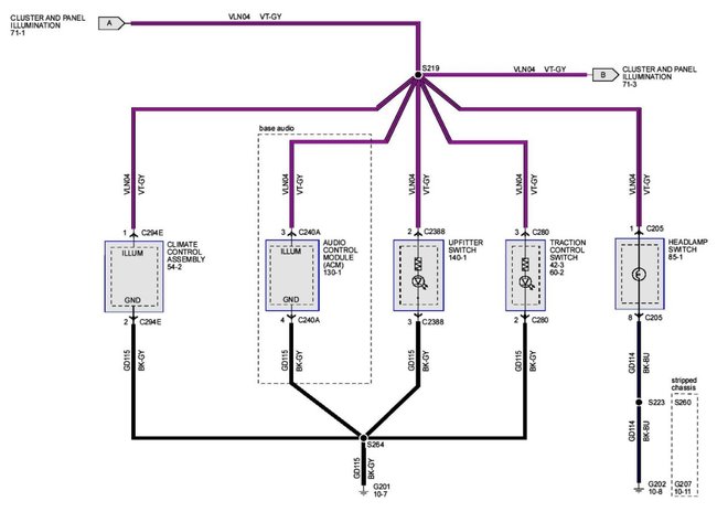

Do you have any steering wheel controls and do those light up? From the wiring it looks like it could be a failed FET backlight driver inside the smart junction box (aka fuse and body control box). It powers the LEDs in all of those locations. That isn't a serviceable part in that replacing it requires replacement of the smart box itself. To do that you need a scan tool that would allow you to transfer the information in the current unit into a file, then once the replacement is installed you upload that, then do a few relearn procedures on the TPMS system and reboot it. The physical replacement is the easy part. Remove the three nuts and 7 wiring connectors after disconnecting the negative battery terminal. Remove the unit, install the replacement and upload the files to make it work. In this instance you cannot use a used part without erasing it's files first and that isn't possible with most scan tools or programming options.
