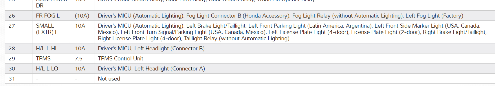

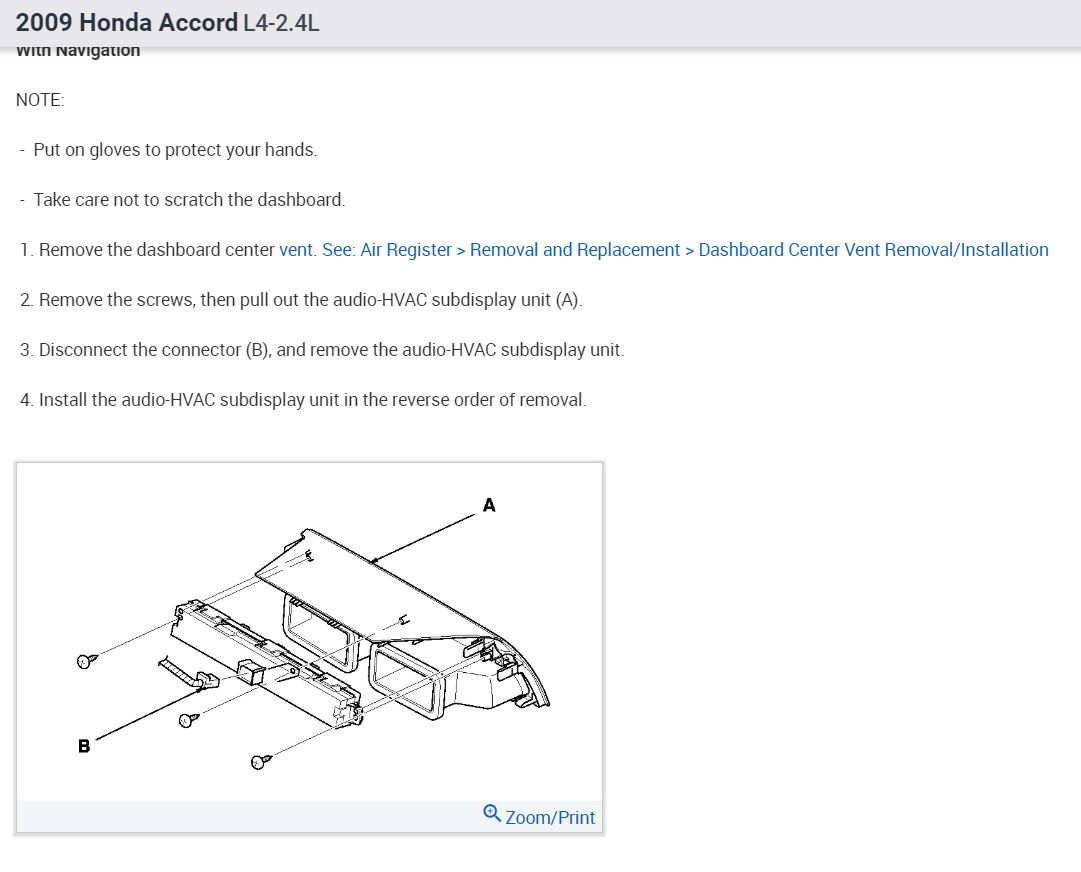

Most of the lights on the climate control are not illuminating.
Jul 18, 2018 at 7:12 AM
  • 55,746 POSTS

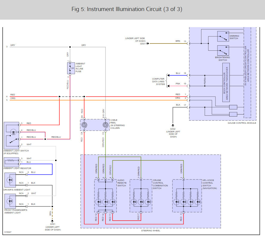

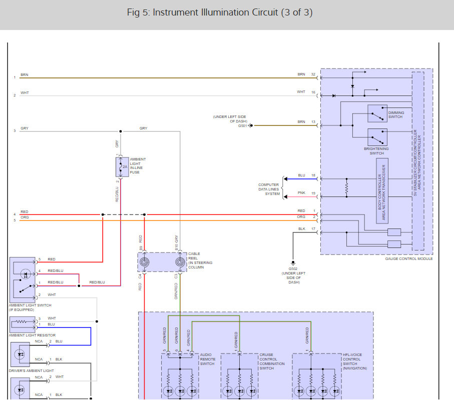

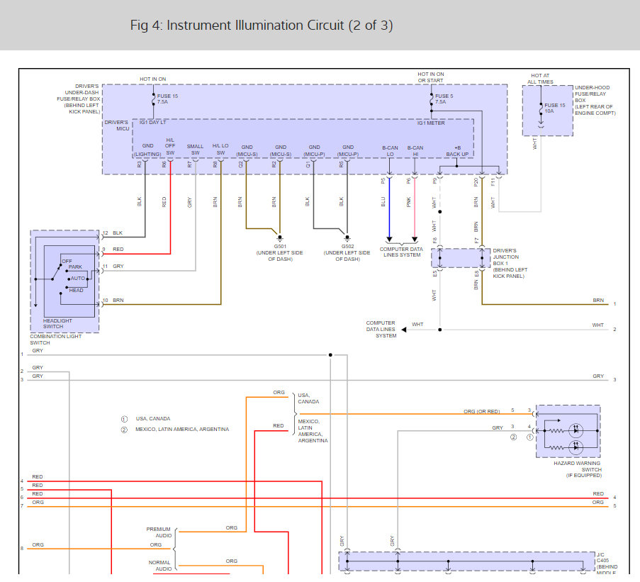

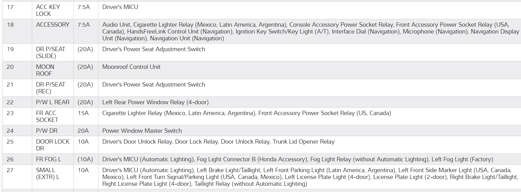

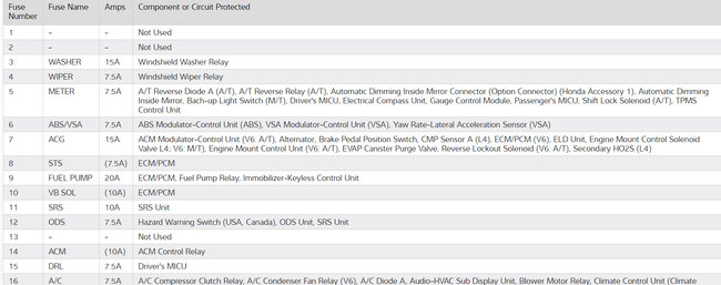

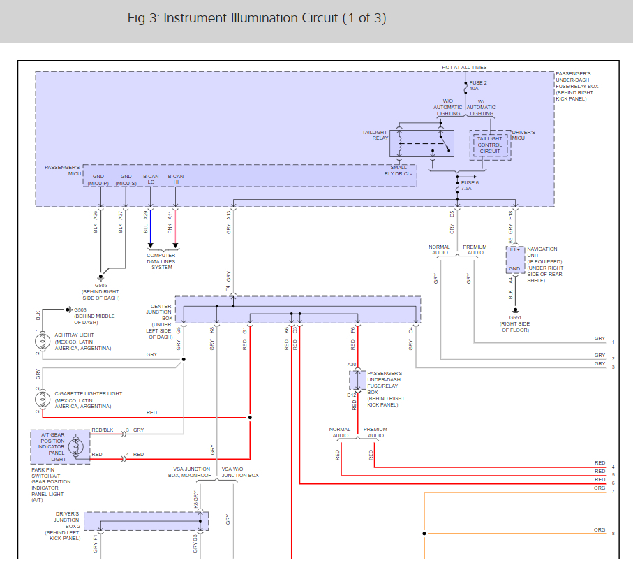

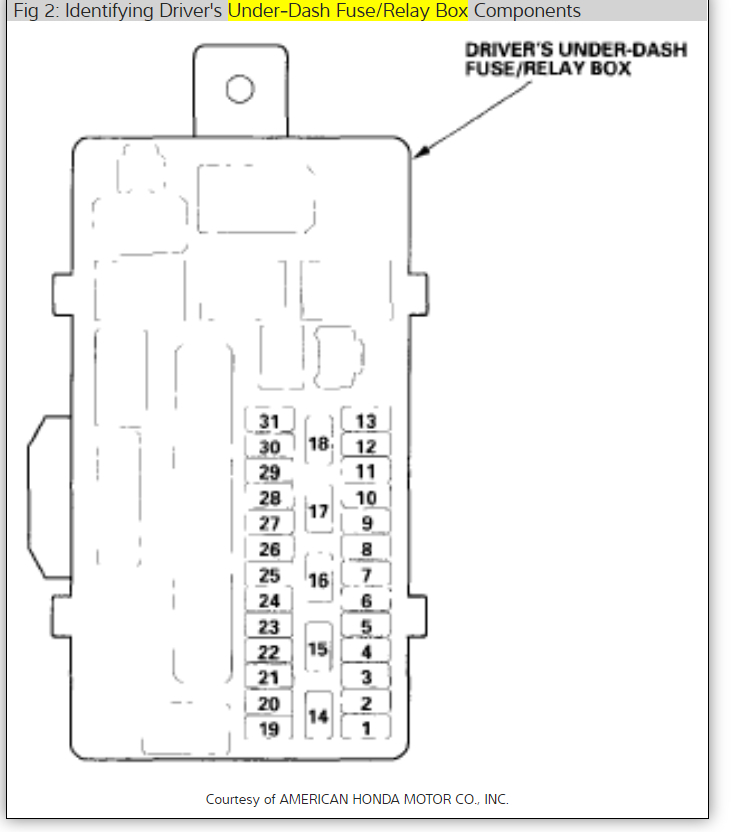

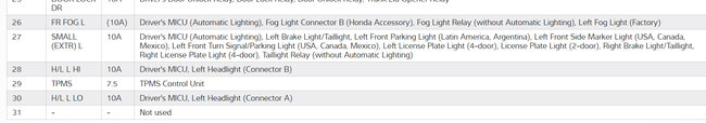

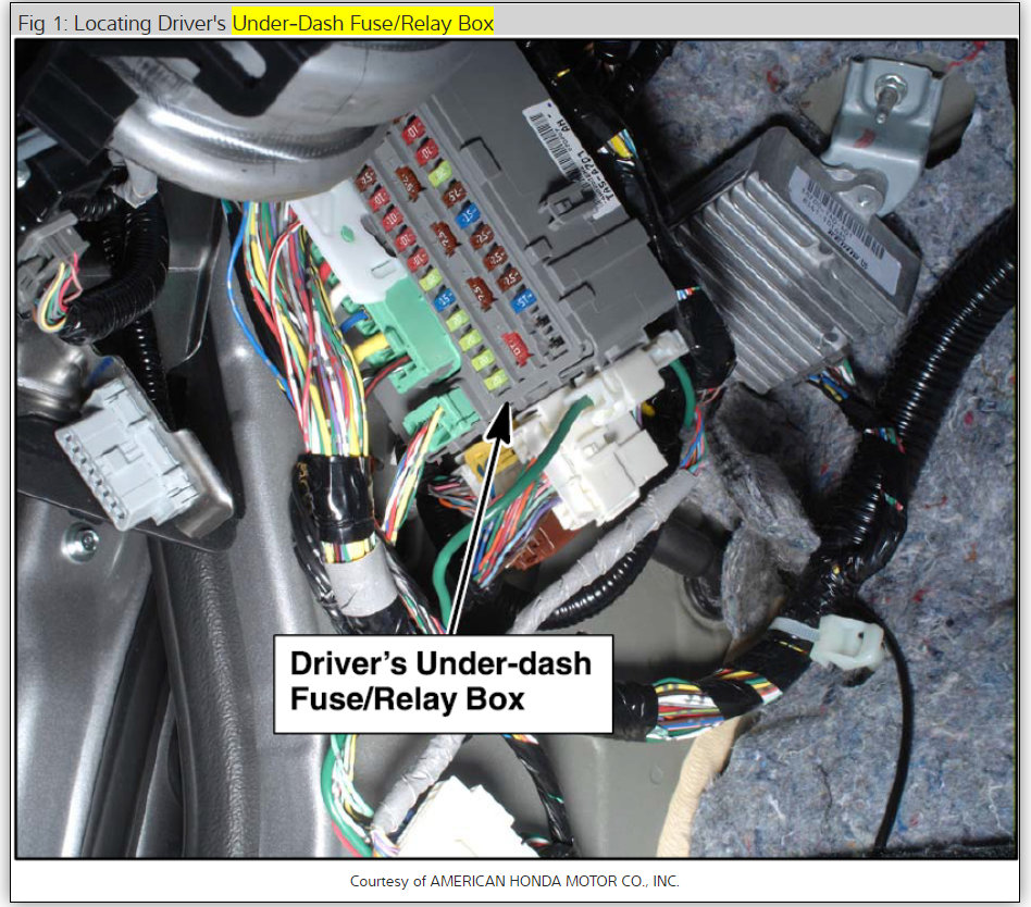

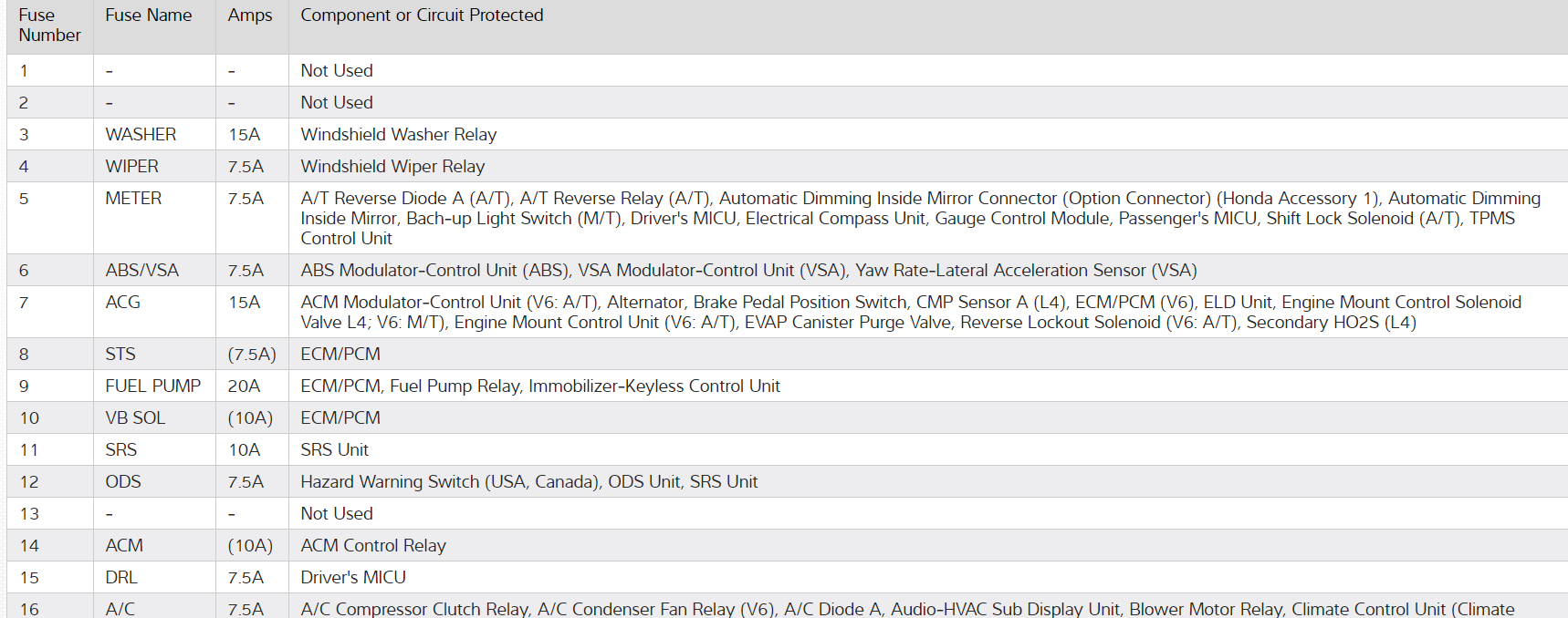

Lets start by checking fuse # 5 and # 15 in the fuse panel. Here is a guide to help you get started:

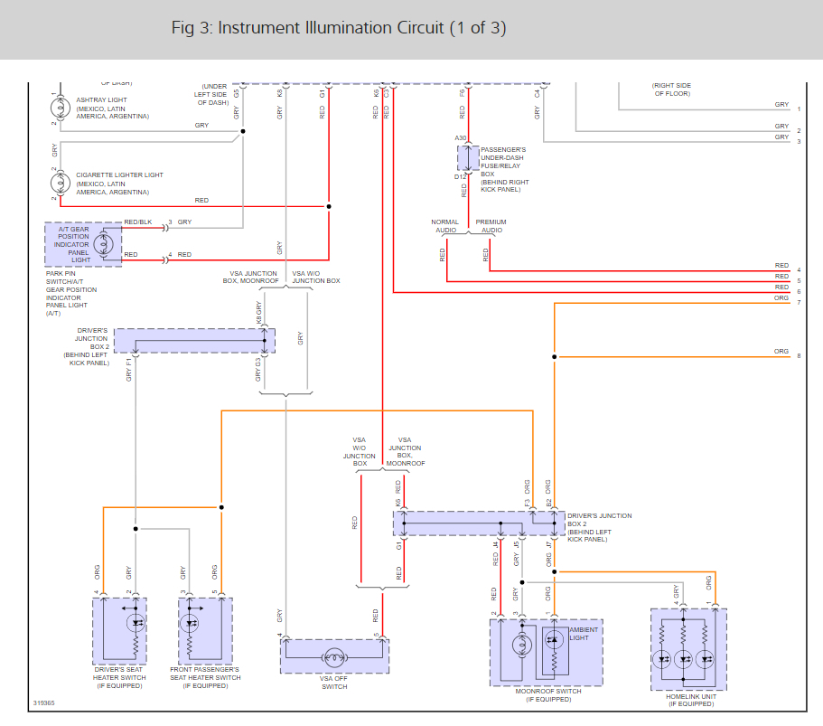

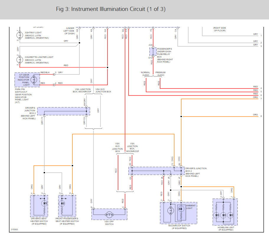

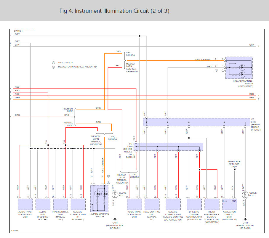

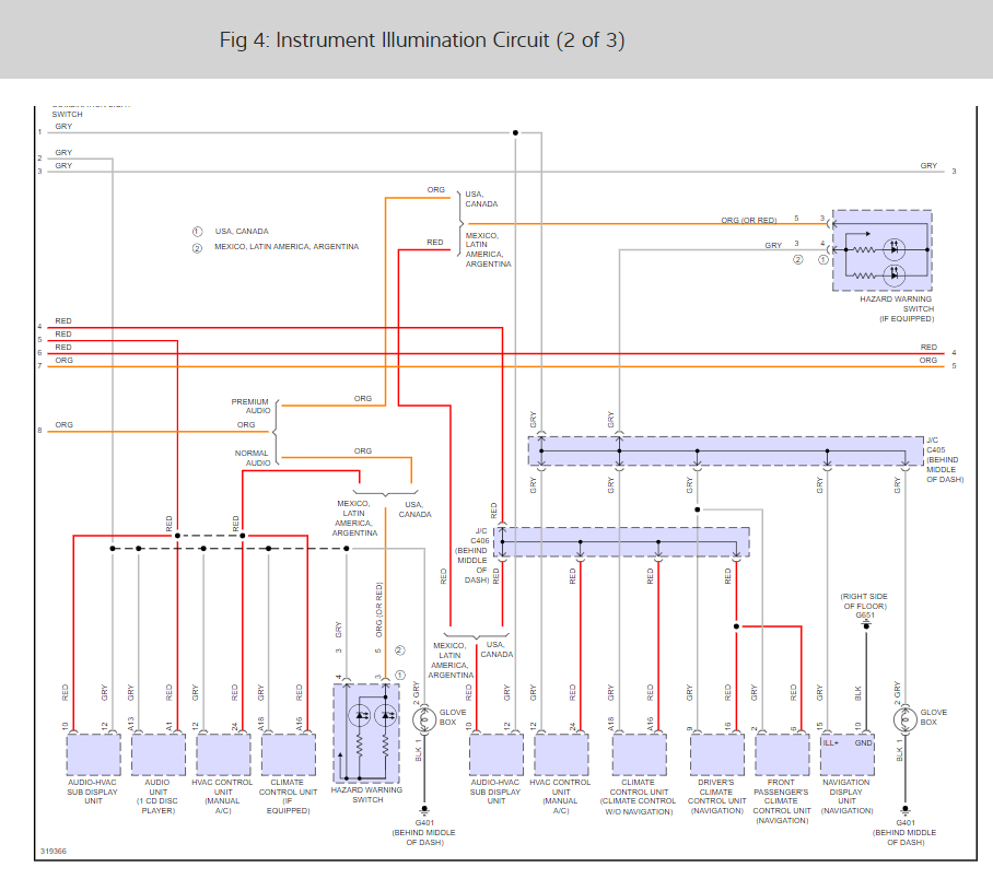

Here are the fuse locations and the wiring diagrams so you can see how the system works.
Check out the diagrams (below). Please run this test and get back to us.
Jul 20, 2018 at 3:56 AM
FERNANDO ARMENDARIZ
Fuses #5 and #15 ohmed out good. What is the next step?
Aug 26, 2018 at 3:18 AM
  • 55,746 POSTS

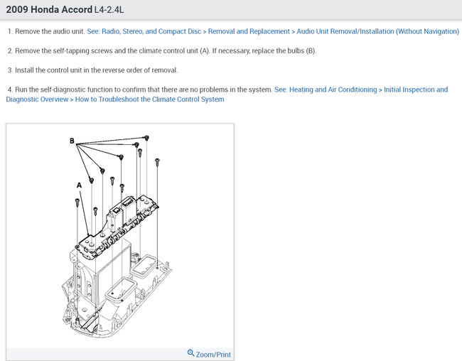

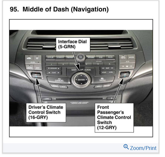

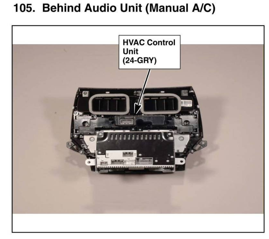

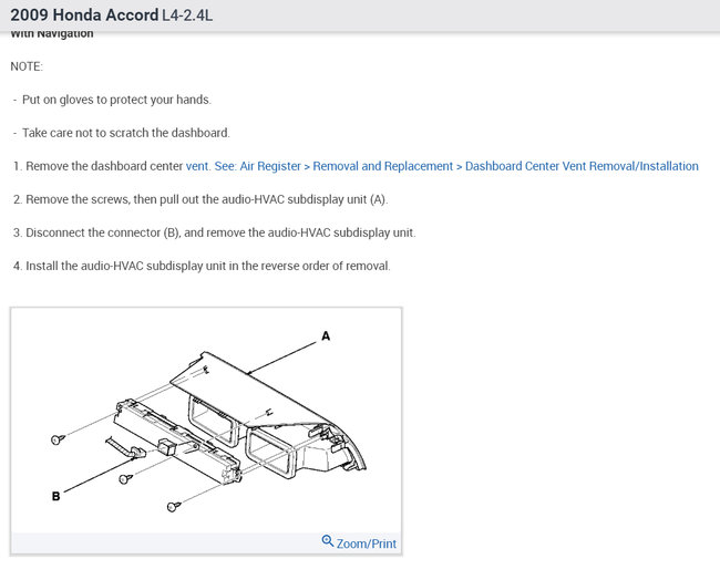

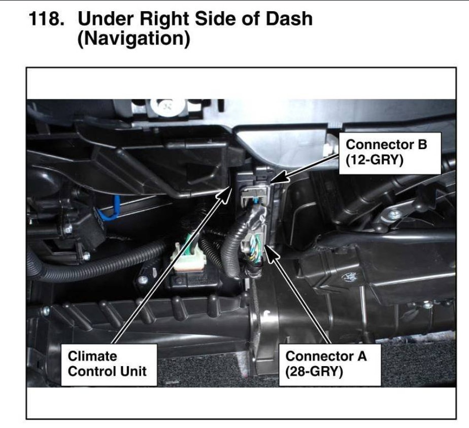

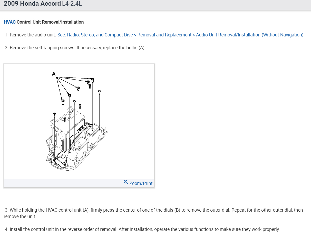

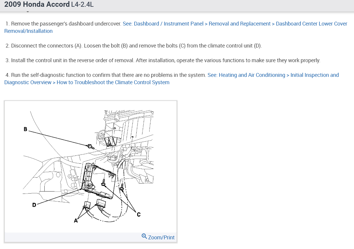

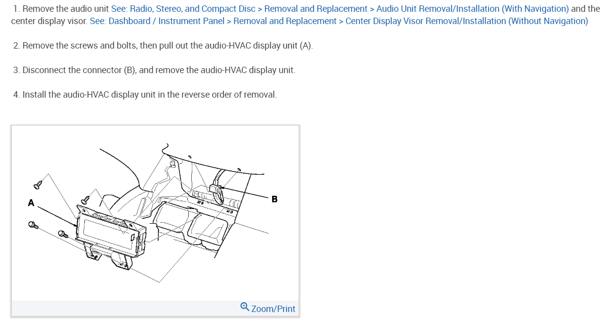

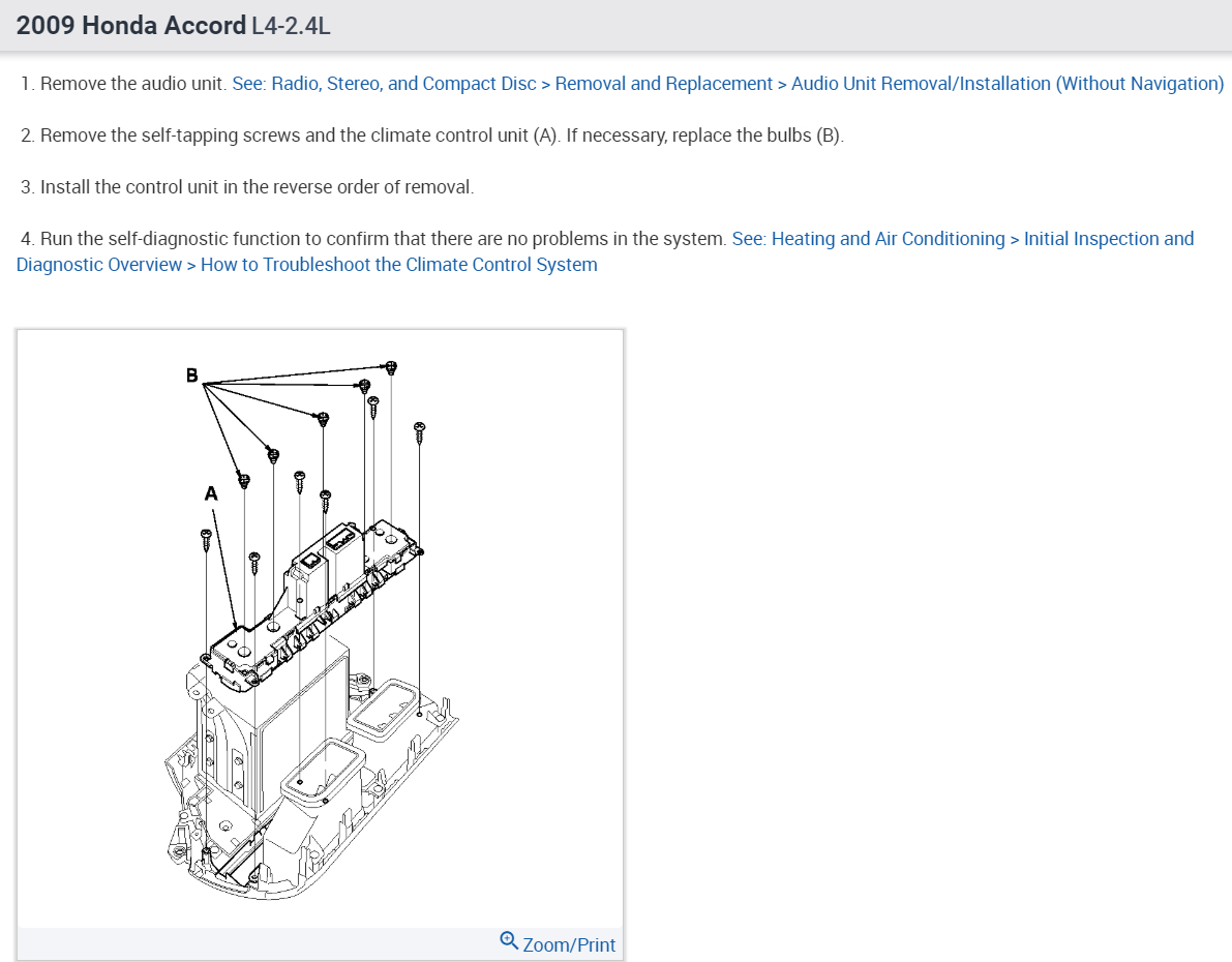

It sounds like you could have a bad connection at the HVAC unit or the unit has bad bulbs. Here is are diagrams to show you how to remove the control unit and where the connectors are so you can check them for corrosion. Check out the diagrams (below). Please let us know what happens.
